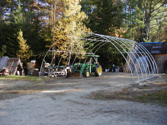

With the Clear-Span brand you will still be installing screws. They call them "Tek Screws". After you assemble the rafters etc. the instructions will have you install a self tapping tek screw into each joint. The kit comes with all necessary screws and a hex head bit for installation.
When you are assembling the rafters you will want a fairly LARGE open FLAT area otherwise your rafters will end up with a twist to them.
   / Coverit All Weather Shelter - Anyone Have one ? #39
My Clear-Span shelter is the "Classic 2 car" it is 26' wide x 24' deep x 12'high. It cannot !!! be assembled in a day like they say. But it can be assembled alone with out additional help. Well except for the help of a FEL.
I have approx a week of assembly into mine, meaning 2 / 3 hours in the evenings and weekend time. Assembling one of these is most definatly a challange, whether it be alone or with help. It is a huge erector set, but like any traditional building, the final outcome will only be as good as it's foundation. Any un-leveliness or rafters out of plumb at the start will carry on and be amplified near the end.
