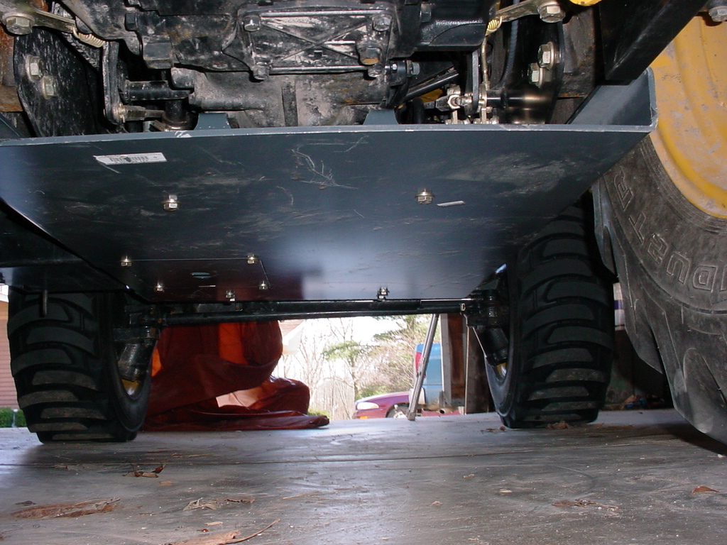

Doc that is a gorgeous skid plate. I would agree that a flat plate between two frame members would aid in racking forces but I will continue to research what design features might be feasible with torque forces.

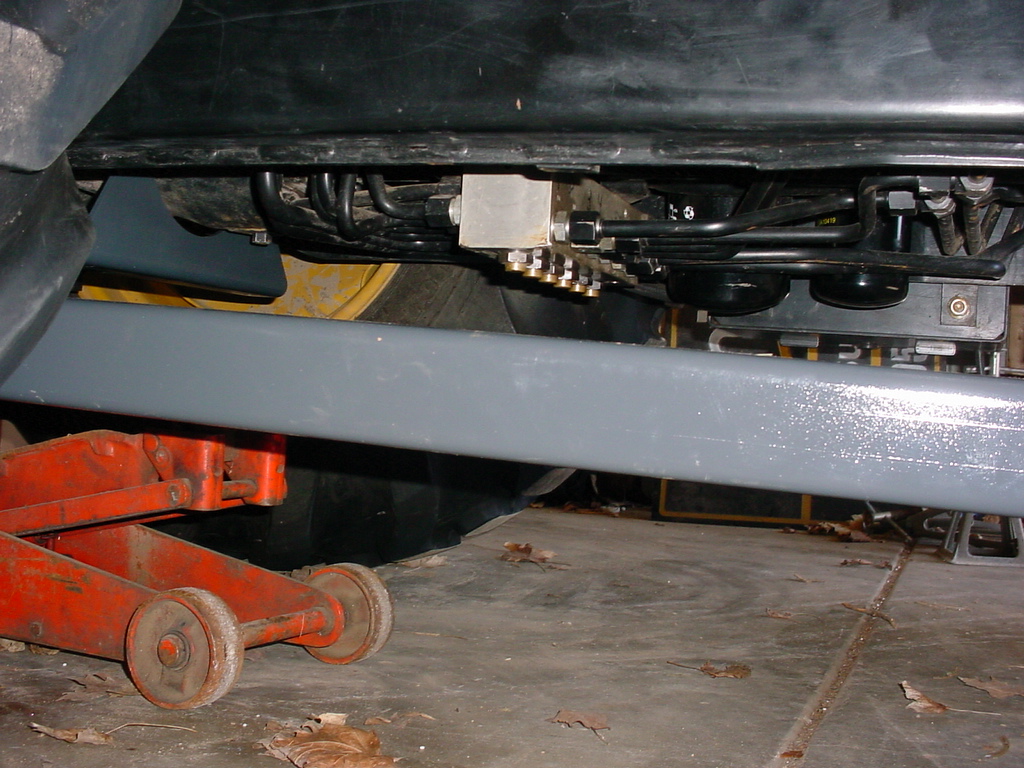

Firefox keeps crashing when I try to add images but It looks like the best one made it through. This is a view of the crack which can be seen underneath that( hyd pump?) access plate on the Rt front side of the tractor. The yellow structure is the R rear loader base and you are seeing on the Rt a filter on the firewall I think. Hope this helps. Hugh

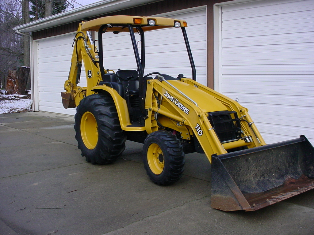

Sure looks clean under there and not much tire wear!
It had about 350 hr. It took me two years to find the right one and it cost me more then I intended to pay for a 110. After I took a look at this one I had to have it.
