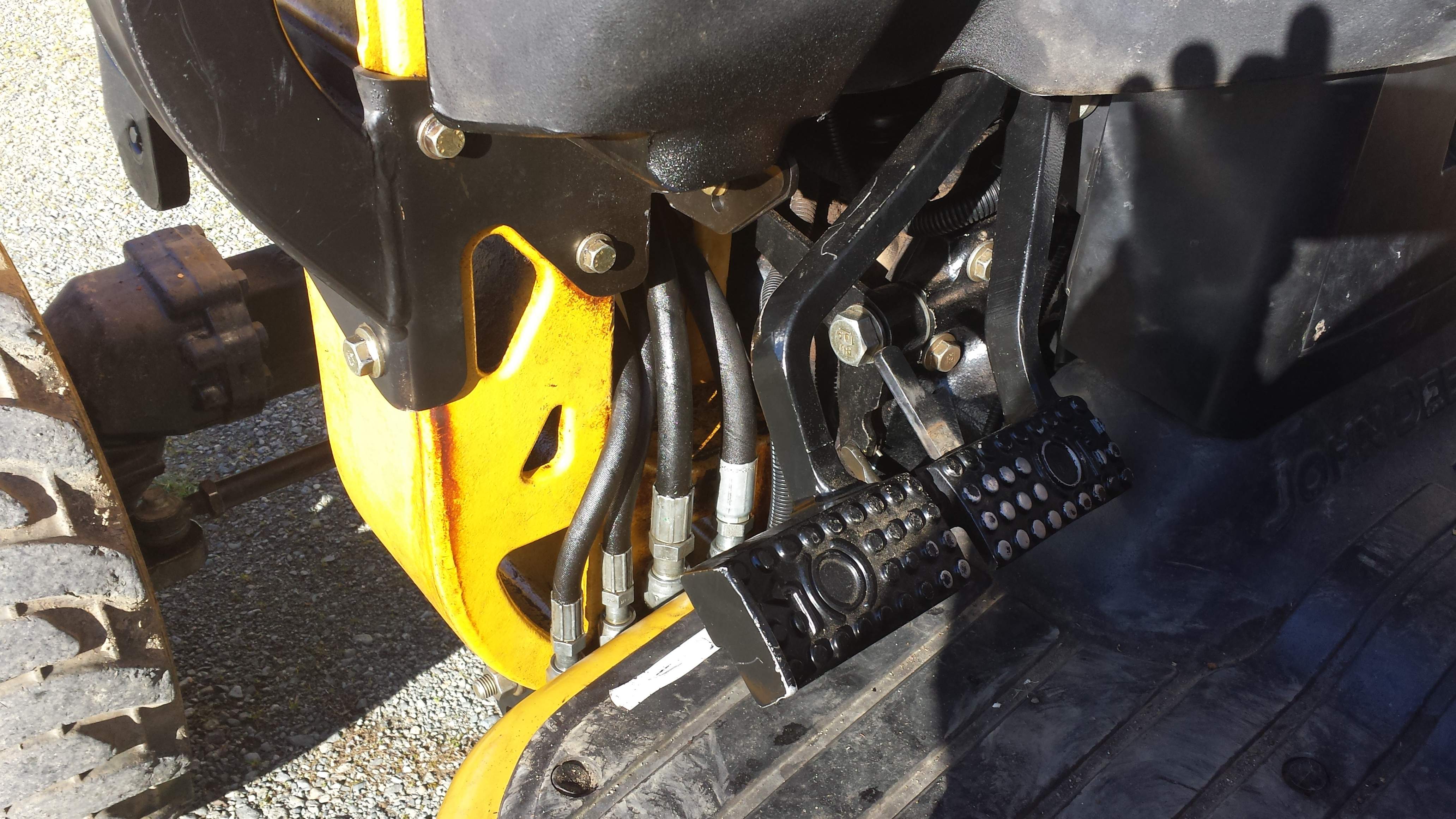

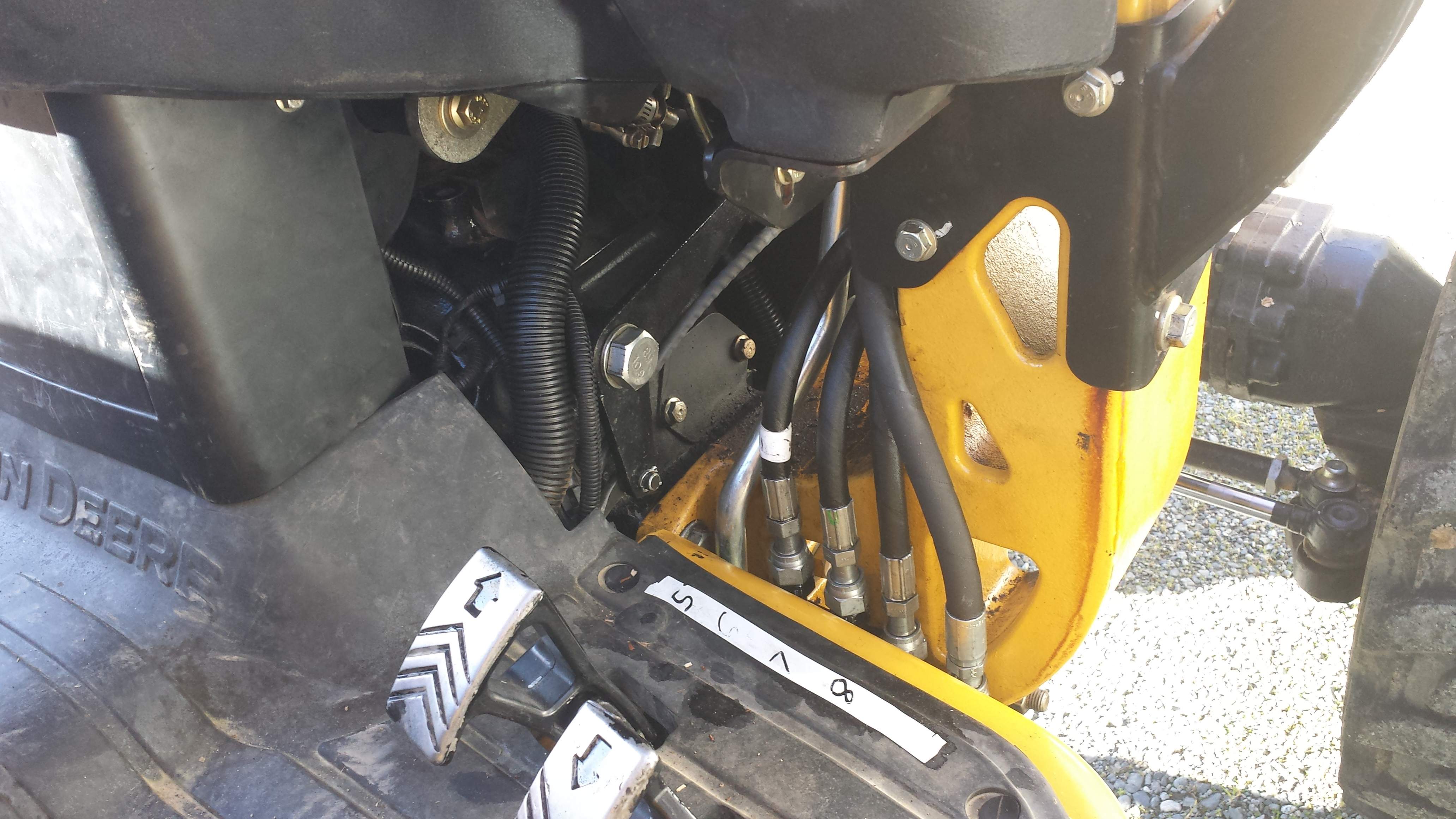

I've persevered the cracked bell housing problem twice now. The first time it happened, the poor Deere little yellow (2006) machine was six months out of warranty. I was simply pulling one of those steel T-shaped fence posts out of the ground at the same time that I didn't realize that the front boom stabilizer bolts had come loose... again (I carried a wrench in the glove box to tighten those rouge bolts every couple of hours or so). The incident cost me $21k in repairs, only to find out later that Deere had previously published a service bulletin acknowledging the propensity for these integral fasteners to head south and cause mega damage. (Thanks for letting me know about this design flaw, Mr. JD Dealer; I'll be sure to add you to my Christmas list... not!!)
Anyway, the same issue reoccurred last fall, this time probably due to me picking up a load in the the 4-in-1 bucket and in the backhoe at the same time (I didn't know I wasn't supposed to do that). It seems that the vertical stress is borne by the two lower rails on the left and right side, and by the drive train itself on the upper side. Whatever the cause, the machine broke in half like the Titanic and menacingly waved another $21k+ repair bill in my face. This time, I didn't bite.
I paid a retired pro welder $15 hun to reconnect the two halves of the (what he said was cast iron) bell housing, instead of shelling out $7k for the OEM version of the transmission bell housing (again). I did the re-and-re myself and plan on adding front-to-back topside reinforcing rails, even if I have to climb over the bloody things to get in the operator's seat!
I have just one question... the markings I made on the front boom hose connections to know where to reconnect them were erased by the hydraulic fluid when draining the lines. Does:anyone: have a reconnection diagram?
   / Cracked bell housing in a 2006 110TLB #28
Nobhill,
I,m not sure which hoses you are referring to.
I can take some photos of the hoses on my 110, if that will help
   / Cracked bell housing in a 2006 110TLB #29
It's the hoses that come from the valve controlled by the joystick that go to the front boom raise/lower, bucket curl up/down and the auxiliary electric valve that controls the 4-in-1 bucket jaws. Pics attached. 20150228_150956.jpg20150228_151012.jpg
