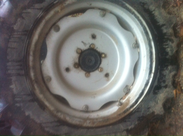

7010 rim.JPG This is the good wheel.I have a 7010 cab/air. My front LEFT rim is cracked between the lugs. Welded it, but cracks come back. Thinking about it, I turn to the right 80-90% of the time making hay. Problem is thay wont sell me the inner part, I have to buy the whole wheel assy. $900. ANY HELP!!!!!!!!!!!!!!!!!!!!!!!!!!!!!!!!!!!!!!!!!!!!

See my post on other thread for detailed welding. You need to v bevel it from one side, weld it up then flip it and v bevel the other side and weld. Use 7018 rods for more crack resistance. You have to completely remove the crack and replace with full penetration weld to keep the crack from coming back. V bevel each side more than 50% so you end up removing all the original metal and replace it all with weld metal. IF the crack is from bolt hole to bolt hole, weld from the ends to the middle so your stops are in the middle and all your starts are at the bolt holes. Use a carbide burring tool or dremel tool with abrasive cone to remove the excess metal from the bolt holes when finished.

I concur Dr. I would also like to stress clean, clean, clean. Just like new metal. I would also heat the metal and let it anneal back then weld. While heating you can look for other problem areas. Weapon of choice specifically 3/32 7018 at lower amps. Take your time, don't over weld. Good luck.

Yes! Then peen the welds with a needle scaler. On reassembly use high strength washers under the bolt heads or nuts to spread the clamp force to a wider area of metal.

I used my 7010 in the building of my poultry houses and broke 3 or 4 rims like that. My dealer warrantied them all, but by the time I was done he too had broken both front rims on his. We built plates that weld to the rim and haven't had a problem since. I'd be glad to make you a set and send them to you. I can't remember what it cost, but it was much much less than the inner of a wheel. I'll try to post a pic tomorrow.

Sounds like the rims were a little light duty on that model. Building reinforcing rings will fix the problem forever as you have mentioned. You'll see them welded into the rims of rental tractors sometimes. If done right they look good and work well. I sure wouldn't buy new wheel centers.
