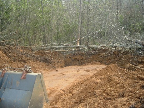

The holidays and cold weather slowed me down some, but the last couple of weeks it's been in the mid 70's everyday, so there's no excuse not to move some dirt.
This picture is along my shorline about where I started this way back when. When was that anyway? /forums/images/graemlins/confused.gif
I cut the slots to build up the shorline and get the water depth as quick as possilble. Rumor has it that this will cut down on shorline weeds and alge. We'll see. /forums/images/graemlins/grin.gif

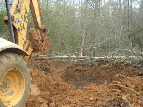

This picture shows the layers of clay on the wall of one of the slots I dig clearing dirt.
The top layer is red clay, and it's the softest material and easiest material to dig. The next layer is several feet deep and is kind of a yellow clay with some sand mixed in to it. It's much harder than the red clay, but it still breaks up with some care not to cut too much at a time. The bottom layer is kind of hidden from the side walls crumbleing from the blade, but you can see the color on the bottom of the trench. It's the most miserable, dificult material I've come across. It's a dark gray to mid brown to dark brown. I've gone several feet through it in places and it all the same. It is super hard, dificult to cut and it has sectons that are just short of being rock. They will catch the blade and stop me dead in my tracks. It's a real battle cutting through it trying to get a full blade.

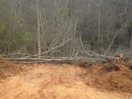

Everythink kind of blurs together, but you can get an idea of how the shorline is looking here. The dozer is parked on the shorline road that I'm building up with the spoils from the hole I'm digging.

Eddie, your moisture level in the clay looks very low, but that may be deceiving. Are you able to compact any of the spoils, or is it mostly just loose clay/sand by the time you get it spread? On my pond, I'm going to try to cut the grade on the perimeter road to make water flow away from the edge of the pond to reduce resilting. I know you and I both are going to have a tough time watching what happens the first time we get a heavy rain.

The amazing quality of the clay is how much moisture it holds. We're 25 inchels below normal for rain, but the clay is still holding water.
There's two place in the picture of the slots that are so wet I loose traction. One of them is just scary. The ground is like a water bed. When I stand on it, it just moves like jello. That will be a shallow area, or maybe I'll dig it deaper with the backhoe when the rest of the lake is done.
The other spot is 5o to 60 feet to the right and it's just super slick. I hit it and my tracks spin. The only way to get the dirt form there was to push onto it, they come at it sideways and push it away. Very time consuming.
As for water content. When I spread the spoils with the dozer, it will compact after a few passes to the point I'm cutting it again. There's a lot of places that the dirt has that shiney finish after being cut.
One of the reasons for the shorline road is to create a barrier for the run off when it rains again. After all the dry weather, the ground is nothing but silt just waiting to end up in the bottom of my lake.

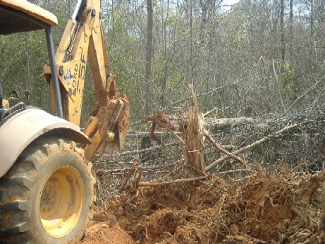

Here's a few more pictures of the progress on my lake.
The small mound in the middle of the picture is a submerged island. To control my lily's, I'm only going to plant them on these submerged islands that will be about 4 feet deep. The drop off is another three feet and should be deep enough to stop them from spreading from this area.
They are also great for fishing. I have some stumps piled around the sides and will add some more debri to the top plust the water lily's to profide cover for the forage fish. The steep drop off is also a favorite for game fish.
This should be a great spot to fish at.
