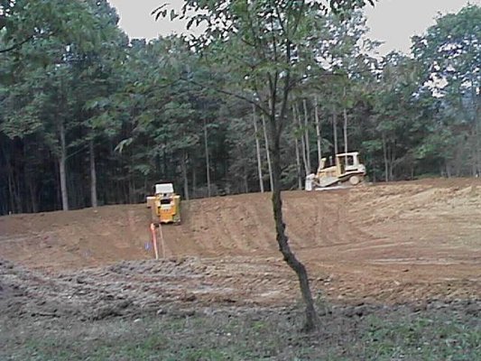

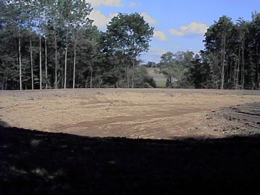

Here's the lake site all cleared and ready for dirt work. The burn pile is getting smaller, but it's happening very slowly.
Eddie
