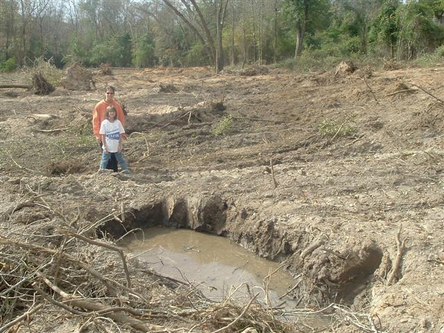

The dozer is up and running. I put 15 hours on the engine doing fairly easy stuff like scraping the roads. It's running really strong and smooth. Hard to describe the smooth part, but it's definiately there.
The power is up too. It spun the tracks before, but now the engine doesn't lug when that happens, it just sort of keeps powering through what I'm pushing or moving!!!
The picture is of the lake site after sitting undesterbed.
Eddie

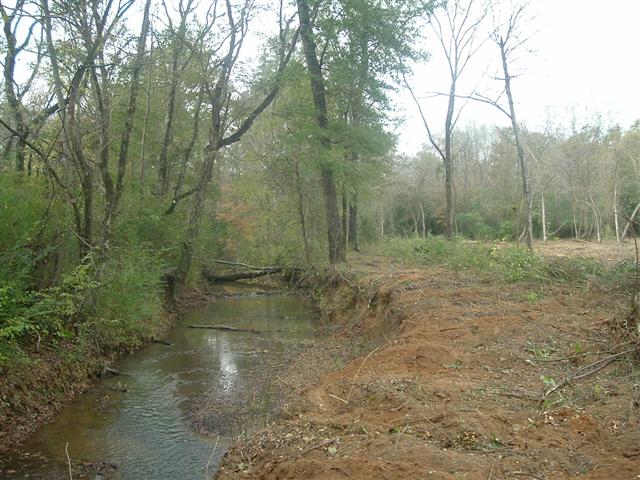

The vegitation has to be scraped off before the dirt for the dam can be dug. I don't want anything that can decompose in my dam.
I'm also burning again and trying to do multiple tasks at the same time!!
Eddie

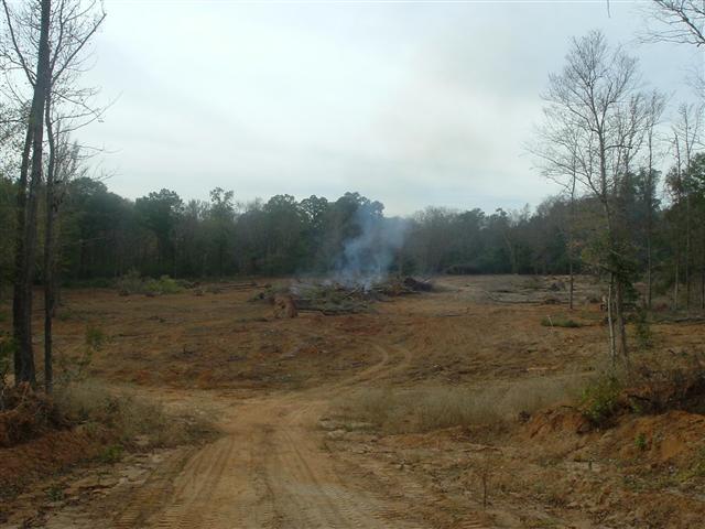

The burn pile is way too big and has allot of dirt in it from pushing 7 acres worth of trees into it with the dozer. It's something that builds up just a small amount with each tree. You push in thousands of trees, and you get allot of dirt.
I can get the fire to burn real nice, but then it goes out from the dirt piles underneath. Then I have to move it around and start another fire.
If I knew what I was doing, this shouldn't happen, but my Dad and I are more eager than expert. /forums/images/graemlins/grin.gif /forums/images/graemlins/blush.gif /forums/images/graemlins/laugh.gif
Eddie
