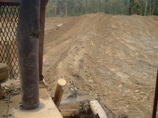

The log drag works really well for smoothing out the tracks from the dozer along with some of rough spots. The yellow case on the front bumper is my lazer level.

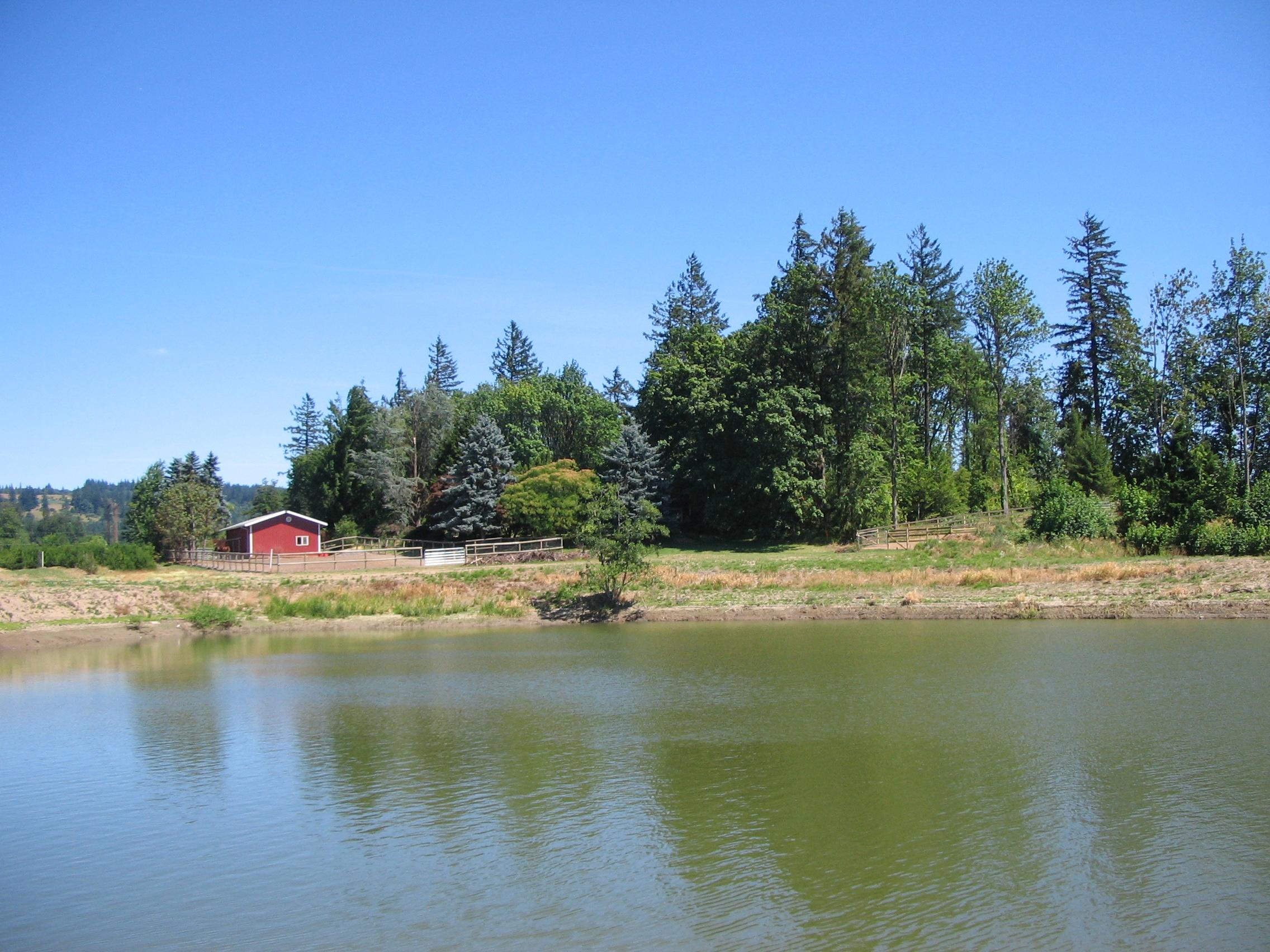

Just to get ya going, here is a shot of my project, er home, taken from across the pond. Can't really see much cause of all the little trees, except for the horse barn and paddocks (which is all I ever see!). The pond is about 30+ deep. It was enlarged about 20 years ago, right when I moved in. Water is a bit low in the photo because of irregation use. A 300gal/min pump can drain water pretty fast :)

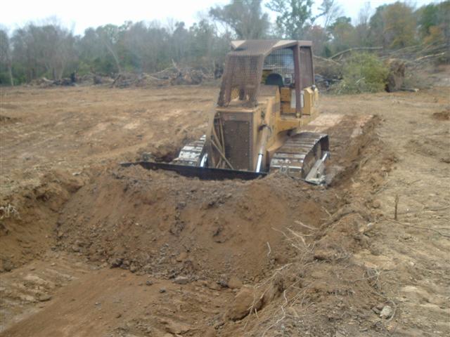

Before I started on the dam, or levy, or what ever it's called, I did some rough measurements. Basicaly measured out large squares in the area that will be covered in water. I added up the square footage and devided by an acre and came out at 5.13 acres.
Now that the dam is done I want to do some more measurements, but it's not a priority. It seems bigger to me now, but I know I can be off by half an acre and not see it.
Overall, the area has had good clay. My idea of good clay is how much moisture it holds and how well it binds to itself. I scrap off the topsoil and dry stuff until I get down to the moist stuff. This is wat I use for my layers as I build up the dam.
I started my calculations at the tree in this picture at the right. It's base is where my waterline is at when full. the dam height was based on this starting point. I don't really know why, but I've ended the dam here instead of starting here. hmmm???
Anyway, when I got to this area I hit a pocket of sand. It was four feet deep and goes out the side of the lake into the trees.
I pushed all the sand away until I hit clay, then dug down another foot to be sure it's all clay. It is.
Then I dug out the walls of the lake several more feet than I had planned on.
My spillway is in this area also. I dug it out several feet too.
Eddie

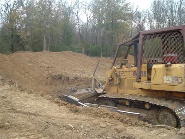

#376
This turned into a several day project. Getting the sand out of the way seemed to be never ending!! Then the clay I wanted to use was a little far off.
I used a massive amount of material here to make sure it wont leak. The walls are over four feet thick and the area above the waterline goes back about 14 to sixteen feet. My blade is 12 fooet wide, and it's several feet wider than that.
The spillway area is of great concern. It will be concreted in and a foot bridge will go across the top, but until then, it will remain as is. To cut down on erossion, I spread clay over the sand 25 to 30 feet back and 4 feet thick to about a foot thick where it ends. I also built up the dam extra thick here with clay to be sure to minimize erosion.
I'm planting bermuda grass here too.
The spillway is here because of the very slight slope. Just a few degrees as it leaves the lake. I like this because the water wont be rushing out of the lake, but just sort of flow. Or at least that's what I'm telling myself.
