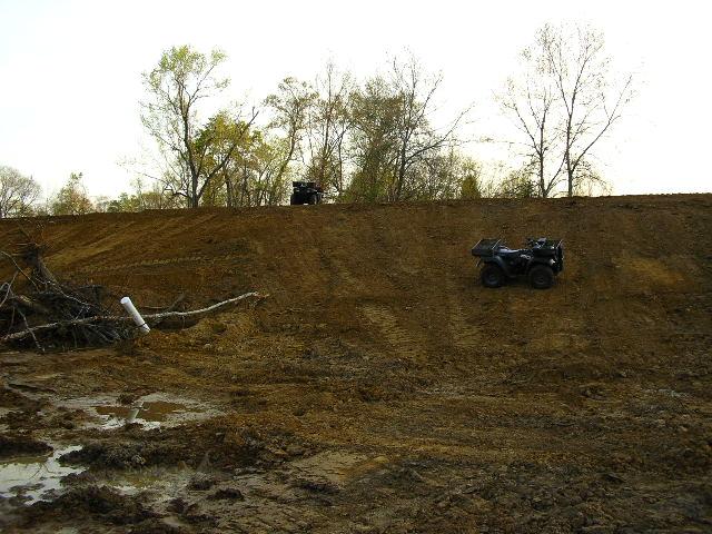

THANK YOU guys for your support and encouragement. Since klm and hillbillyfarmer haven't replied, I'll just have to assume they were having a bad day and chose my dam as the source of there frustration.
One of the main reasons I'm here is to learn how to do things right and better than I know how. I truly want people to offer critism or ask questions on things they think I'm doing wrong. I'm just an amature here working on my land and most of what I do is learned from what I've read or I'm told. It sure doesn't mean I know what I'm doing!!!!!
I'm very concerned that my dam might fail. It's always a possibility, so if I've done soemthing wrong, or can do something more, than please let me know. Just telling me I'm an idiot and not explaining why isn't very benificial or very helpful at fixing my mistakes.
I took another picture of the spillway today. It's still hard to tell what's going on by the picture because the dirt all sort of blends it together. The light colored areas are bermuda grass that has gone dormant on me. There is still grass that is sprouting and comeing up, but that's just baby grass. The mature, established stuff is all brown.
As you can see in the picture, the land is almost totaly flat. If I get any erosion, it will be very miniman and easy to repair. At no time will the dam be affected by water running through the spillway. When it does overflow, I'll be sure to update it with more pictures as I'm dying to see how it all works out.
The water is still rising, but slowly. The plants on the island are all in water now and there's only a few islands still above the water.
The last picture shows the overall view of the lake as of today.
