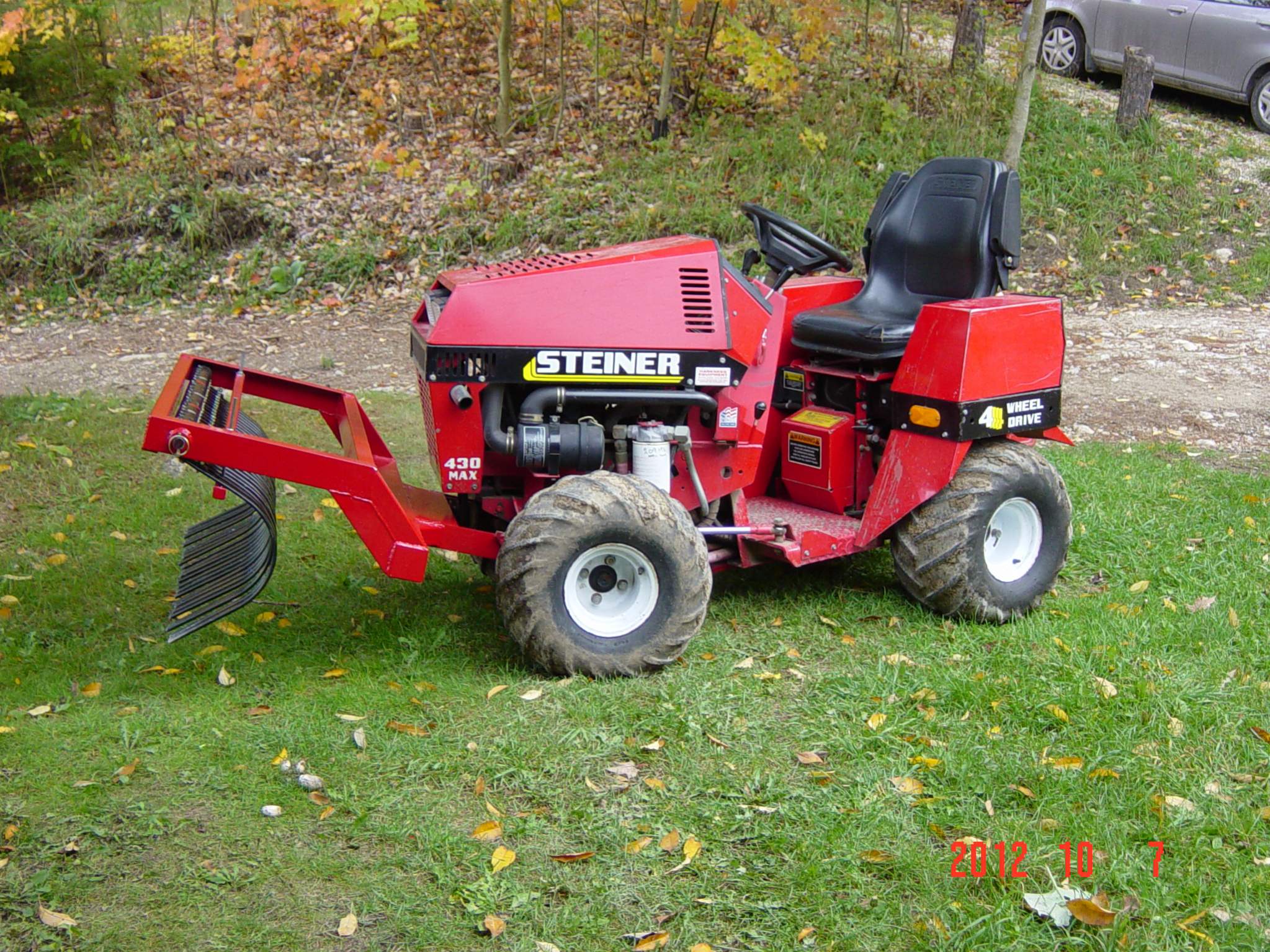

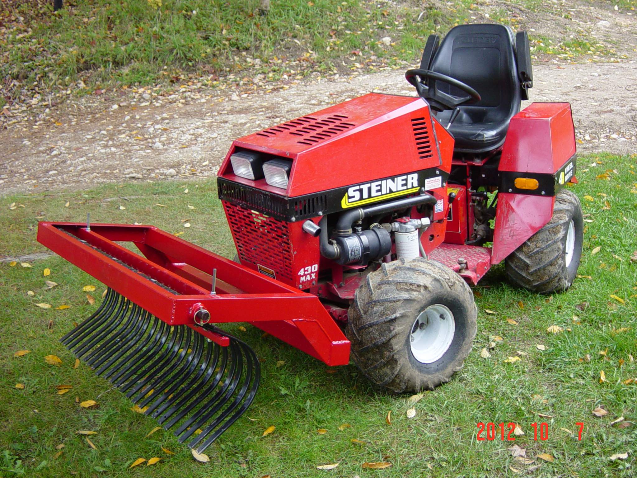

I finally got around to building my rake, for the front of my Steiner. I saw no need to make it angle especially given the articulated nature of the machine. I really just wanted it to rake up branches and debris, from felling huge dead trees.
I thank the information I got here for getting tines at ASC.
I did have a brainstorm though. Rather then getting a laser burned angle to mount my tines on, I opted to mount each tine on a bushing, mounted on a one inch shaft. This way each tine follows the contour of the ground, which is NEVER level. I can raise a bar with a couple of nuts to arrest the tines or make less travel, should I wish to level some dirt or something like that, so that I have the best of both worlds.
I didn't listen when told that the shaft would bend, and sure enough with only moderate engagement, there was a substantial amount of deflection. I have inserted a couple of bushings that will be mounted to the frame for intermediate support.
There are twenty four one inch tines with one inch spacers.
So far, this project appears quite promising for the intended purpose.

I would love to see some video of this in action as it really looks like the tines would pivot back and lose the debris. Not doubting your build, which is fantastic, I am having a hard time seeing it in action.

I really want to build a fel rake now with wheels out front. If it could flip around backward it would be the berries

As for my rake. I still have not finished the supports for the shaft. I will see about trials and possible video as time permits.

Can I ask, where did you source the tines from, and how much were they?
