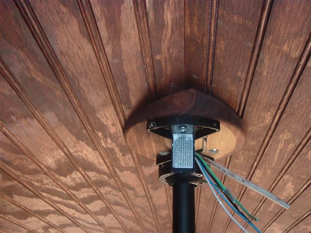

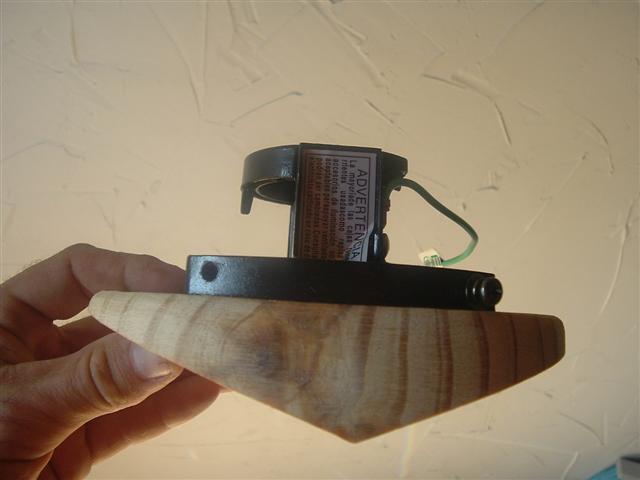

One interesting project turned out to be installing the ceiling fan. The vaulted ceiling is has a 4:12 pitch with the light going in the center of the peak.
I cut a piece of 2x8 from my scrap pile to the pitch, then cut it to fit the mounting bracket.

I stained it to match the ceiling and attached it.

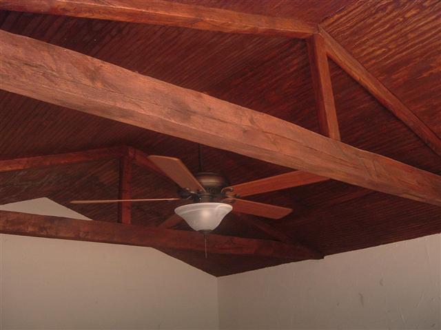

Sorry, I've had some signal issues with my satellite internet connection and wasn't able to upload the last picture of that ceiling fan.

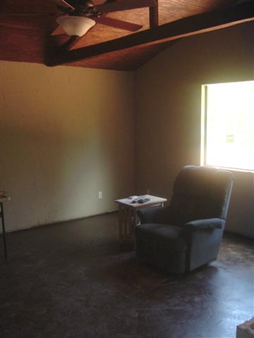

Another experiement was to stain the floors in the family room, hall and kitchen. My thinking is to keep it smooth to keep clean-up simple. Stain is the cheapest method I've come across. Three gallons at $26 each at Lowes for the Quickrete brand plus two gallons of degreaser/etcher for another $25 each.
The hardest part was cleaning the concrete before puting on the degreaser/etcher. Steph and I were on our hands and knees for hours. Not very much fun.
