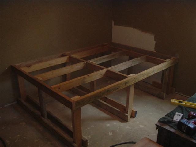

Next project to get done before carpet gets here and Steph moves in is the master bed. With a small room and a queen sized matress, we decided to put the bed in the corner. I'll crawl over, while she gets the edge.
She gave me a few pictures of beds she likes and some height requirements. She likes a tall bed. I also wanted to mazimize storage underneath.
Here's the framing.

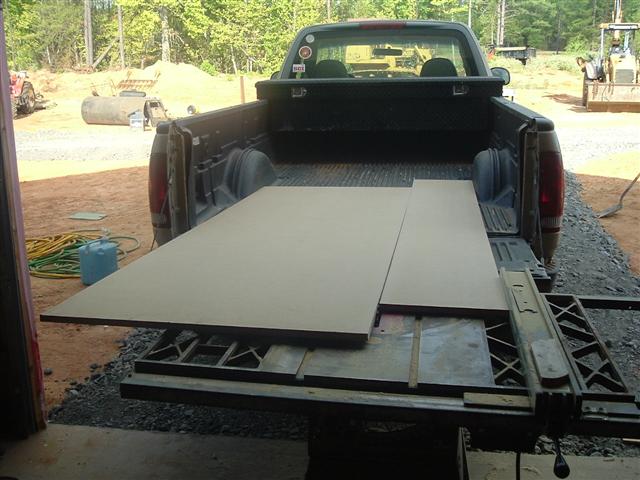

I used MDF for it's paintable finish. I love to work with it, but only after that first cut when it gets down to a managable weight.
All my tables are either being used or buried under other things. I got this idea to use my truck bed to support the material as it comes off my table saw.

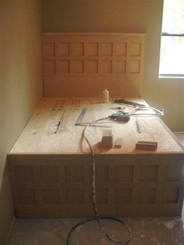

Here's the bed before paint.

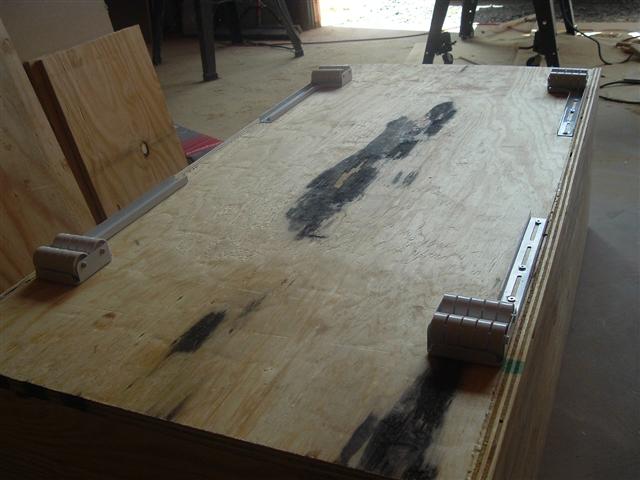

For mazimum storage I was going to build some drawers under the bed. The largest drawer glides I could find were just too small for what I wanted. Then in the shower it hit me, don't build drawers, build a wagon that will roll under the bed instead!!!
I was looking at different sets of dolly wheels when I noticed these. They are appliance rollers rated at 1,200 pounds and only 1 1 /2 inches tall.
I also used 3/4 plywood for the box due to the heavy loads I expect to put in them.
