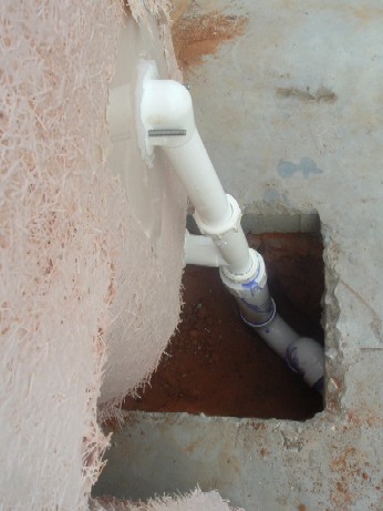

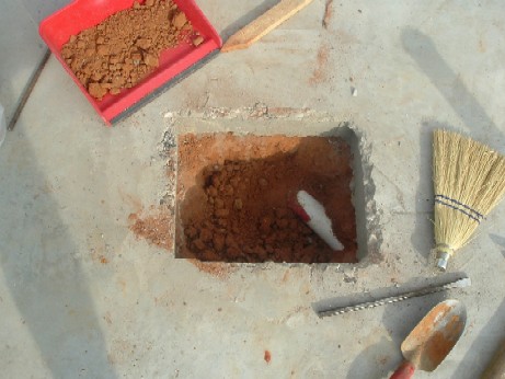

I'm not a plumber, but I pretend to be one on occasion. Real plumbers have trouble laying out bathtub drains often enough that they carry concrete cutting tools to make the adjustments required.
Tubs give me a special headache trying to rough in the plumbing. I put in a 12 inch box where I thought it should go and left the pipe a little long.
After the pour, I took out the box and cleaned out the hole.

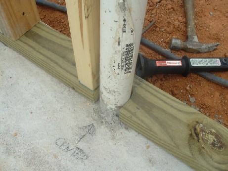

#62
I got lucky and didn't have to bust out any concrete. The pipe was about 4 inches long, which is easy enough to fix when dealing with Sch 40 PVC. I lined up the trap and connected the drain lines to the tub.
This is one of those proud moments for me. hahaha

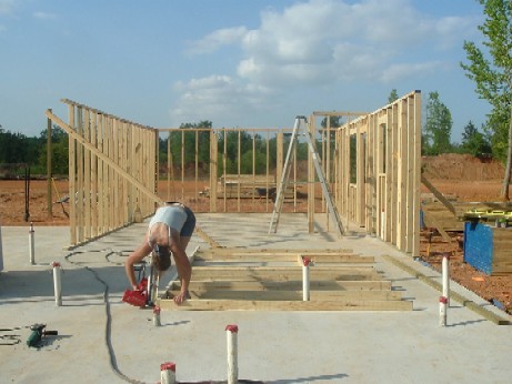

#64
My girlfriend is one of those rare women that just loves getting involved in my projects. She jumps right in there and works as hard as anybody.
She's never used a nail gun before, nor has she ever framed a wall. It's all pretty basic after layout and marking.
Here she is putting together the bedroom wall.

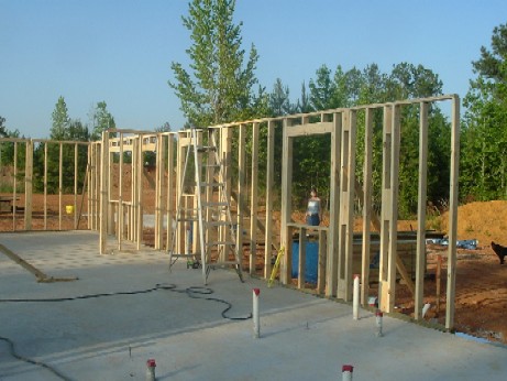

#66
I got a little more done today. The heat is a killer, it slows me down and makes everthing a little tougher.
This is the home part. The first window will be my family room, then the kitchen and my bedroom.

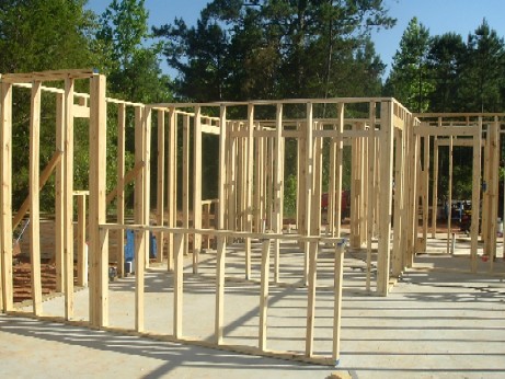

#68
This is the view from the family room looking into the kitchen. To keep things open, I'm building a U shaped kitchen with the open breakfast bar.

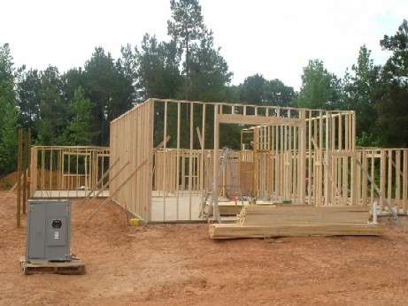

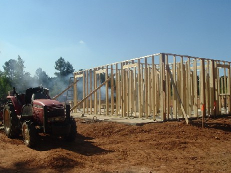

I'm still putting sticks together.
Here's the workshop side of things. The header weighed a ton, but with a little help from my Dad, it went in smooth enough.
The grey box is my transocket for my commercial meter. I'll have it set up for 1,200 amps. I had to order the breakers and disconnect. It cost over $2,000 and will take four weeks to get here. Inside will be six 200 amp breakers.

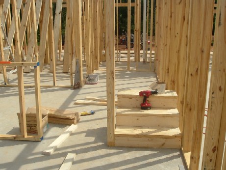

#75
I'm kind of doing two things at once here.
First I was putting in the floor joists for the second story until I got to a point I needed to know were the stairs were going to be.
Math has disapointed me too many times to rely on trying to calculate the exact location the stairs will end and the second story floor will begin.
My method is to build the stairs first, and I'll know exactly where they'll be. Then I can tie in the floor joists.

Today I was healthy enough to work on those stairs.
With small homes, every inch is important. My AC return duct will be at the bottom of the stairs for this part of the house. Next to that will be storage, which is right across the holl from the kitchen. I might be a pantry of sorts. I don't know for sure yet.
Yet to be built is a coat closet and then the space for the laundry machines.
