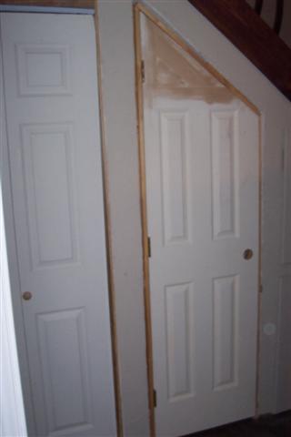

All the downstairs doors are the raised 6 panel style. Steph said I should put in a flat panel door here because of the angle at the top. It would have been easier, but it would have clashed with the other doors. Especaill they laundry bi-folds right next to it.
I've modified quite a few interior doors to get the width I needed, but this is the first time putting an angle on top of one.
First step was to cut off the angle.

I cut up the piece I removed into two pieces and put the door back together. I used blocks, glue and staples to hold it together, but wasn't really happy with how that was working. Next I drilled some holes in the back and put a little expanding foam in along all the seams and clamped it tight. I did this on the outside too.
The next day when everything was dry, it was quite solid.
After this picture was taken, I cleaned it up and sanded sanded it smooth. Since I wanted the fake wood grain, I went over the sanded areas with my dremel.

One suprise that I wasn't expecting what the top inside edge of the door catching on the top of the frame. I had to cut it down to a point and bevel the edge half way up. Now it opens and closes just like it should.
I'll paint the door when I buy the trim. Otherwise, it's done.

Eddie, you are a genius. Who else wouldda thunk up a solution like that? Pure genius.
