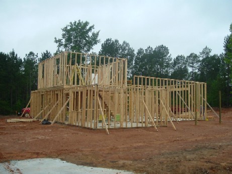

Here's a scenic view with the second story just about framed in.

Here's a little closer view of the second story.
It will have two bedrooms and a full bath.

Eddie, what kind of siding will be on it? I have always put the sheating on before I stood up the walls. I build the walls flat on the floor then wait till I have some help to stand them up. I have found that help wasn't coming so I used a jib pole mounted on my backhoe loader bucket. It is a lot of work, but sure saves a lot of bracing.
Later, Nat
/ Creating a Workshop & Home
#86
Nat,
I'm doing things a little unorthodoxed here. The entire building is sort of a showpiece/experiement for my RV Park.
The theme is a sort of East Africa/India/Western type of thing. Yeah, I know... HUH?
It makes sence to me, just explaining it is dificult.
I'm using stucco for the siding. It will be poorly done, with lots of imperfections. The look I want is unskilled third world labor. I will also stain it to try and get a weathered look.
Like I said, this will be some serious experimenting by trial and error. Hopefully I'll get lucky and the picture I see in my mind will come out in reality. /forums/images/graemlins/smile.gif

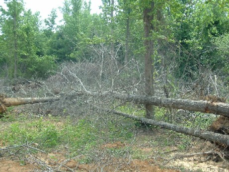

To achieve this, I want exposed timber beam ceilings. I have all sorts of trees that I've taken out just lying around waiting to burn. The oaks seem like a good source for beams.
Here's one that's been down for awhile.

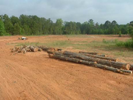

This is my staging area for my logs.
The cedars will be used for posts on the porches and later on for gazebo's.
The oaks are what I'm using for my beams.
