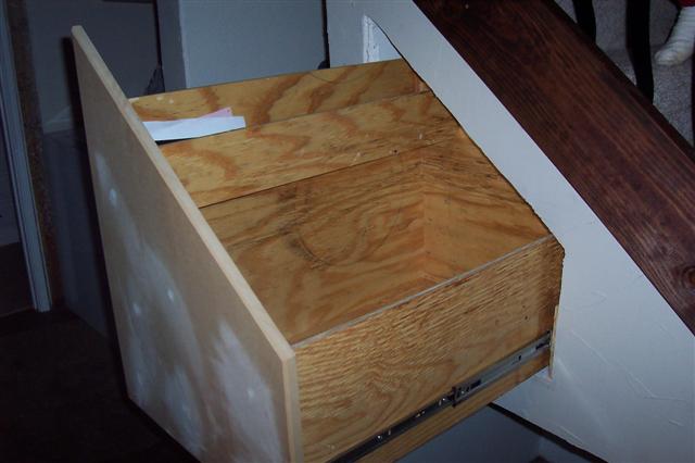

The top space was another one of those that I created without an idea of how it would work out. I had an idea of putting a shelf across it where the angle went up, but wasn't very happy with that idea.
The drawer idea worked well there as well. I just build it up on the tall side and created a small shelf to take advantage of that upper space.

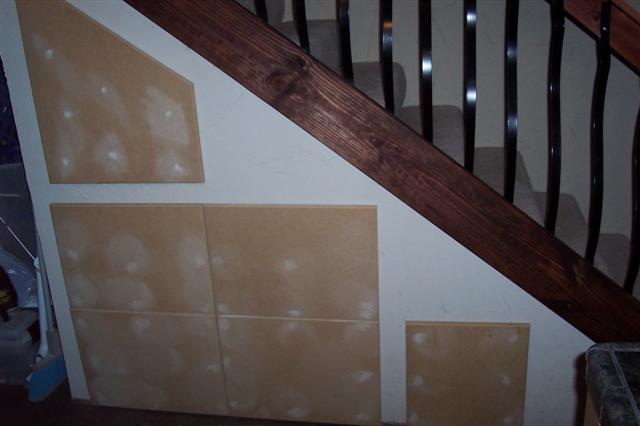

For drawer fronts I used MDF for a nice smooth finish. I beveld the edges to match my kitchen cabinets and split the big drawers in half to make it look like four draweres instead of two. It was just too overwhelming as two giant drawers and the lines all line up now. The height of the shoe drawer was used for the bottom part of the big drawers. The width of the top drawer is the same width as one of the bottom drawers. This was never planed until I started cutting the faces.

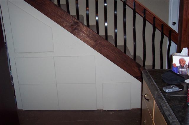

It was right around freezing outside last night, so Steph decided to paint the drawers in the kitchen.

I had a mental block on the paint for these. Bright white has been in my brain, and that's just what I would have used. I also thought it might not look very good and be sort of a magnet for the eyes, which I didn't want.
Steph said we should use the same color paint as the wall. At first this seemed wrong to me, but after a bit I saw the beauty of it. The drawers would blend in real nice now.

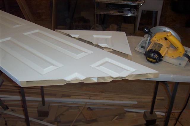

All the downstairs doors are the raised 6 panel style. Steph said I should put in a flat panel door here because of the angle at the top. It would have been easier, but it would have clashed with the other doors. Especaill they laundry bi-folds right next to it.
I've modified quite a few interior doors to get the width I needed, but this is the first time putting an angle on top of one.
First step was to cut off the angle.
