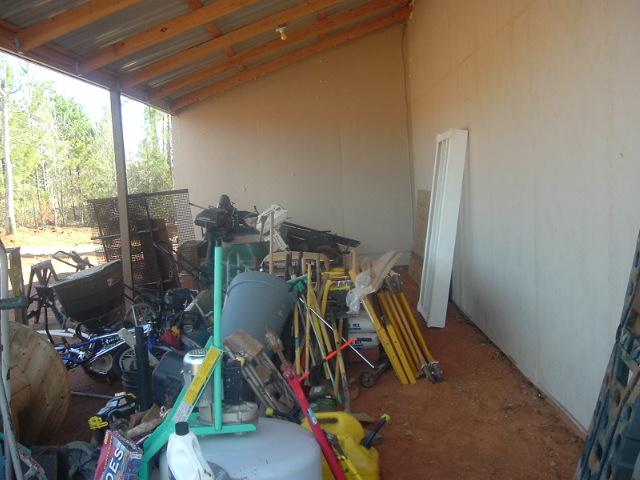

It rained all day Saturday, so Steph and I went to the Dallas Safari Club Convention. Perfect timing since I hate going anyplace when it's nice out and I have dirt to move. /forums/images/graemlins/smirk.gif
Sunday was too muddy to do any work on the lake, so I decided to start organizing my outdoor storage area. Just to remind everyone. It's 12 feet wide and 30 feet long. The inside wall is 12 feet tall and the side opening is 8 feet tall.
This is what I've been triping over for the last 4 months.

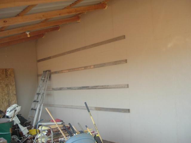

The hardest part of any project is the planning. What do I need and where do I need it?
Sizing and spacing my shelves fell under this catagory. I've spent many hours pondering this in my mind while moving dirt. It's not just what I want them to hold today, but what I might have in five or ten years.
I made the bottom shelf three feet off the ground. This will give me enough room for most of my "big" stuff that's too heavy to pick up and put on a shelf. The rest of them are two feet up from the next. That puts the to shelf at 9 feet.
I'm using scrap and left over lumber for this project. The longest 2x4's I have are all 12 feet. Most are covered with concrete from being forms.
The shelves will be 16 feet long and 2 feet wide.

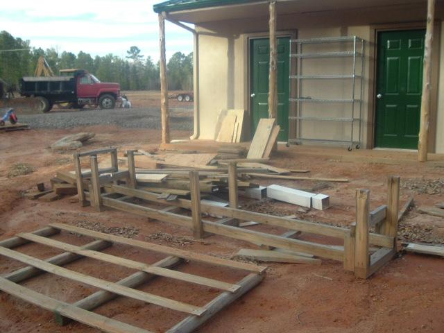

Since I'm using scrap lumber for this, I've had to do some scrounging. When I built the house, I toss all my scrap pieces of wood into a pile. Over time, I find I use most of it up for smaller projects.
The shelves needed allot of 21 inch 2x4's. I hate cutting up a nice piece of wood for a bunch of small ones if I can avoid it.
In this picture, you can see a pallet and the frame my roll up door came in, plus the scrap pile. It took allot longer than I thought it would to take apart and remove the nails. Some people really love nailing!!!! /forums/images/graemlins/frown.gif

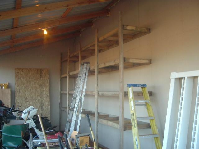

Once the pieces were cut, it's was pretty easy to put them together. I'm using ten foot 2x4's for the posts. That gives me an extra foot of height above the top shelf. The reason for that is it's where I plan to store all my PVC pipe. I have lots of it, but no place to keep it so it's out of the way, out of the weather, but readily accessable when I need it. Now I do.
The posts have PT 2x4's nailed onto the bottom as feet. I didn't want the wood to sit on the dirt, even though it's dry, so I thought this would work.

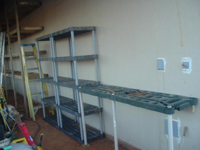

Years ago I bought some Rubbermaid shelves and a tool holder. They have worked great and I wanted to use them in this area. I have more hand tools than space for the tool holder and was going to buy another one when I got this idea.
I don't need the bottom part to hold the tools in position, and it's identical to the top part, so why not combine them into one super long tool holder. It was pretty easy to cut one end to line up flush eith the other, then screw it together from both ends so it's tight.
Than I put up a ledger board at the beginning of my storage area.
The grey boxes you see in the picture are my light switch, outdoor outlet and the big one on the bottom is a juction box with 4 12/2 wires dead headed. They will be used for future projects, but for now they are just in place waiting. /forums/images/graemlins/smile.gif

Here's a picture of the tool holder and shelves fastened to the wall.
I put screws with washers through the palstic shelves and hardi siding, and into the the studs. This should make it all very stable and secure.

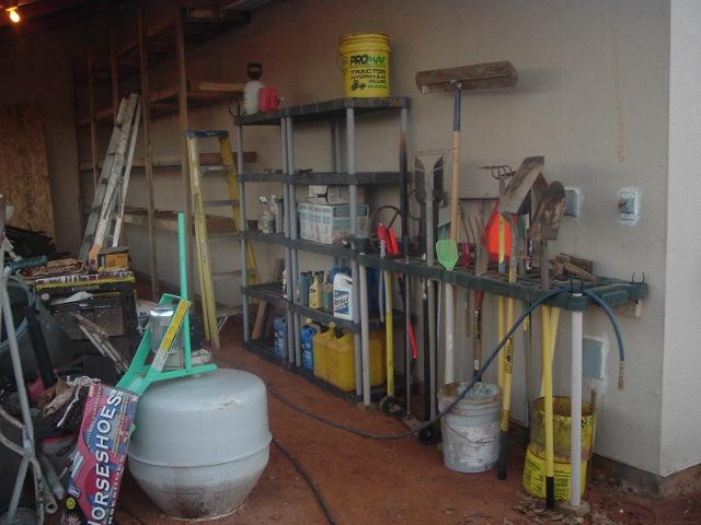

I started organizing a little and put a few things away. This is the part I hate the most. Where to put it so I can find it when I need it, but it won't be in the way, or it will be nice and handy.
I plan to get it all cleaned up and organized today. My goal is to be able to park my CUT with bush hog attached in this space out of the weather!!!!
