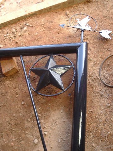

Here it is attached to the light.
I think the combination of the exact same star on every light and a differnet weathervane will work pretty good.

You and your pretty and capable lady are an inspiration. It's hard to imagine how life could get much better! Great looking walls and hardware and to the lady, great looking welds.
Cheers to the projects and becoming confident with new skills and admiring the results of established skills!

It looks like you've found my friends over at Westcraft. http://westcraft.com/ We've been fans and customers of theirs for about eight or so years.
A good alternative to your system for weathervanes that I use is a ball bearing between the pin and the vane. I'll use a grade eight stud (for hardness) ground to a point. On top of that I place ball bearing. Then the vane itself has a female or piece of tubing or pipe that covers the pivot. Gravity is a great keeper.

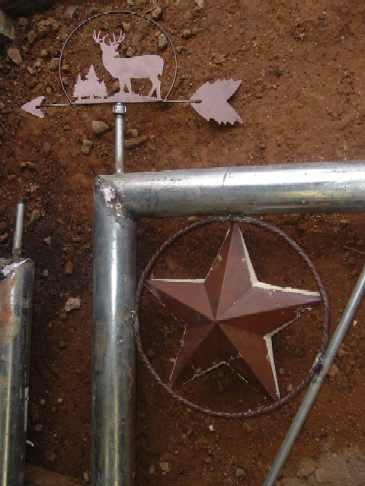

Assembly of my first street light is done. I primed it, waited a day, flipped it and primed the other side.
Another day and I painted one side. I'm using oil based paint in winter with temps in the 50's. It took two days for the paint to dry, and today I fliped it again and finished painting it.
Rains are predicted for Friday through Sunday. If it feels dry on Friday morning, and it hasn't started raining yet, I'm gonna try and install it.
