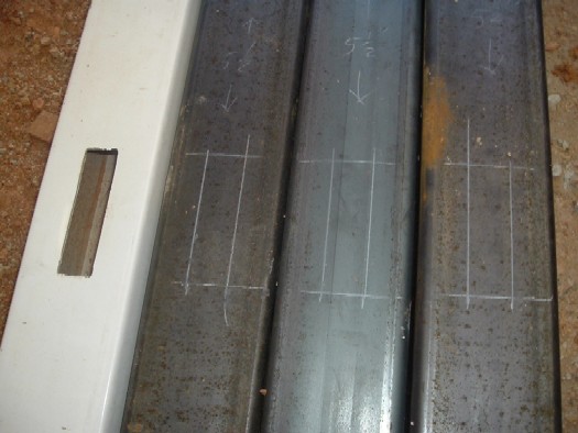

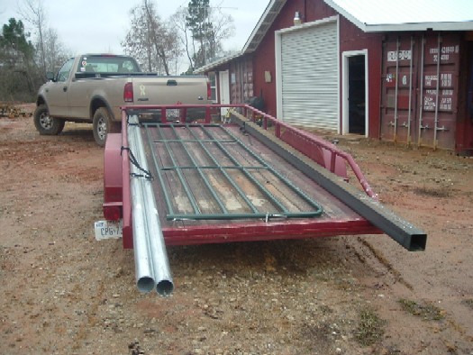

I bought a piece of 5 inch 3/16 square tubeing 20 feet long from my local steel supplier. I was also going to buy some 4 inch pipe from them, but thought their price was kind of on the hight side.
Harvey told me about a buddy of his that could get me a better price, which he did. Half the amount!!!!!!!! Thanks Harvey.

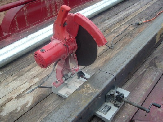

The pipe and tubing is heavier than I am strong, so I decided to cut them on my trailer. It was also easier to carry the chop saw to the trailer then the other way around.
A 14 inch chop saw will cut a 5 inch tubing in two cuts. The 4 inch pipe was done in one.

My chop saw wasn't exactly on 45 degrees, so I'm gonna have to fill that gap when I weld it up.

The square tubing is to replace the vinyl posts in my three rail fence. I'll cut out the openings for the rails to the exact same dimensions as the vinyl posts.

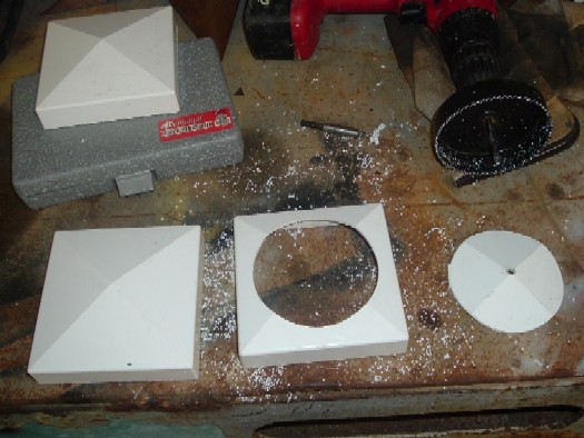

The vinyl caps for the posts drill real easy.
