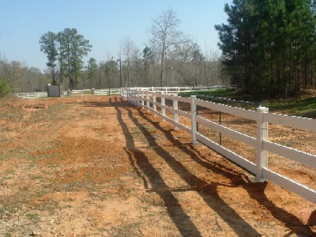

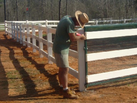

I was really pleased with the way my other gate turned out with the rails attached to it, so I did the same thing with this one.

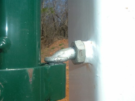

The gate came with those standard hinges that thread into a wood post. I replaced them with threaded ones used to bolt to a metal post.
To support the gate, I used 5 inch metal tubing. I cut a hole in it for the hinge to go through, then welded one of the nuts to the tubing.
Then it was real simple to thread the hinge into the post and lock it into place with the other nut.

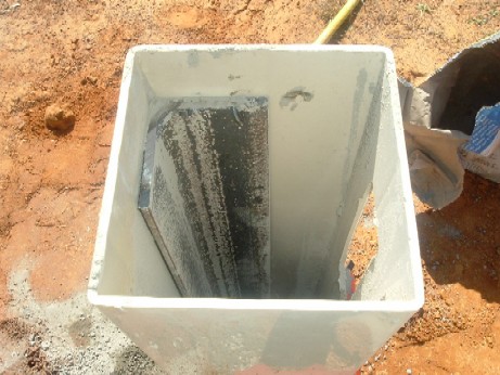

On the other post to secure the gate with a latch, I cut a piece of angle iron and slid it into the vinyl post. Then I set it in concrete and filled the post with concrete also.
I will come back later and drill into the angle iron to mount the latch after everything dries.

Here I am filling the ends of the rails with expanding foam. I figured that some wasp or other annoying critter will make a nest there if I leave it open.
After it dries, I'll cut if flush and paint it white when I do my touch up painting on the metal post and lights.
