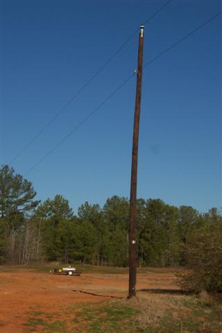

You're right about utility pole not being in line with my street light. That pole is straight in the ground, but then it makes a graceful (joking) curve towards my pond. hahaha
They put it in when I was away on a job and when I called to complain, they said the pole is fine and if I wanted to replace it, I'd have to pay for it. They weren't rude about it, but it wasn't a battle that I felt very comfortable about winning.

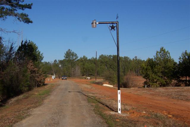

The poles are 4 inch galvanized that I'm able to buy for less than I can get steel pipe or tubing thanks to Harvey. When we all got together at his place for the first TBN Get Together, I was really impressed by the gate he built for that client of his. Until then, I had no idea how I was gonna deal with lighting and blending it with my vinyl fence. I also didn't know how to finish it, but he likes Rustolium paint, and that's what I'm using. I figure I'll have to touch it up from time to time, but the other two are looking great after two years in the ground.
Can you powder coat galvanized steel? The lights are 21 feet long. Is that too long? I had a custom Gate done one time and each half was 8 feet long. They said that was pretty big, but I don't have a clue what the maximum size is that they can handle.

You can powder coat galvanized steel. We do it all the time for some of our customers. The powder coater needs to know what he is doing since the galvanized steel will put off a gas while in the oven and cause the paint to bubble or streak. It all has to do with the pretreatment of the metal and a certain type of phosphate wash. And it can get expensive. If the rustolium works go with it, like you said it may only require some touch-up later. But if you have the money powder coating is the way to go.

Eddie, you are doing the next best thing to powder coating by using the Rustolum. I forgot about the galv pipe but as was already mentioned it can be powder coated. As for the length that will depend on the size of the oven the coater has. The guy I have been using has a 20ft long oven. I don't remember how wide or tall. But with a 21ft pole it would be easy just turning it at an angle.

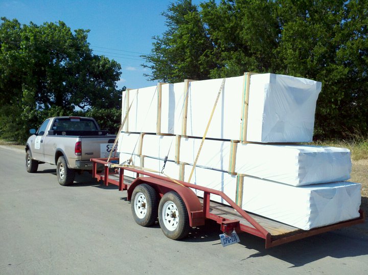

I bought 1,000 feet of White Vinyl 3 rail fence from Gardner Fence when I started this. I put 300 feet of it in at my entrance, and the rest went in for the pasture. I shoped around to see if I could find another source, but they are still the cheapest for what you get. I paid $3.80 a foot for 952 feet yesterday and picked it up in Corsicana. I'm not ready to start on the fence right away, but at least I have it on hand and can work on it when I have the time.
