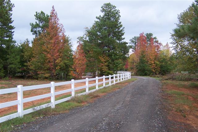

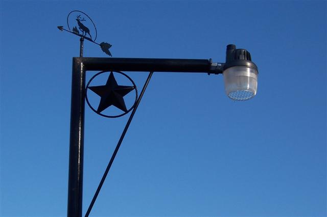

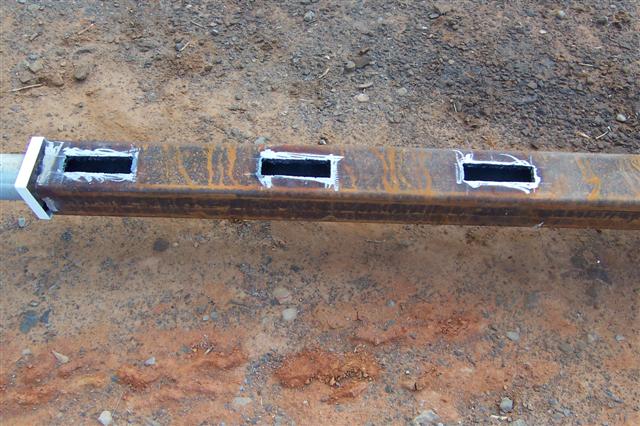

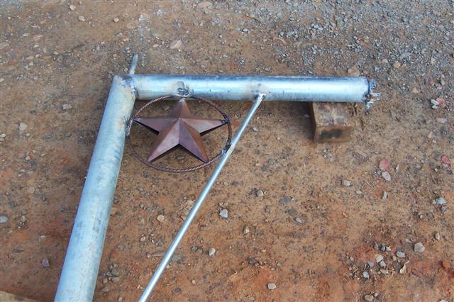

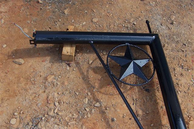

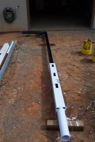

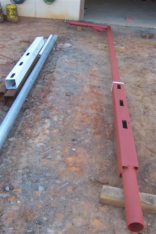

It's been cold and wet out, so to keep busy, I started building another street light for my entrance. The pipe is 4 inch galvanized. The post is 5 inch square tubing. The reason for those sizes is that my fence is white vinyl and the posts are 5 inches. I want the lights to blend with the fence and look like it all belongs together.
The first picture shows my gravel drive back in November. It's really a picture of the fall colors, but it gives an idea of the fence.
The other pictures show it as I painted it.
Eddie

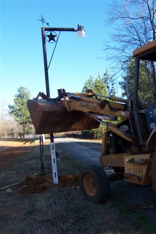

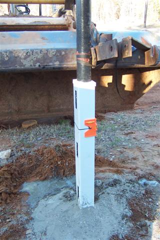

It was too windy yesterday to set the light, but today was perfect.
Nothing very interesting, just dug a hole, put the light in it, got it plumb and dumped a bunch of sacks of Readi Mix into the hole. I'll leave it sit overnight and then unstrap it from the backhoe.

Eddie:
In that third picture, the light post looks to be not parallel to the utility poles.
Are they really off that much, or was the picture taken before you had it plumb?
   / Creating an Entrance #180
Eddie, the light looks great. With your fence being vinyl did you ever think of powder coating the posts. I don't think it would cost much more than $40 or $50 a post and it would last a lot longer. With it being 2 tone maybe a little more. Just a thought.
