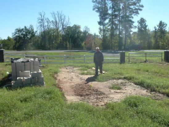

Since my dozer is out of commision for a little while, I decided to get back to this project.
I need a sign at my entrance to let the world know where I'm at, and to impress the **** out of everyone driving by. hahaha
First step was to build up the pad for the footing. I did this months ago. Then I drilled some holes in the ground three feet down to anchor the footing.
Then I didn't do anything for several months and now it's time to dig out the holes and level it out for the forms.

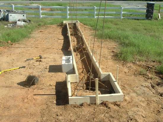

Since the sign will be built from cement blocks, it will be very heavy and quite tall, I wanted some overkill. The holes are three feet deep and a foot around. There are four of them. The forms are 2X6's and there's over two hundred feet of rebar in there.

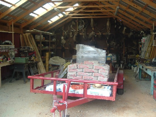

This time of year the weather changes on a daily basis and there's no predicting the next time it will rain. Luckily I have my "container barn" to store my sacks of mortor.
