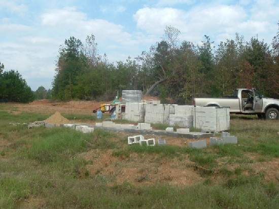

Time to get started laying blocks. There's four and a half pallets of white split face block for the main part of the sign.
Since the split face block only comes that way on one side, I have to double it up to get the same look on both sides.
Those blocks are $3 each. Over twice the cost of the standard blocks at $1.12 each at Home Depot. I'm still saving money though, because my original plan was to build the face of the sign from standard block and cover it in Austin Stone. More labor and allot more money that way. In the end I think the split face block will look better and it will be a theme I can carry through the Park.

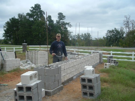

Three rows up and just about all I can do in a day! That's 38 blocks per row.
The ends of the sign are larger than the middle and of standard block becasue they will be wrapped in the same artificial stone I used on the entrance columns.
The rebar coming up through the blocks goes almost three feet down into the holes I drilled with my post hole digger and are tied into the footing. The cavities they are in are being filled with concrete to add extra strength.

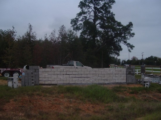

The next day I only got two rows done, but didn't get as early a start. The ends will be taller than the face of the sign and will have the pyrimid caps similar to the ones I made for the columns, minus the lights.
I'm not putting any mortor in the front of the blocks because I'm using standard Type N morter, which is grey. I will finish it up when the blocks are all done with the expensive white mortor.

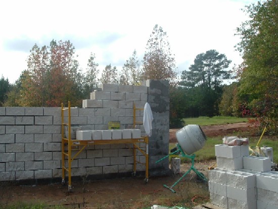

The main part of the sign is 11 blocks tall. Final measurement is right at 7 feet 4 inches.
Then end columns are currently 12 blocks tall, but I just bought some more today to raise it one row taller. I want the end colums to really stand out and add some power and demension to my sign.
You only have one chance to get that first impression. My sign is crucial to do just that.
The mixer was $250 from Home Depot. I shopped around and the cheaper ones were just too cheap for what I wanted.
The scaffolding was also $250, but i bought another section when I built my barn for another $100. Best money you can spend. I use my scaffolding for just about everything now.
