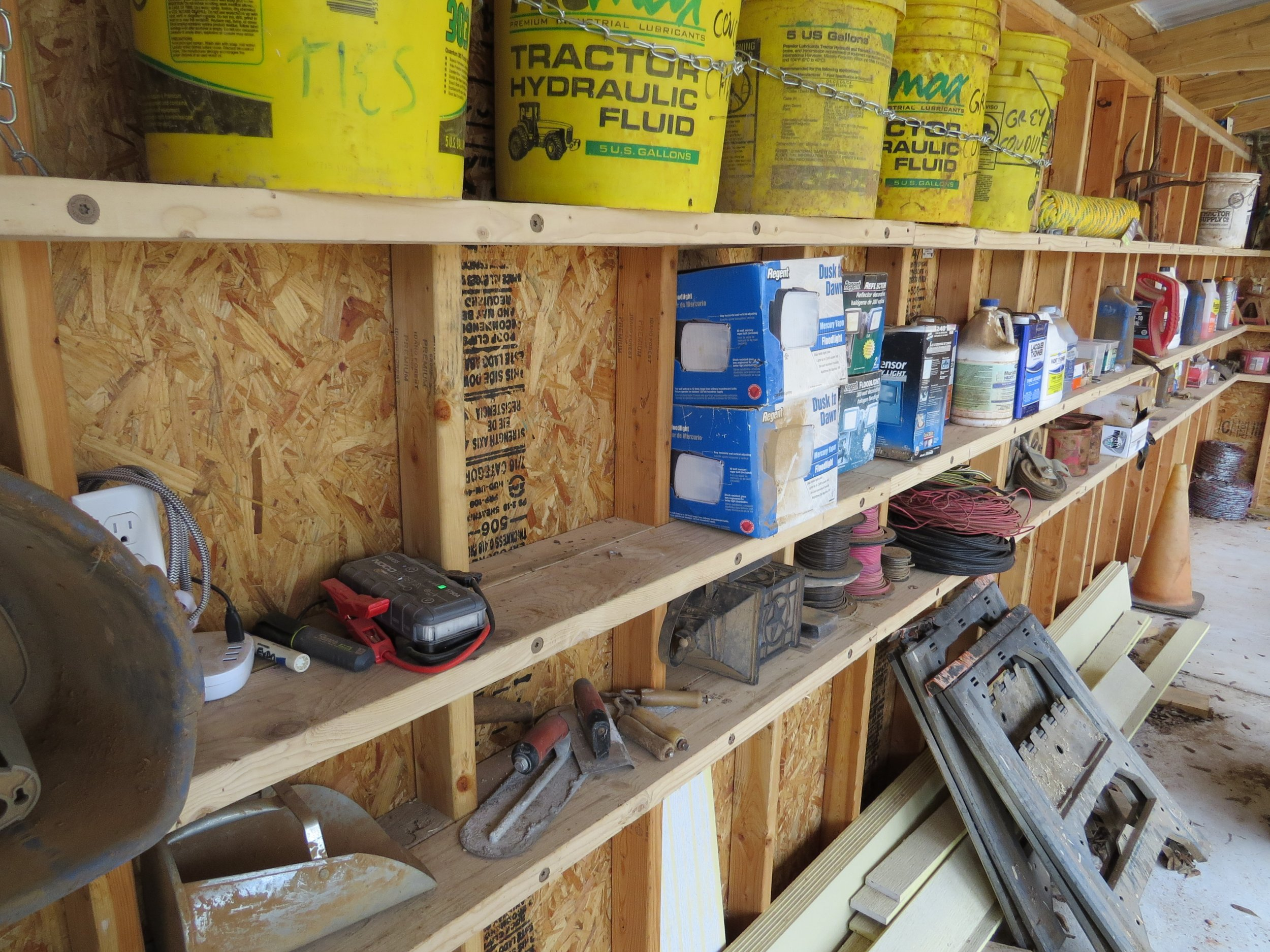

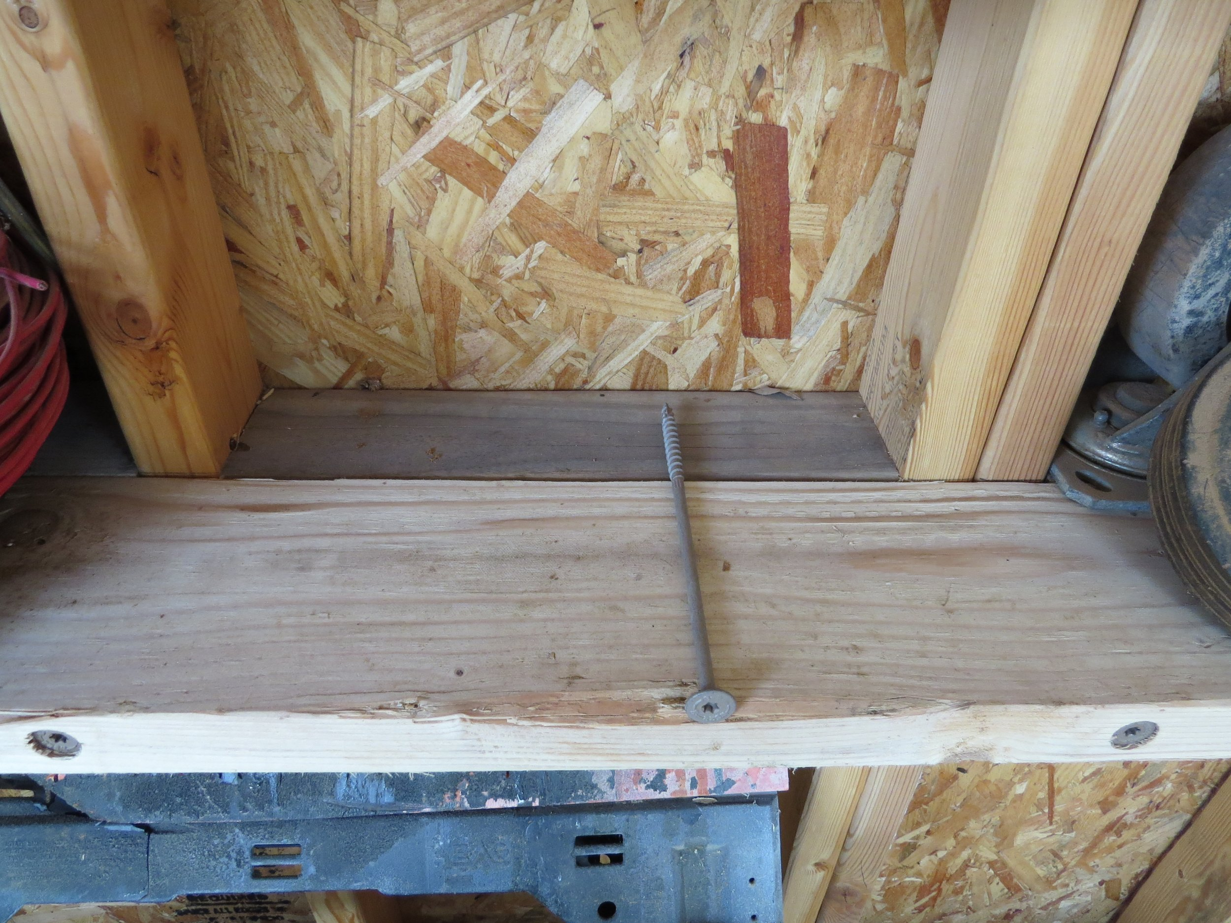

I forget when I built my shelves. I never did this before, but it's been an idea that I wanted to try. I used scrap 2x4's to block between my studs, then 2x6's attached with Simpson 8 inch structural screws through the 2x6 and into the stud. I drilled a hole through the 2x6 first, and that worked out great. https://www.lowes.com/pd/Simpson-St...de-8212-0-220-in-x-8-in-T40-50-Qty/1002703222

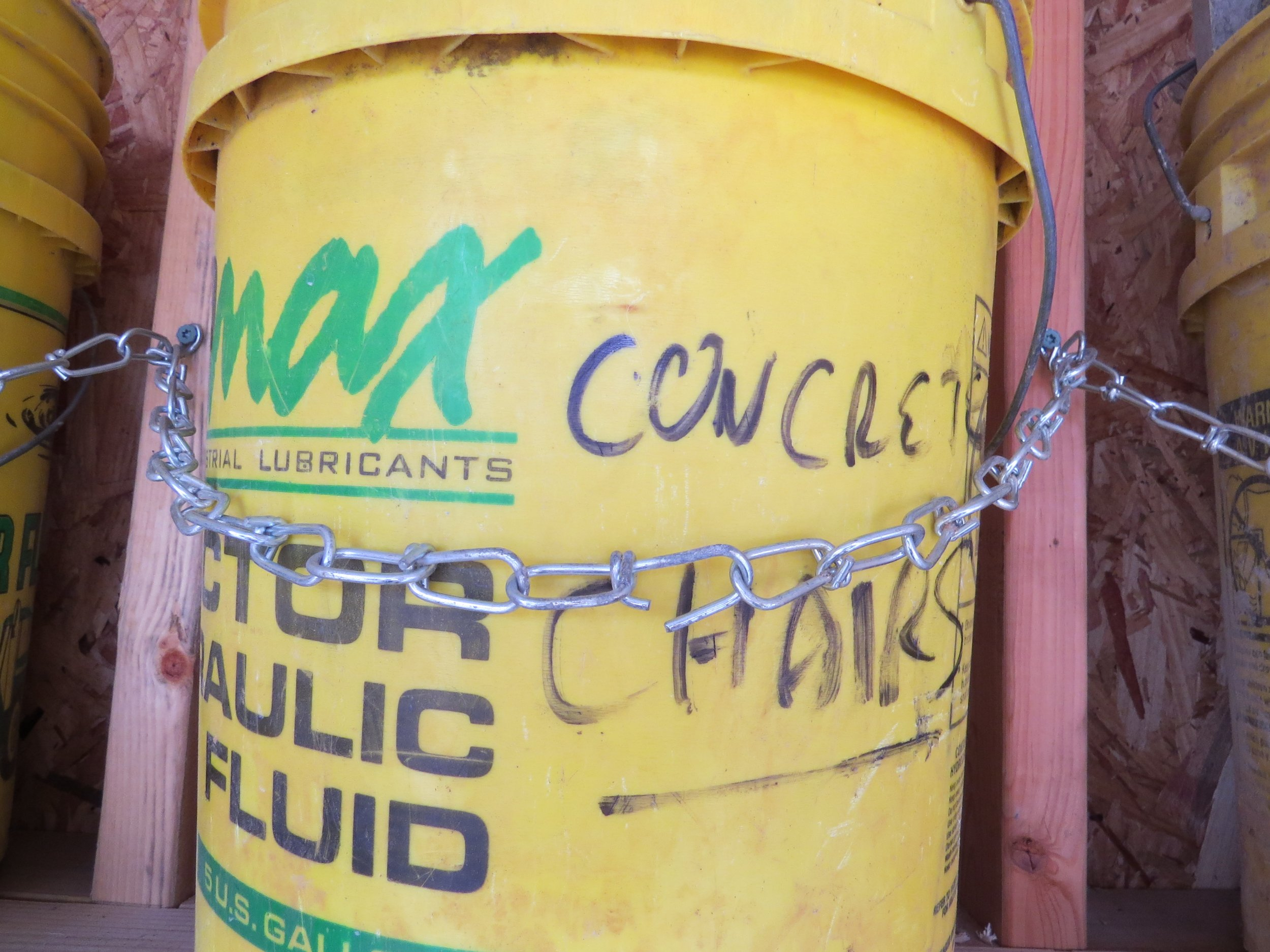

One of my goals was to create a shelf just big enough to hold what I wanted, but too small for the chickens to take over. This kind of worked. None of them are nesting on the shelves, but they love to knock stuff off of the shelves. My 5 gallon buckets where there favorite. To stop this, I found some chain that I cut to create a hook, and then screwed it into the studs on either side. Cheap and effective!!

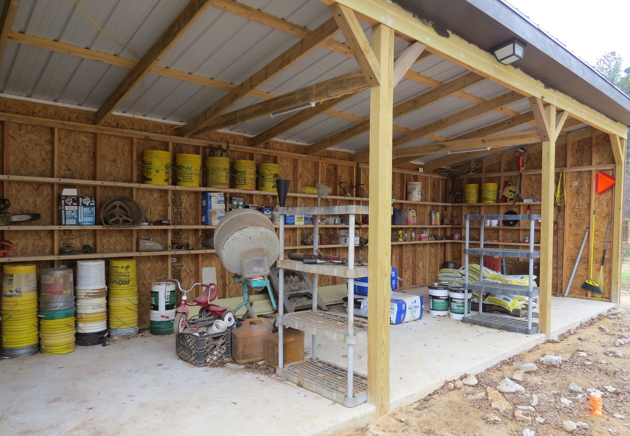

I'm slowly moving stuff into there. I'm also finding stuff that I have no use for, and should have thrown away years ago. The goal is to have the old storage area cleared out and get the dirt ready to pour concrete when the weather warms back up in the Spring. I'll deal with the Hardie siding one of these days, but for now, the House Wrap is all I have on the exterior.
I went with LED lights, which are awesome. I have two outlets, one light switch for the LEDs on the inside, and a Dusk to Dawn sensor for the LEDs on the exterior. It's really nice how much light they pout out!!!
