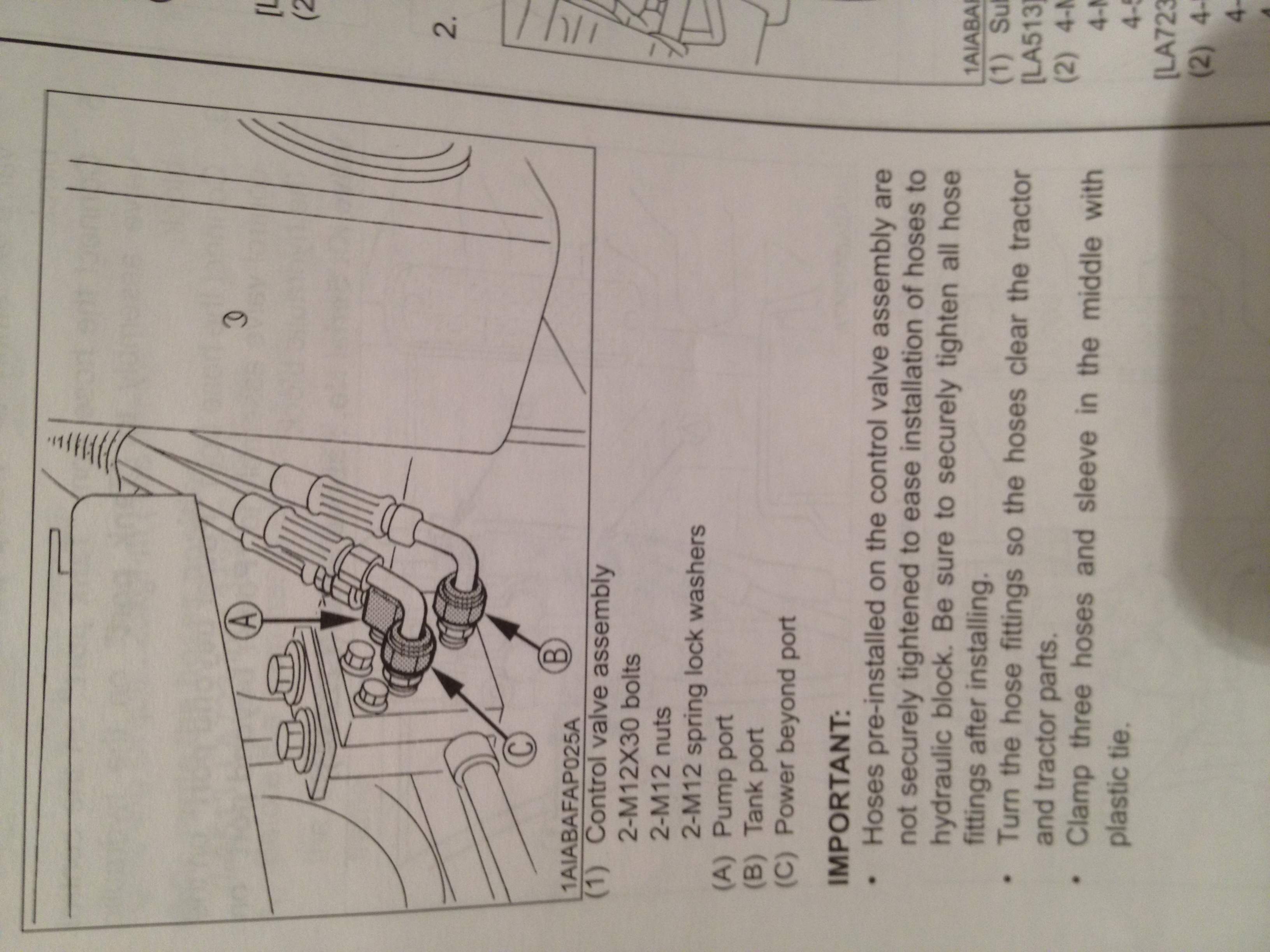

Connections on the cross valve should be:
Inlet on valve connected to pressure port of pump.
Power beyond port connected to the inlet of the three point hitch
return or tank connected to your reservoir.

On some hyd blocks there is a return line from the hyd block to the side of the tractor and to tank.
The hyd block will also feed the 3pt.

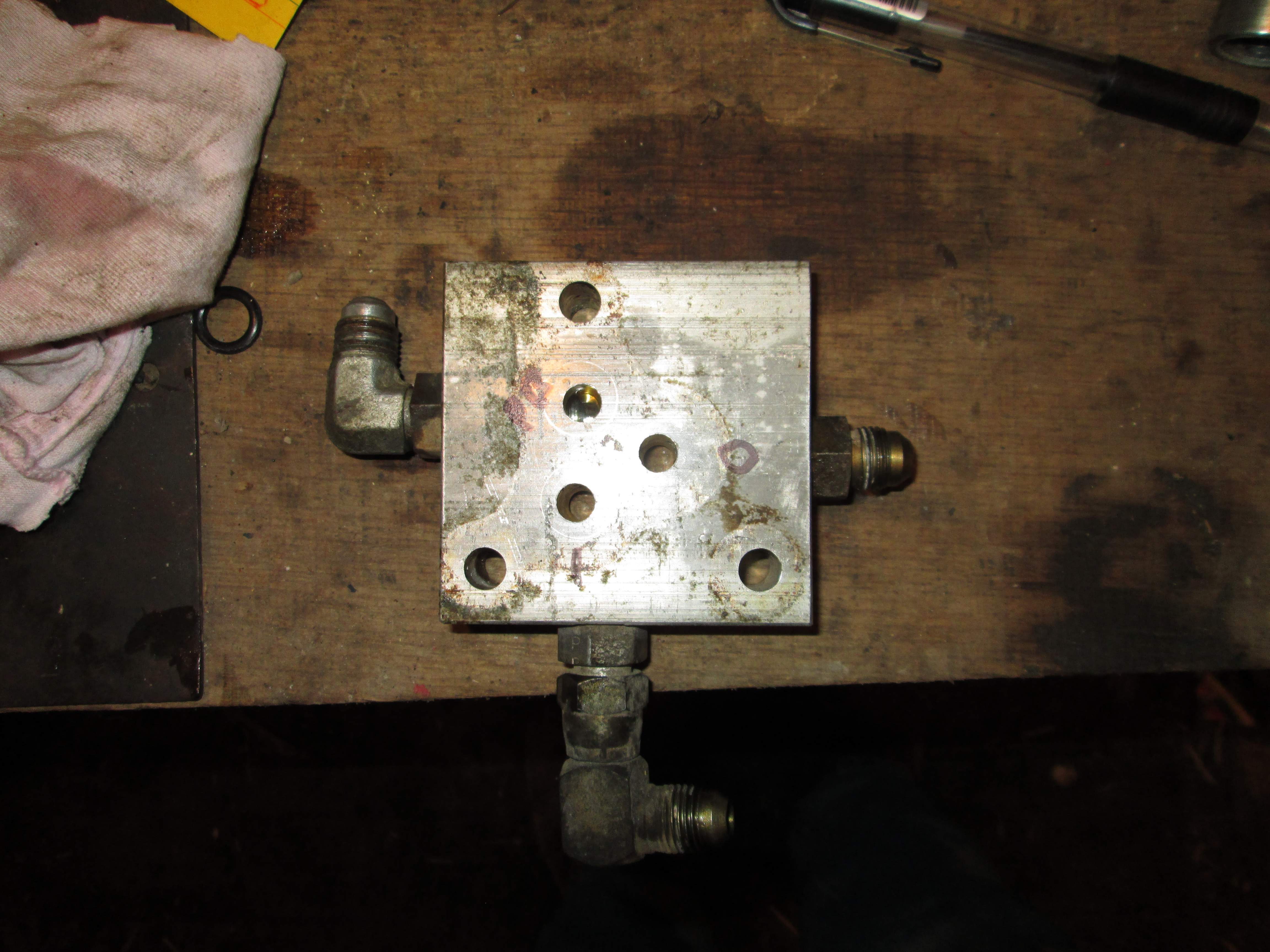

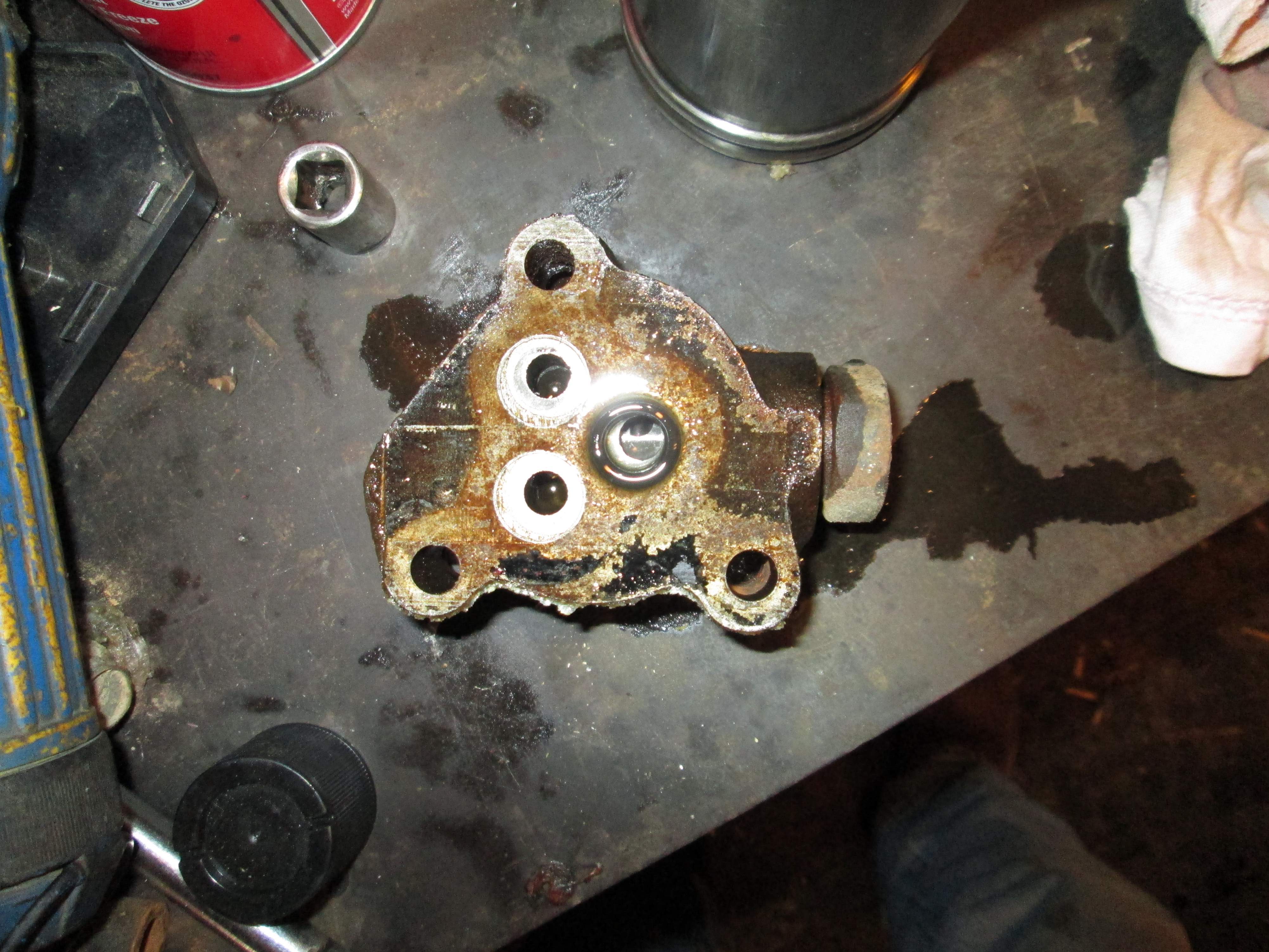

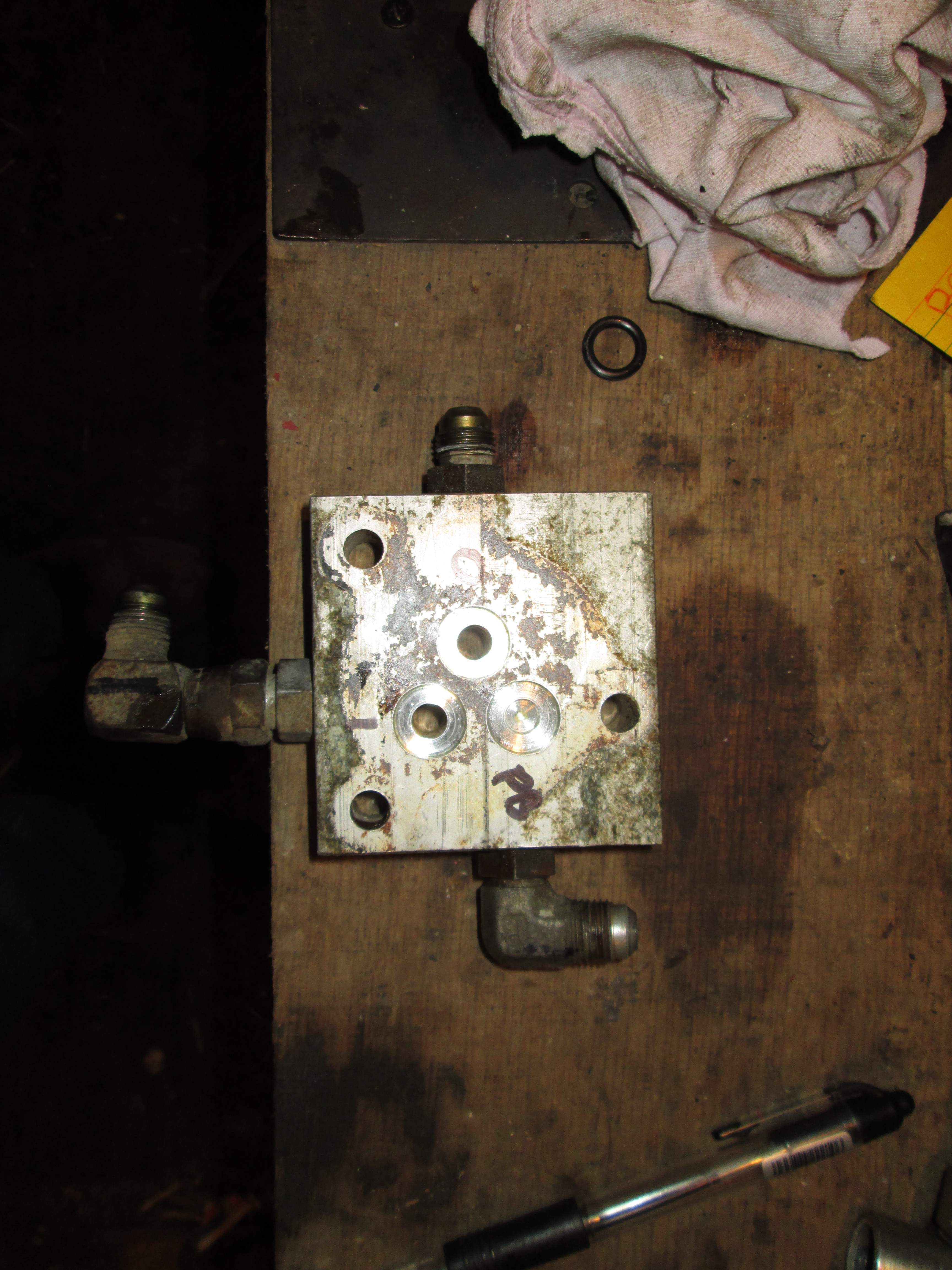

Here are a couple of pics of my hyd block. Why dont the 3rd hole go all the way thru? I know theres a reason what is it hyd 001.jpghyd 003.jpghyd 002.jpg
/ cross valve problems #17
It could just be a passage way for the fluid to flow from and to a certain point.
/ cross valve problems #18
If you look a little closer you can see the hole that doesn't go stright thru, it's also drilled from the side and goes out the fitting that is on it. Blow air back thru that fitting and see where it comes out. I would guess it feeds the 3pt and the other one is for rear hyd.
