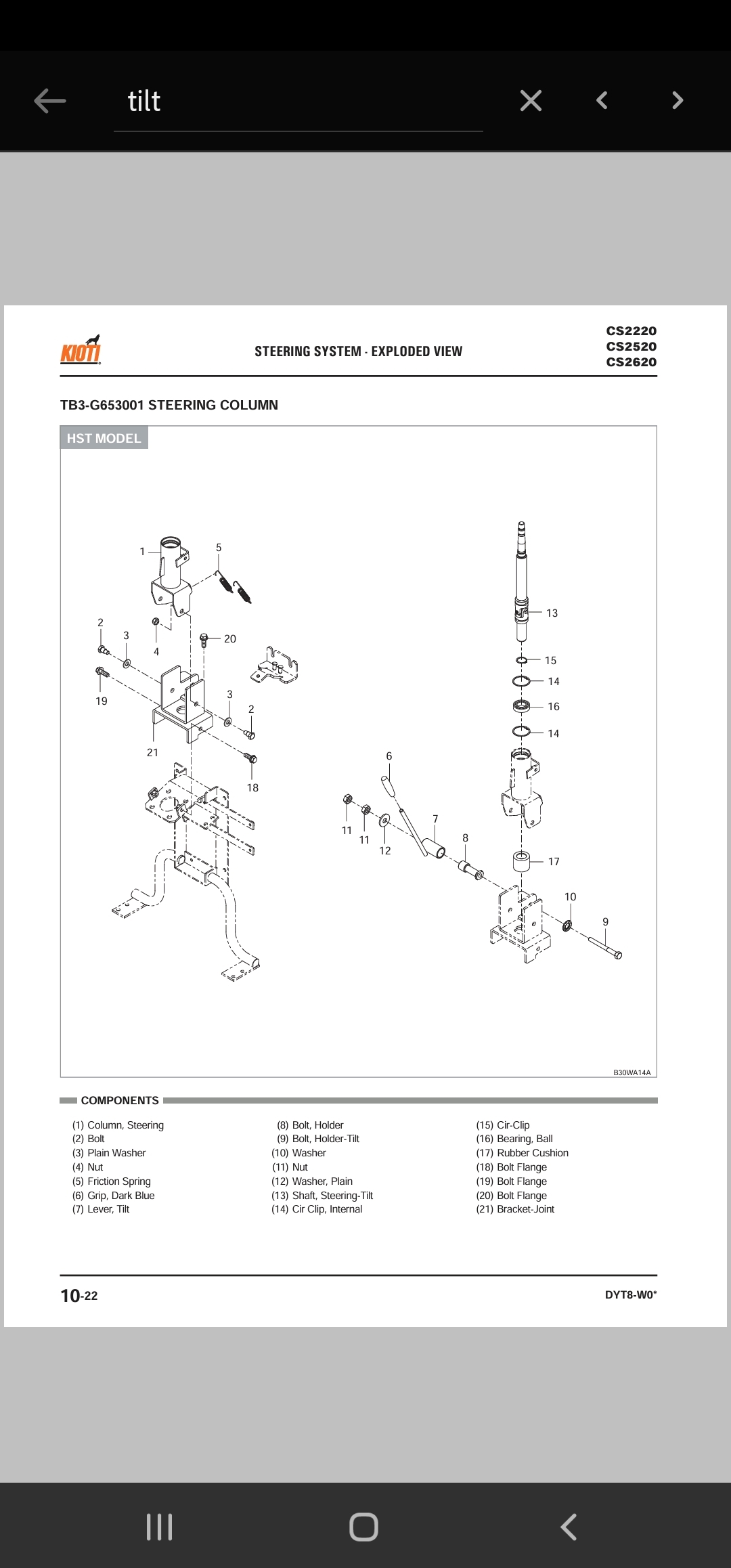

Has anyone had a problem with the tilt steering not holding very good? On mine it takes very little effort to move it forward or backward when it is locked as tight as it will lock. My dealer just called and said that he found no adjustment to make it hold better.

On both my Kubota's there is. You have to look under the instrument panel. There is a hex nut you can tighten to increase resistance and I imagine since Kioti copied Kubota and from the start and bought Kubota's obsolete tooling, I'd imagine that is still there and you dealer should know about it.

If I find a downloadable service manual or parts book I will post it in this forum. My dealer disassembled the tilt steering on mine yesterdy (they said). They told me they could find no way to tighten it up. Their suggestion was to put it where I wanted it and then they would weld it in that position. I don't want to do that.

That's a scary dealership! If the issue is that the loads are more than the friction clamp can handle, perhaps consider a less-permanent solution first. It could be as simple as a bolt through the two parts.

And yeah look like it's a bolt with 2 nuts on the lever end...that your dealership couldn't find.
