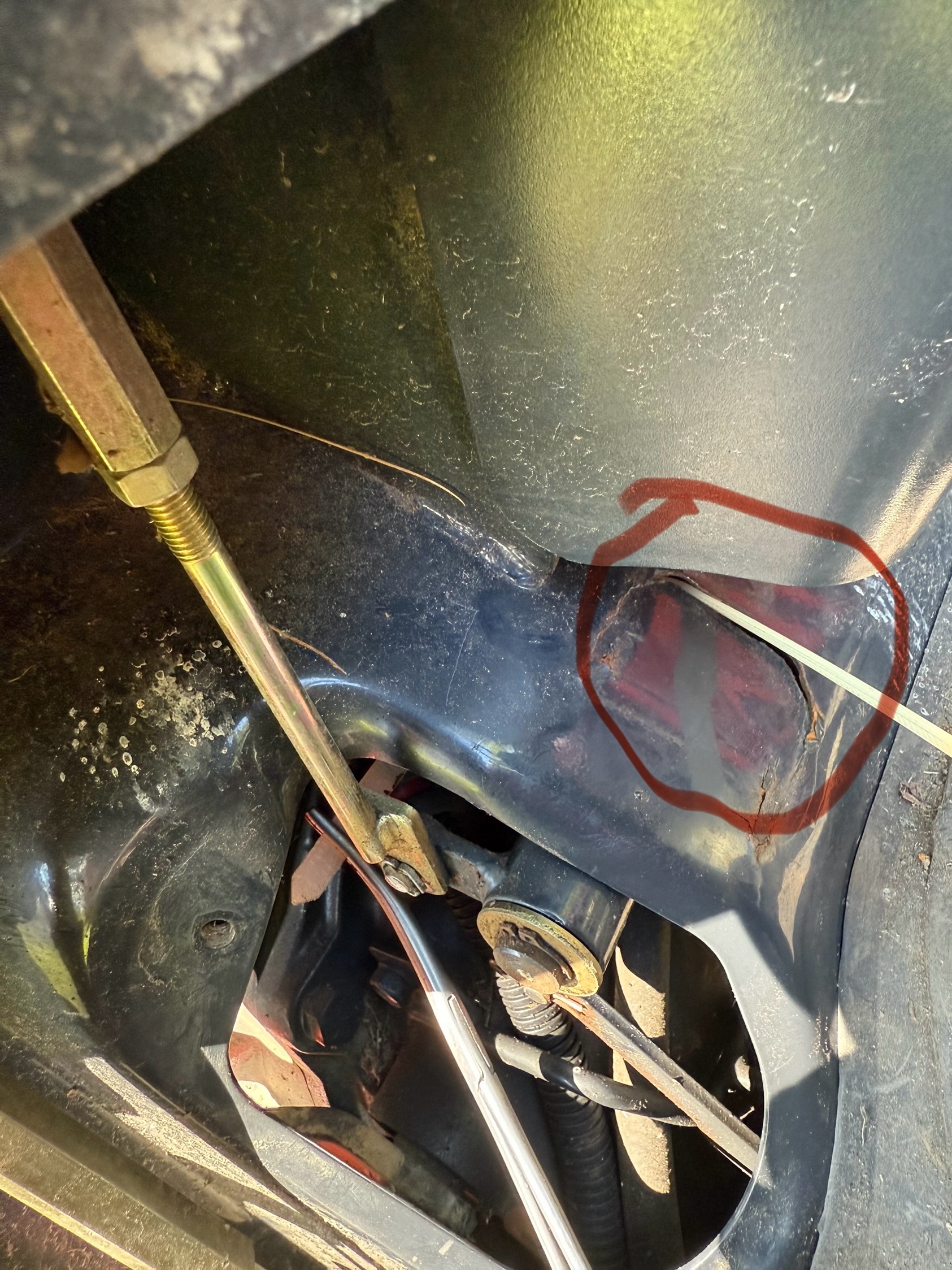

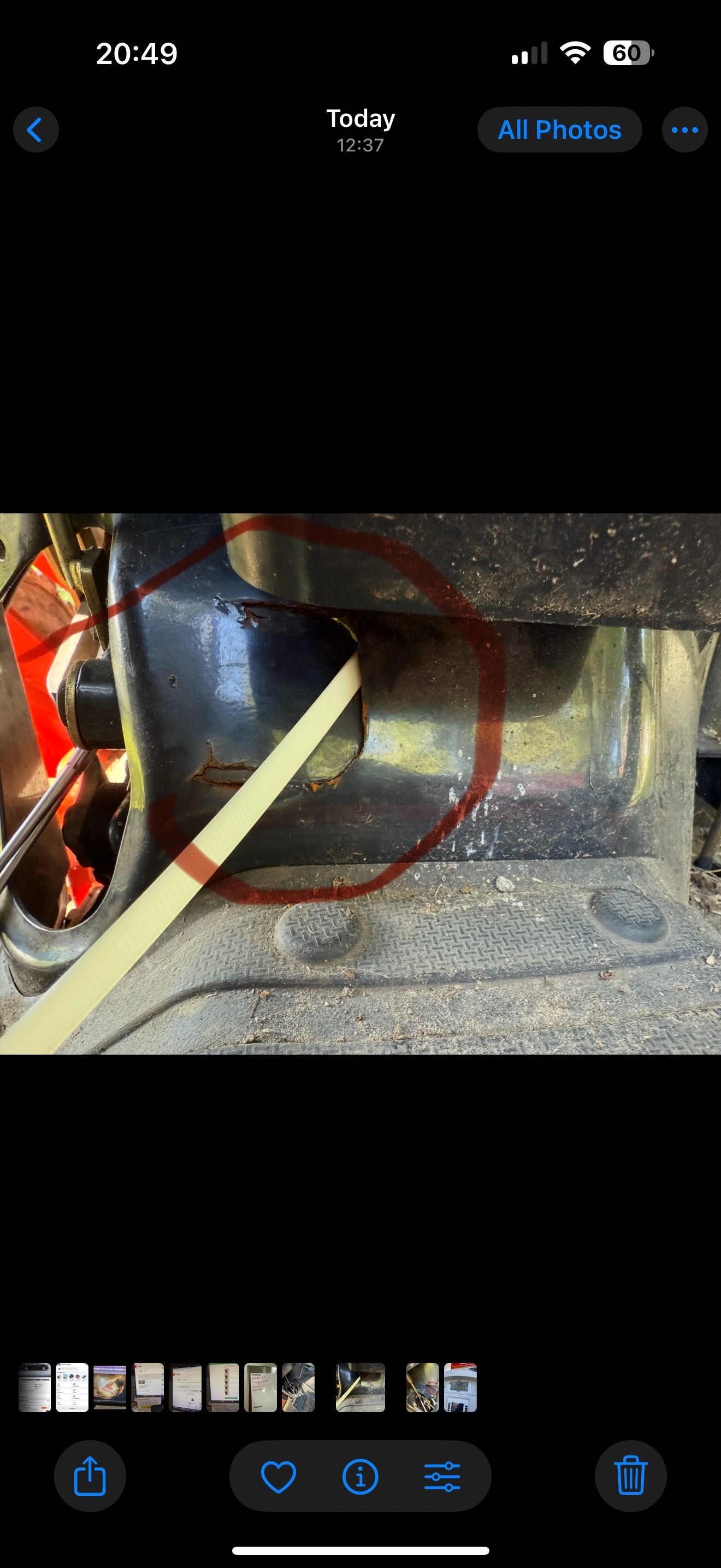

I noticed all of a sudden my dk4510 wasn’t slipping in to forward very easily. It’s like I couldnt actually push it far enough to get it to engage. Started looking around and found the the pictures below. Obviously there is a ton of play in the linkage right now, hope that’s the issue. What caused this to break like that? I mean seriously how? 300 hours on my tractor.
No warranty . Dealer said the skirt is 750 plus shipping and it will take 3-4 weeks to get it. I would have to do it myself too, can not pay for the labor on all that and the whole dash has to come out. Did a bent fork cause this? Any suggestions of cause and a simple fix ? Anyone seen this before?

Well you lost me. What I see circled in the photos looks like a broken piece of plastic. Regardless of the expense (or difficulty of replacement) I'm not seeing how that translates to a shuttle problem where one direction is hard to engage. Maybe you can clarify that a little.

That's not plastic, as seen by the rust around and the parts welded to it.
/ Shuttle shift issue #6
If that shaft we see in the picture is a pivot point for the shuttle lever, I suspect it was welded to that cover. Over the time with use, it eventually cracked, now it's bent, out of place and most likely won't let you fully shift into gear.
Now, for it to break from what it seems metal fatigue from bending multiple times, caused by being under pressure pretty much all the time, which it shouldn't happen with all the linkages adjusted properly.

That is a metal shroud that goes all the way up behind the center console. This is the pivot point where the number 1 and number 2 rod attach to each other. the part that connects them is called "arm connecting" Part# is T5710-59001. Obviously it was welded. I can weld that crack and it will probably hold for a while but I need to figure out why it broke like that. I know bent shifter forks in this tractor is talked about alot in here. Is there something going on with the transmission that caused this ect ect.

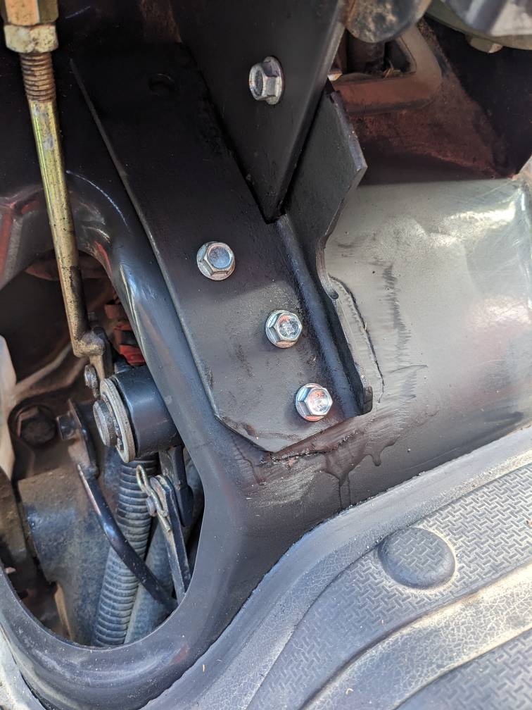

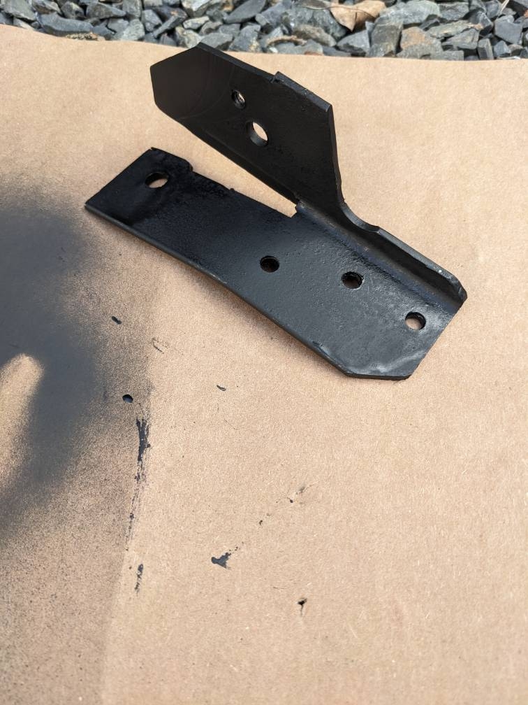

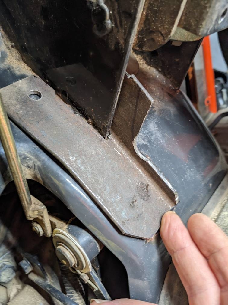

I have a DK5010 that had the same problem. I have no idea why Kioti welded the pivot to thin floor material when there is thick steel next to it. I fixed it with a piece of angle iron and some cutting and drilling.
I posted a bunch of photos. I'll find that and send you the pointer.
/ Shuttle shift issue #12
I am not a welder so I drilled and used self tapping bolts - 2 in the pivot bracket, and two in the heavier steel.
See photos
It has held up well for 2 years/200 hrs.
See photos
It has held up well for 2 years/200 hrs.View attachment 4133430View attachment 4133431View attachment 4133432
Fantastic!!!! thanks a bunch for the insight!!!! how long has the fix held up? I might throw a quick weld on there then do a bracket like you did. You did a nice job. Do you think the 1/8 bracket was thick enough? I love my tractor. But its things like this that really irritate me.
/ Shuttle shift issue #14
1/8" angle iron is plenty strong enough even though cutting it the way I did weakens it somewhat. The vertical part is bolted to 3/16" plate steel and there are two screws through the pivot bracket so it will not move.
I installed it in Sept 2023 and shifting is still very smooth.
