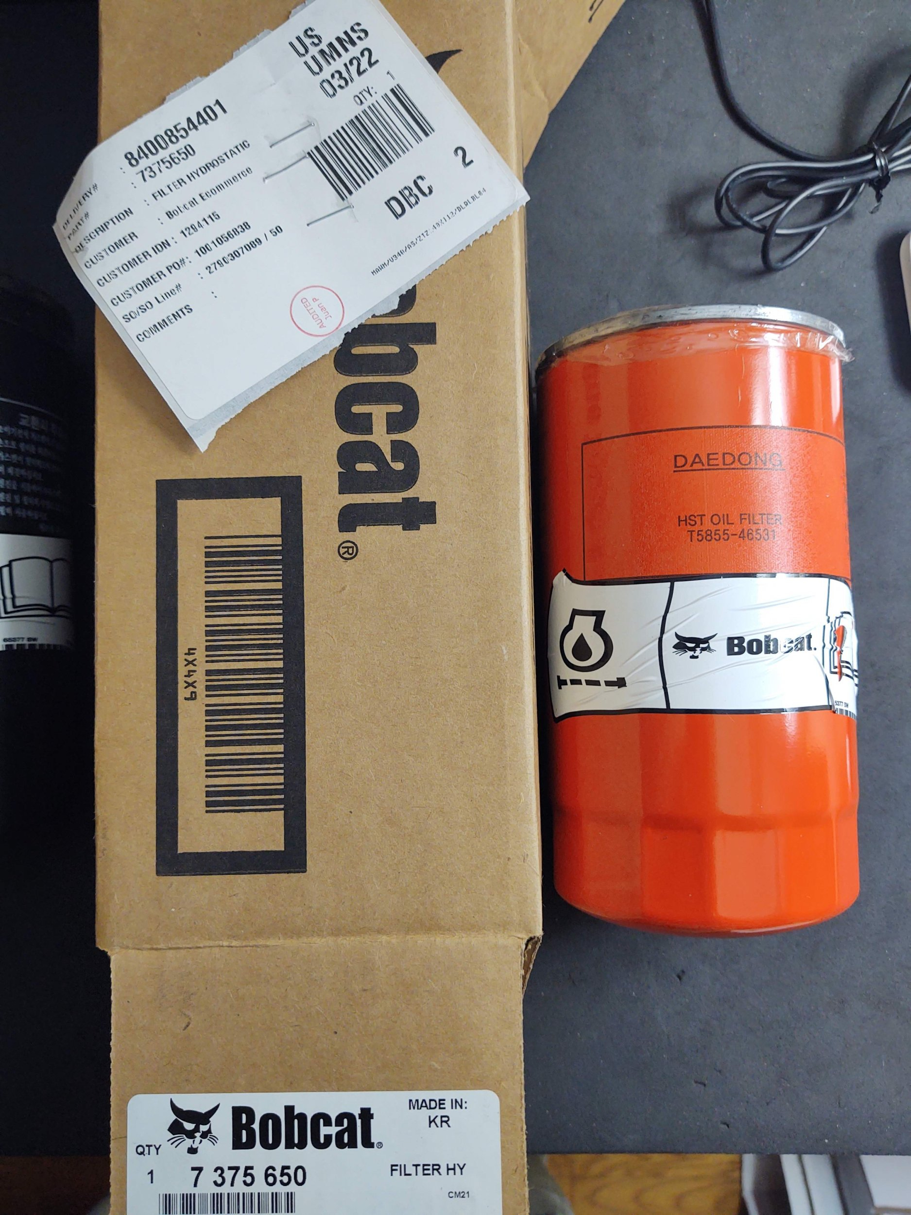

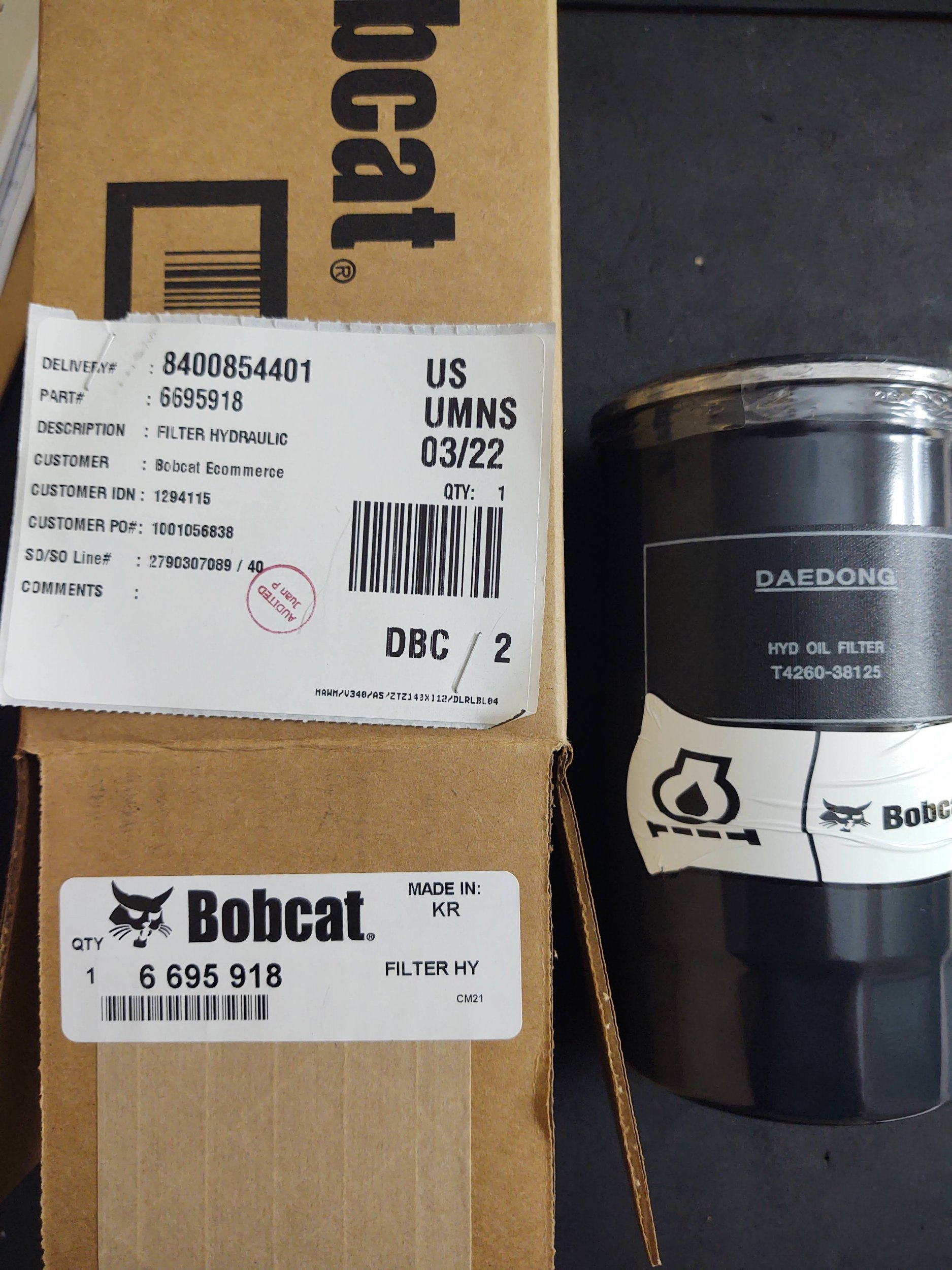

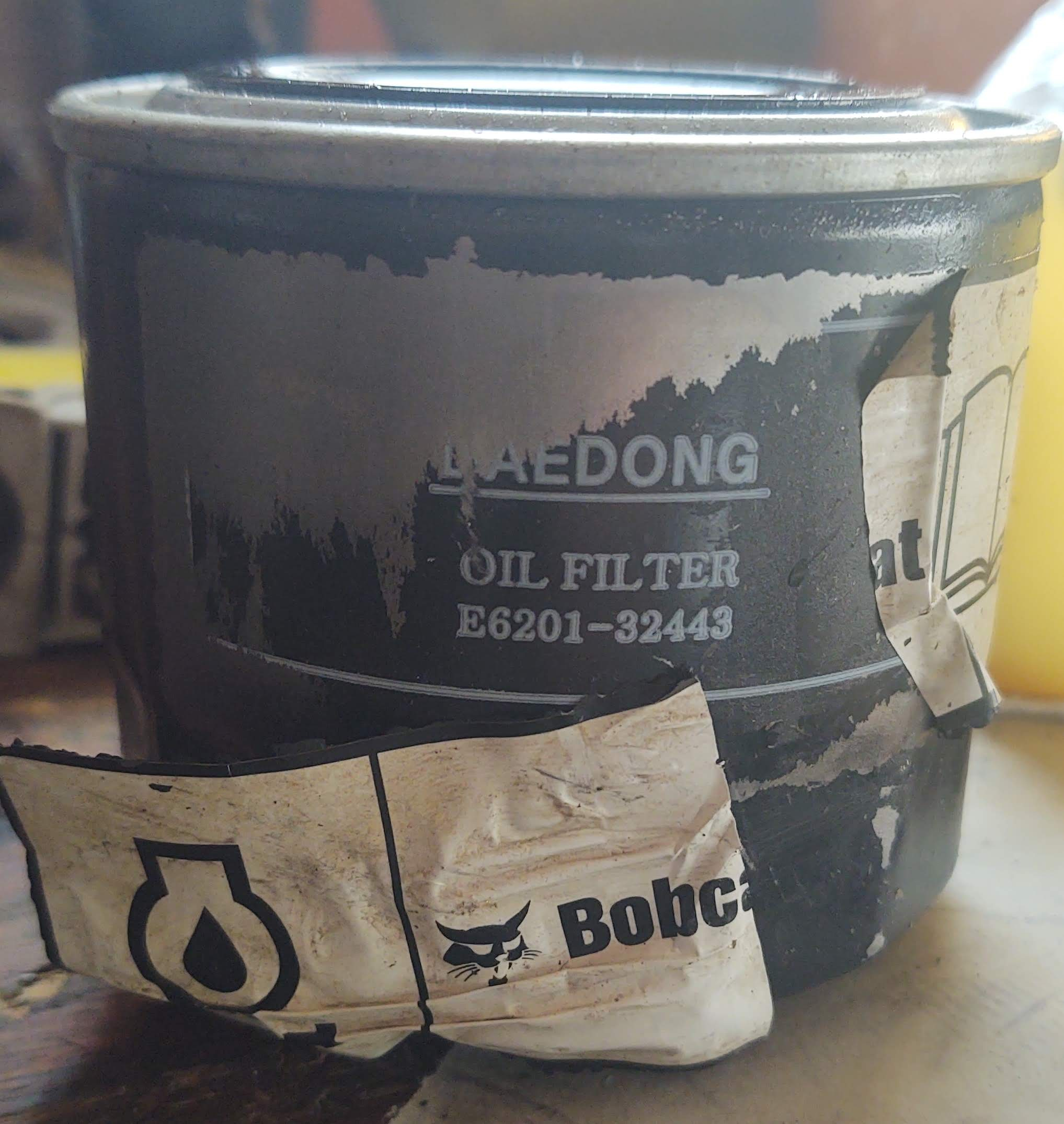

I own a 2020 CT2025H with 265 hrs on it. It was delivered December 2020. FL-7 loader, 3rd function, belly mower, tiller, box blade, forks, chipper, flail ditch mower.
To clarify, the first 50hrs includes all oils and oil filters changed (following break in). I've attached copies the maintenance schedule from both the included Operation manual and the optional Service Manual.
Considering the supply chain issues, I felt it important to cross-reference as many filters as I could. I peeled the Bobcat stickers off of the oil, Hydraulic, and HST filters to reveal the original Daedong manufacturer part numbers. The Donaldson air filter is labeled on the housing. These are the same parts used on the (Daedong) Kioti CK2610 HST. See pictures attached.
Engine Oil Filter: Bobcat 7384298, Daedong E6201-32443, Purolator One PL10193 (extended life synthetic) , Wix 51381, Donaldson P550935, FRAM EG PH3985 long / PH3950 short, Luber-finer PH2856A
Hydraulic Filter: Bobcat 6695918, DaeDong T4260-38125, Donaldson P551779, Baldwin TST8488
HST Filter: Bobcat 7375650, DaeDong T5855-46531, Donaldson P551348, Baldwin BT305
Air Filter: Donaldson part number label on the filter housing
Fuel Filter: Bobcat 7374363, still looking for cross-reference. No english markings on filter.
Engine Oil is CK4 (suspercedes CK3 - for diesel)
Hydraulic / HST oil is GL4 and cross-references to Mobile 424 (specialized additives 10w30 for hydraulic)
Manual allows engine Oil based on temperature range: 10w30, 15w40, or 5w40 full synthetic (hint: Mobil 1 Delvac ESP full synthetic)
I called WIX and used online cross-references using the DaeDong part numbers to get the other brands.

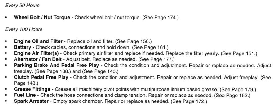

My manual doesn't say anything about engine oil until 400. I'm going to change engine oil and filter at 50. If you don't put many hours on it should you replace it yearly like all gasoline motors? This is my first diesel. It could take a couple years to get 400 hours depending on how often it's used. The manual doesn't say a time frame other than 400 hours, for example for coolant it says every 1000 hours OR 24 months. What are you all doing/ thinking on the time vs hour front for engine oil?
/ CT2025 50hr service #14
You may consider re-reading the Operation and Safety manual carefully.
In the PDFs attached above, it clearly states: Every 100 hrs, change oil & oil filter.
Every 100 hours means in addition to the recommendations @ 200, 300, 400, etc hrs.
Nope my tractors brand new and I can confirm, as I said it does not mention oil and filter change euntim the every 400 hour part. But good to know they have updated it. Thanks for replying with that
