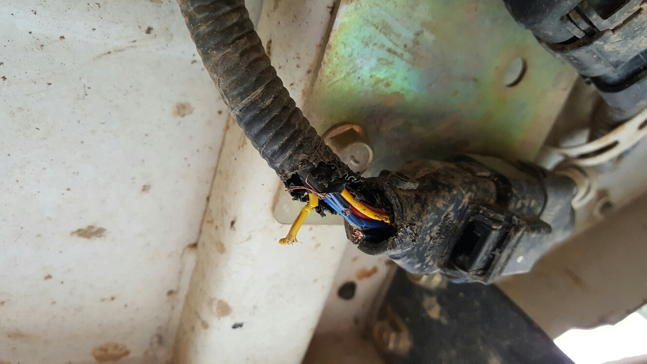

I found the issue. Went back to check voltage at the operational control unit from each safety switch. Turns out the travel pedal switch was not sending 12 volts to the control unit. Took a resistance reading and in the process saw some chewed wires. Ended up having to splice 4 wires. It's all good now. I would post pictures but not sure how to do it from my phone.

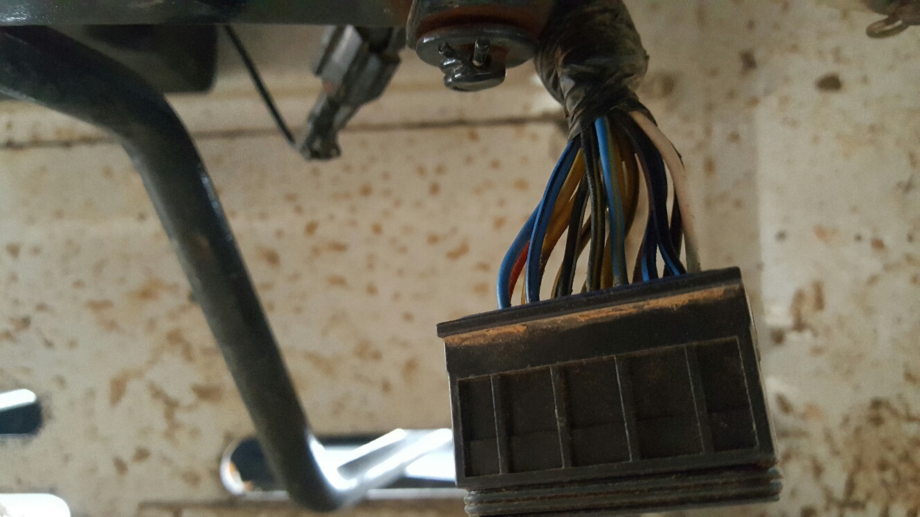

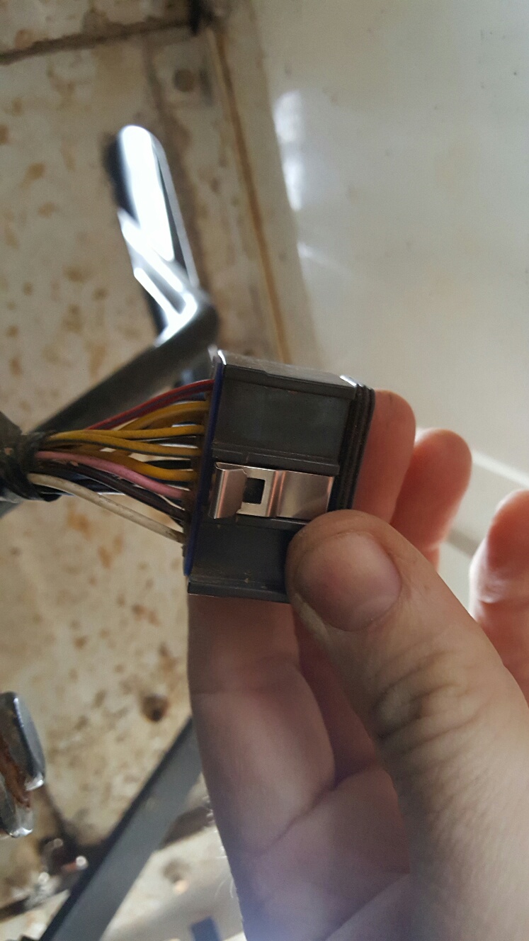

Locate the Operational control unit located under the left side of the tractor as you are sitting on the tractor. It is a black box about 4 x 4 by 1? It is mounted on the transmission casing under the seat. There is a 16-pin connector going in the bottom of the OPCU. Follow the wiring harness while under the tractor to the transmission and you will likely run into the OPCU.

Here is what I found when troubleshooting my no start condition.
