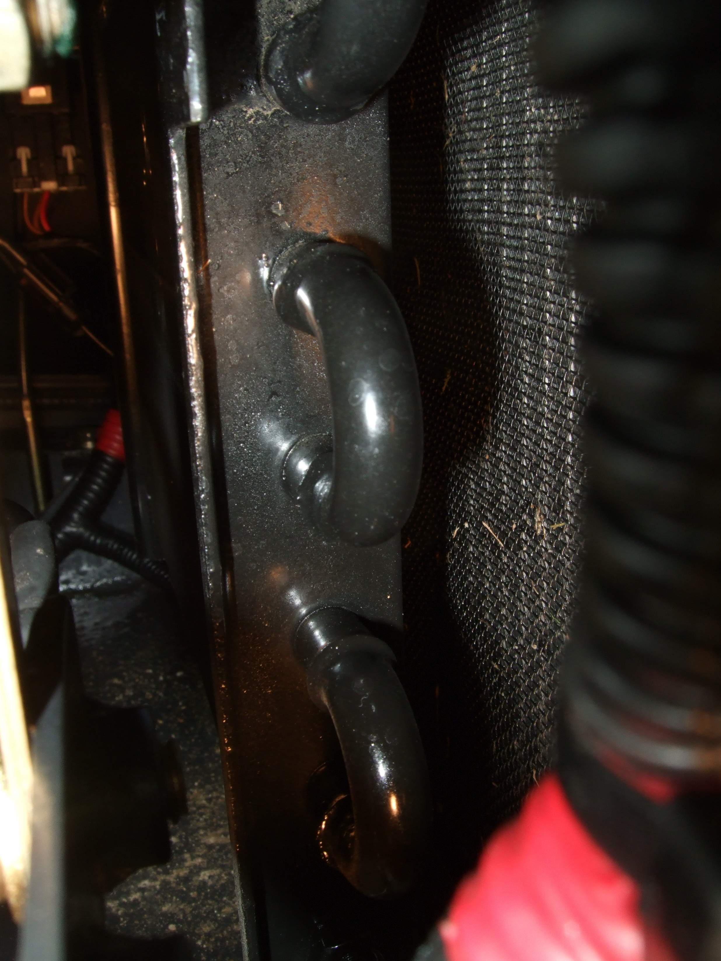

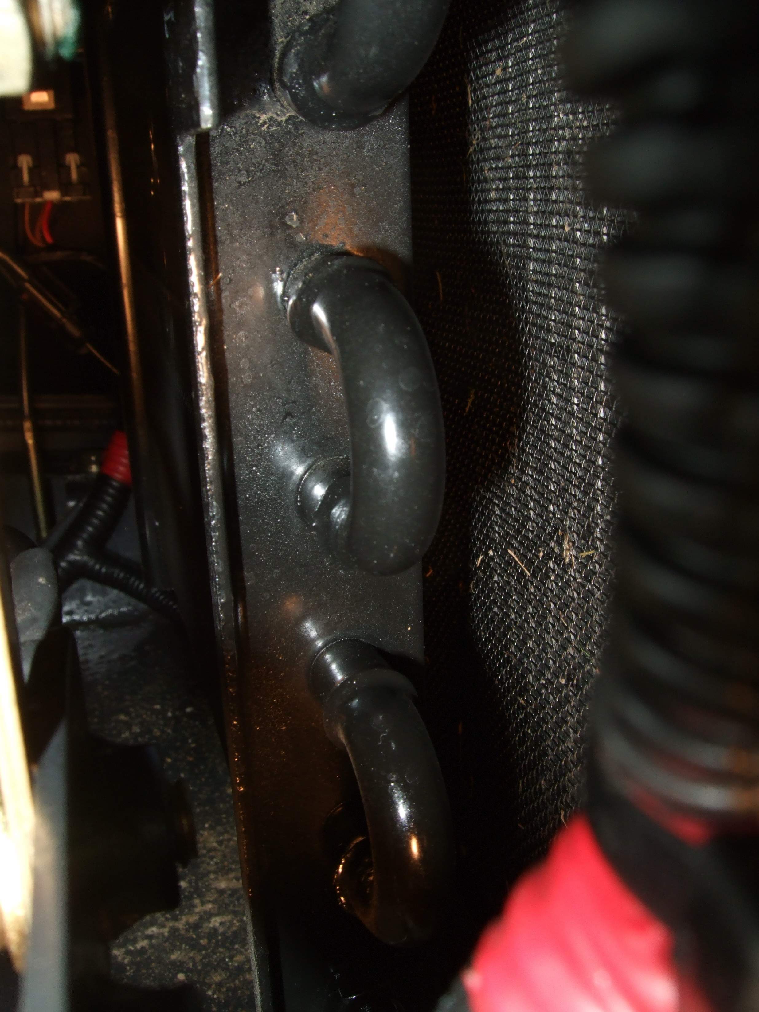

/ CT230 First Troubles #8
Would you be able to take a picture of the what you're talking about with the new cooler, would like to compare it to the one on mine.
I would, too. Let's see pix.
(Glad you got the part from the dealer, CANADA.)
#9
Here is a pic. Its not great but you can identify.
The old cooler is about 6x12 and the new is about 10x12. This is just a guess on the sizes but you can easily identify them. The new also has the loops on the end of the cooler. The old has a stacked vertical tube (kinda like an ice cream cone from Dairy Queen).
The picture shows the end loops. Hope that helps.

/ CT230 First Troubles #11

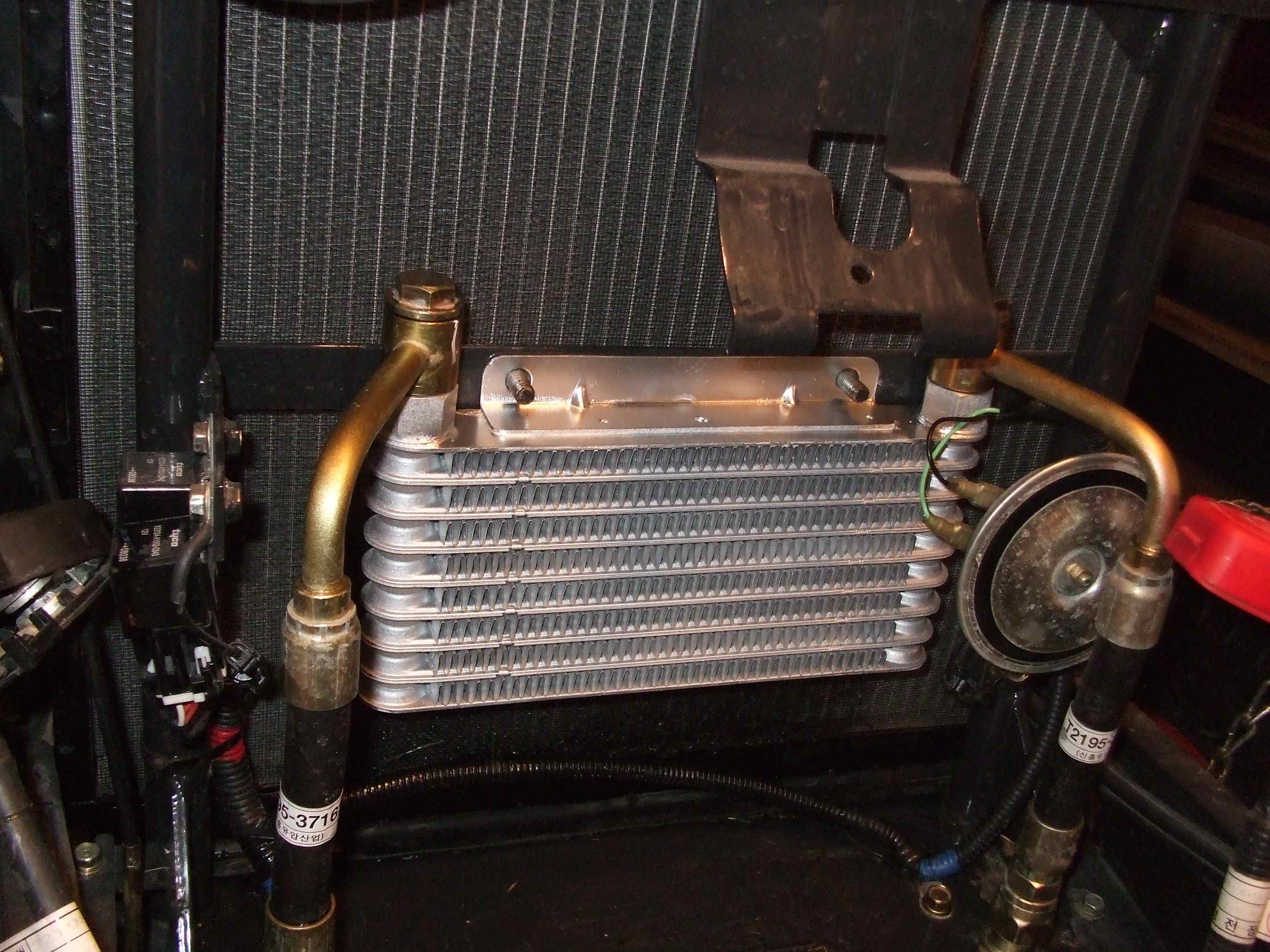

/ CT230 First Troubles #15
My replacement oil cooler looks like the original. slightly different dimensions, like 1/4 inch taller, but painted silver rather than black.
#16
That is in now way the same as my replacement cooler. Mine is much larger and of different construction.
