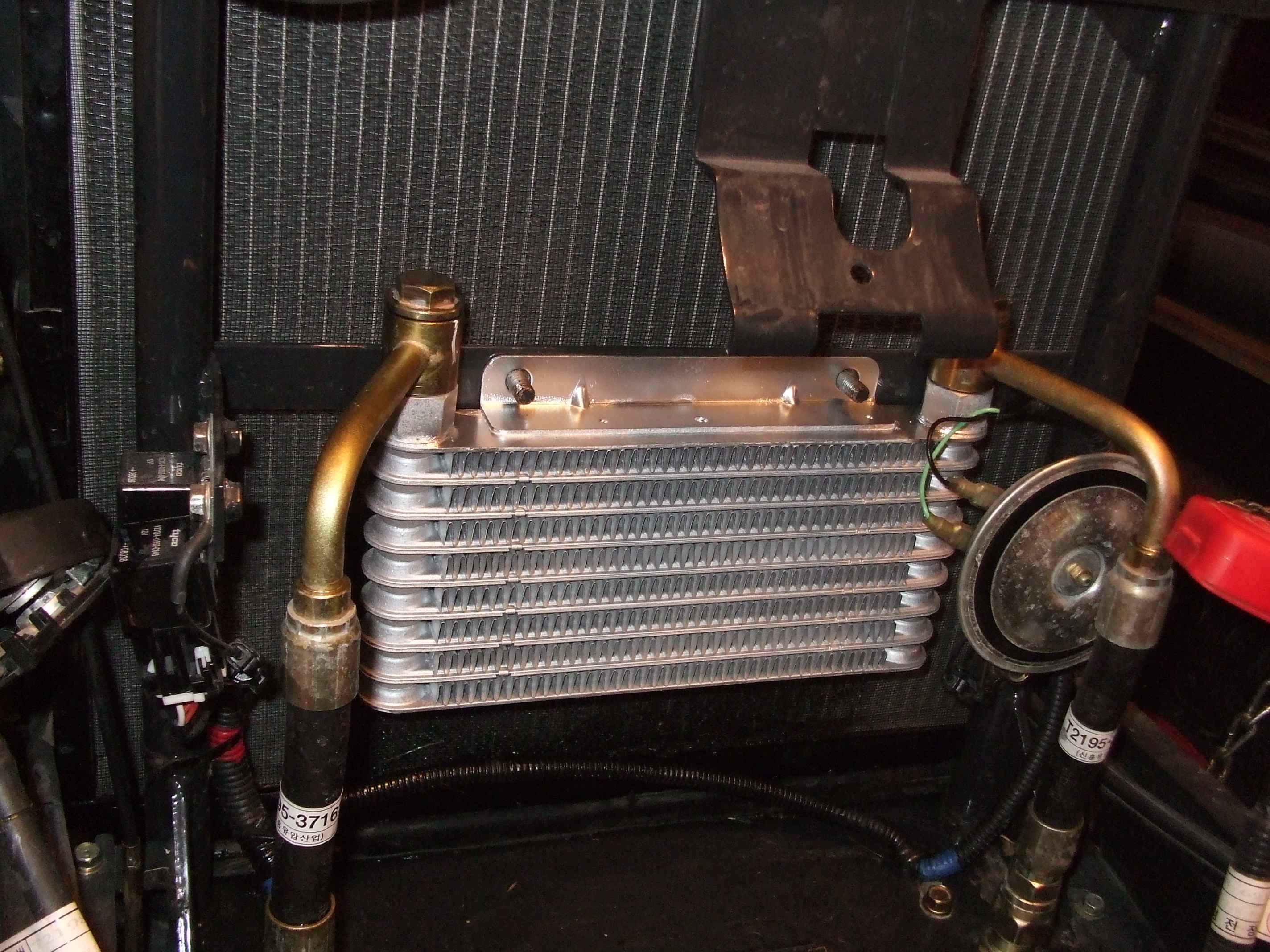

Well, I guess I've joined the bad Hyd. Oil Cooler Club. Just noticed a small puddle under my CT230. I did some investigation and found that my cooler is covered in hyd. fluid. My cooler lookes exactly like Krazsk's. It looks like it must have happened close to the time I finished pushing snow the other night because I didn't have the oil all over everything. I'd say it was about 15 degrees out night before last when I was using it.
I wonder how widespread this issue is. It is sounding to me like Bobcat knows about the problem but is resisting sending out a recall notice. If that is the case, I think that's kinda bad on their part. I will be talking to my dealer in the AM, and will post what I find out.

Don't do it!!! Don't have it shipped to the dealer!!! Changing the oil cooler is about as simple a repair as you can do. You remove the aircleaner by unhooking the rubber straps, no tools needed. You remove the battery, removing the electrical connectors from the posts and remove the 2 bolts on the bracket holding the battery in place. Now you have a clear shot at the oil cooler. See my pic. Then you remove 2 nuts (easily accessable) to remove the mounting of the oil cooler. The oil connections are 2 banjo bolts. You remove them by turning them counterclockwise :) Replace the orings on the banjo bolts if you want to be really safe. (make the dealer give you these) The oil does not spill out, except what's in the cooler if you tip it and let it drain out. Reinstall the new one by doing the above backwards. If you can drive the tractor you can easily do this.

You don't have to remove the battery.
/ CT230 First Troubles #27
Touche' But then it's hard to get a decent pic for this discussion. :)
