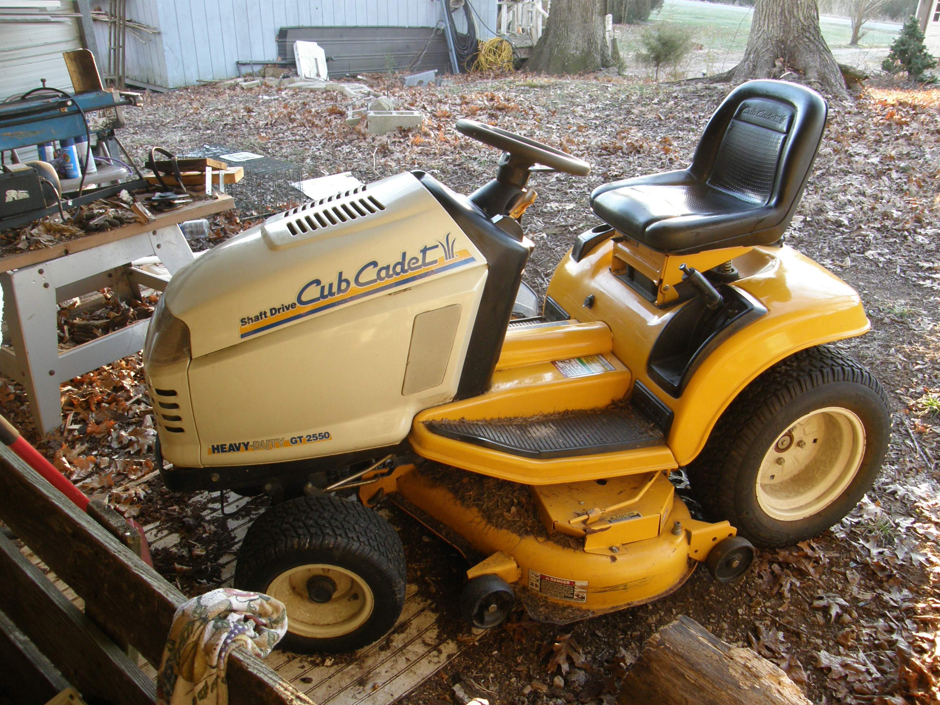

Thanks morkai, those are actually decals for a 2554. Look familiar? Lol closest I could find. Good match,just adds the shaft drive logo to the hood.

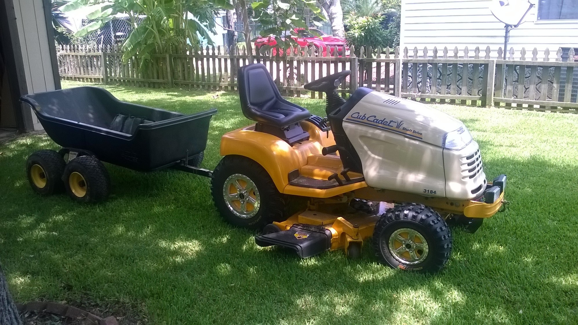

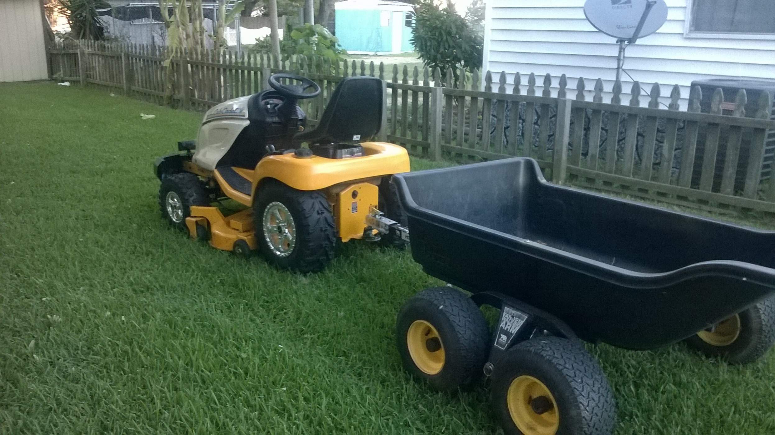

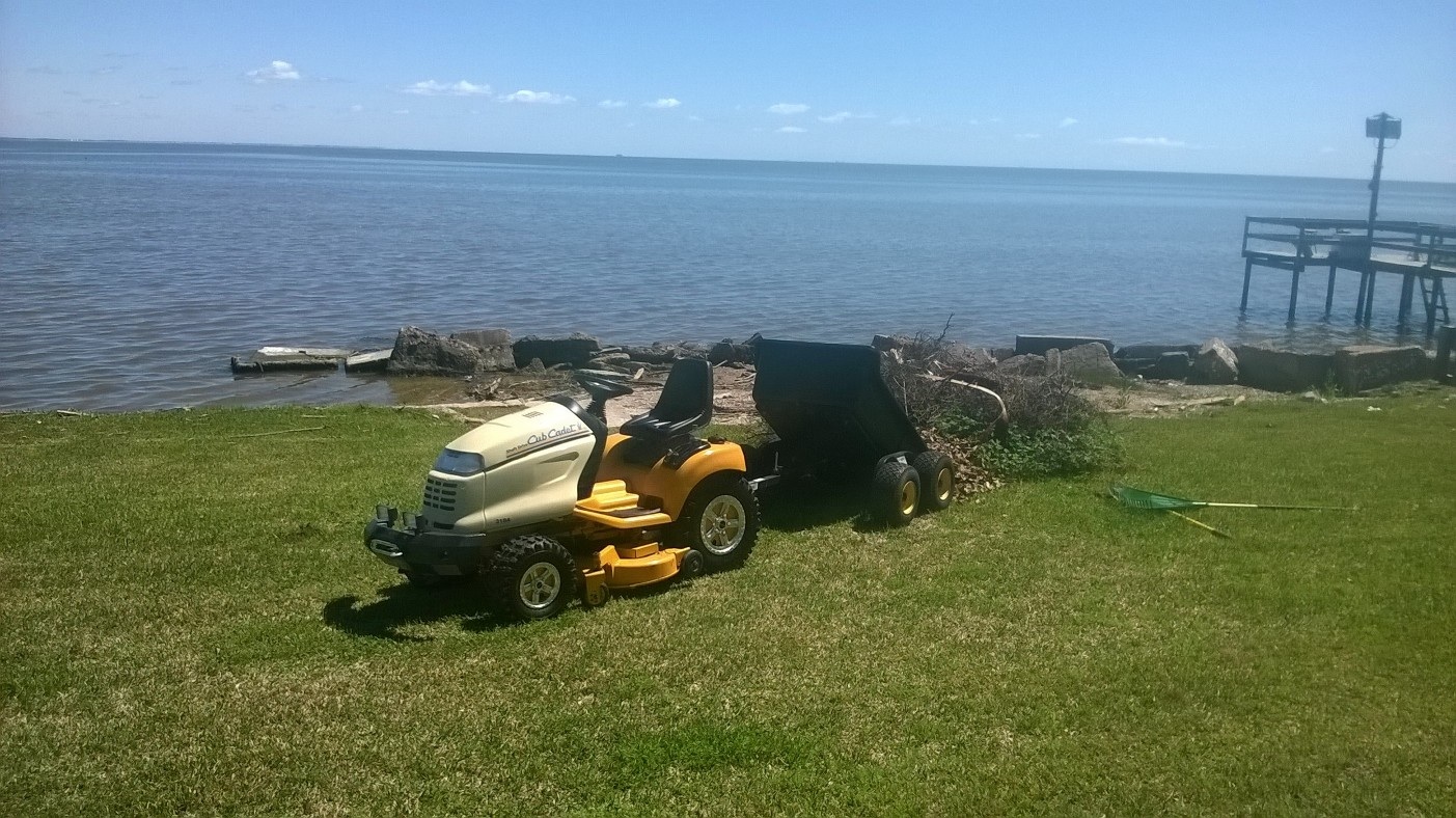

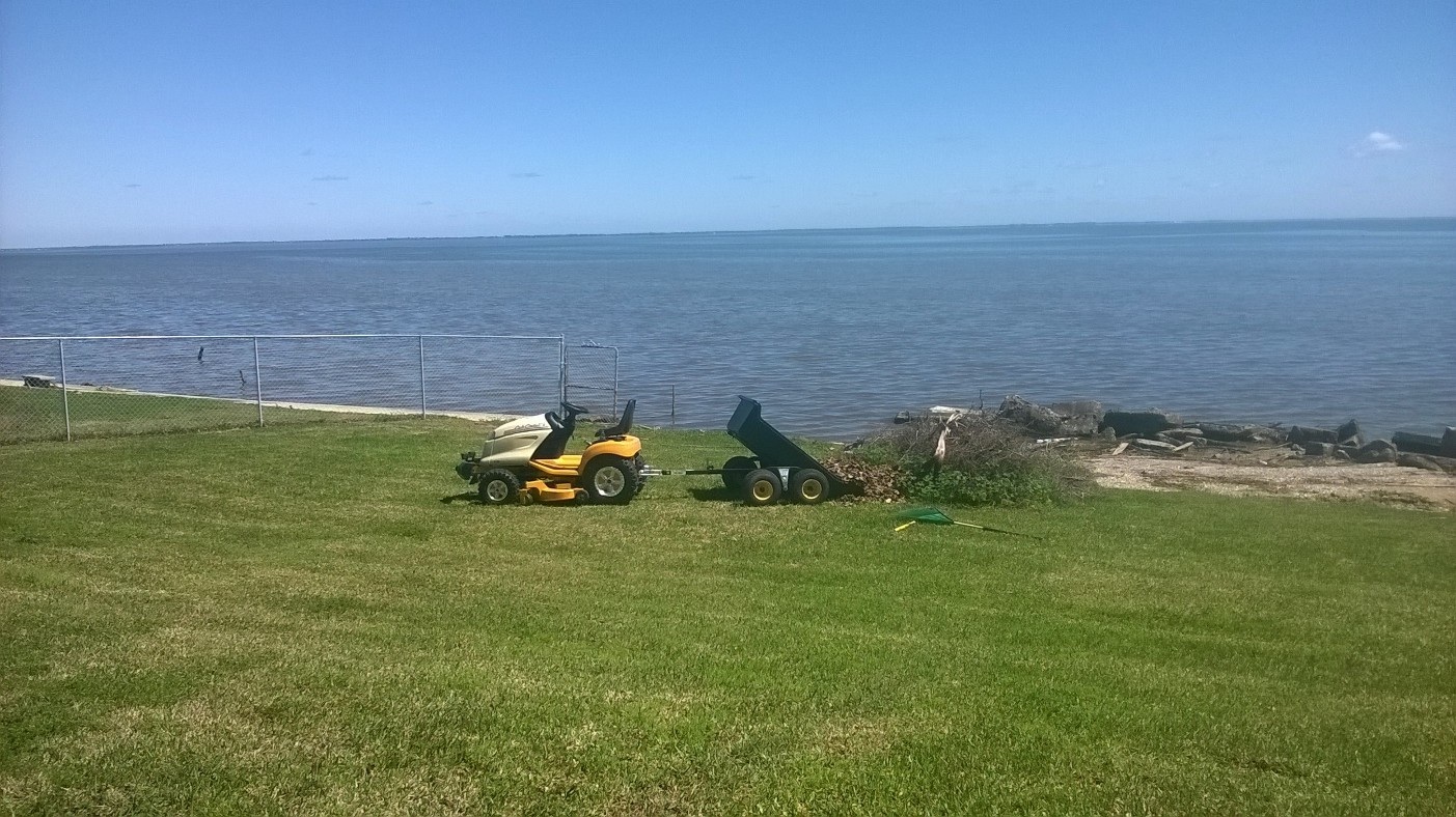

One more photo. Cuts grass perfectly even with larger tires. Slight rub against power steering cylinder when turning left sharply. I'm going to trim inside nobbies a bit. Also any suggestions on how to make it faster in reverse? Very slow. image.jpgimage.jpg
   / Cub cadet 3184 #16
One more photo. Cuts grass perfectly even with larger tires. Slight rub against power steering cylinder when turning left sharply. I'm going to trim inside nobbies a bit. Also any suggestions on how to make it faster in reverse? Very slow.View attachment 388758View attachment 388758
Hydrostatic drive linkage is a compromise between forward and reverse speeds. You can adjust it to gain reverse speed but will then lose forward speed. I adjusted mine for the minimum tolerable reverse speed to get the max forward speed. I fashioned an extension to the reverse pedal to give more travel which helped some. Picture was uploaded several years ago.
Bob B.

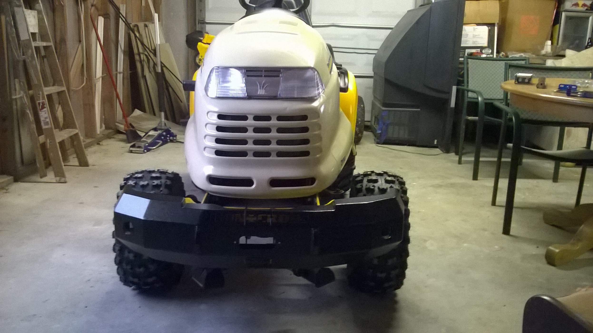

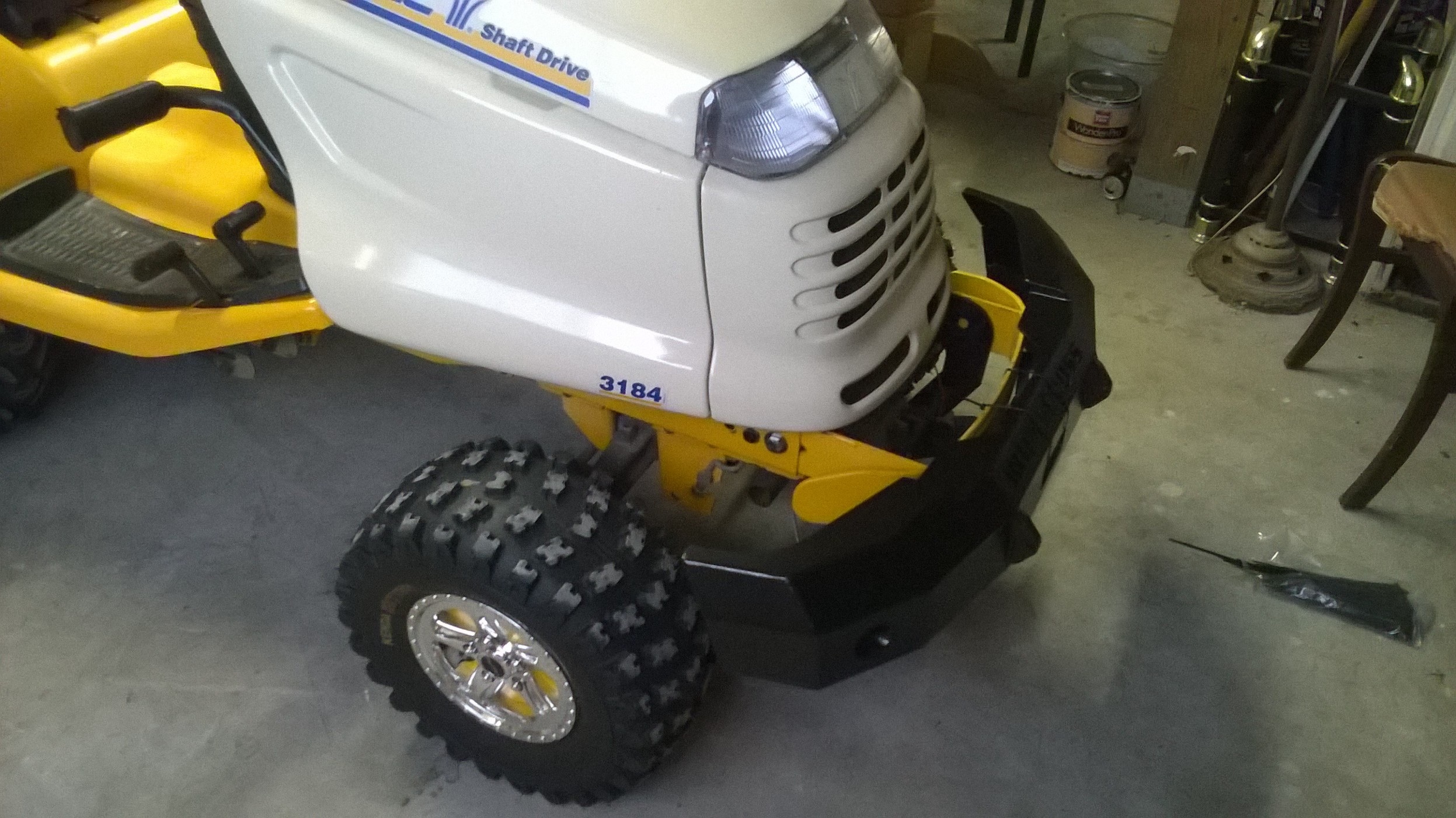

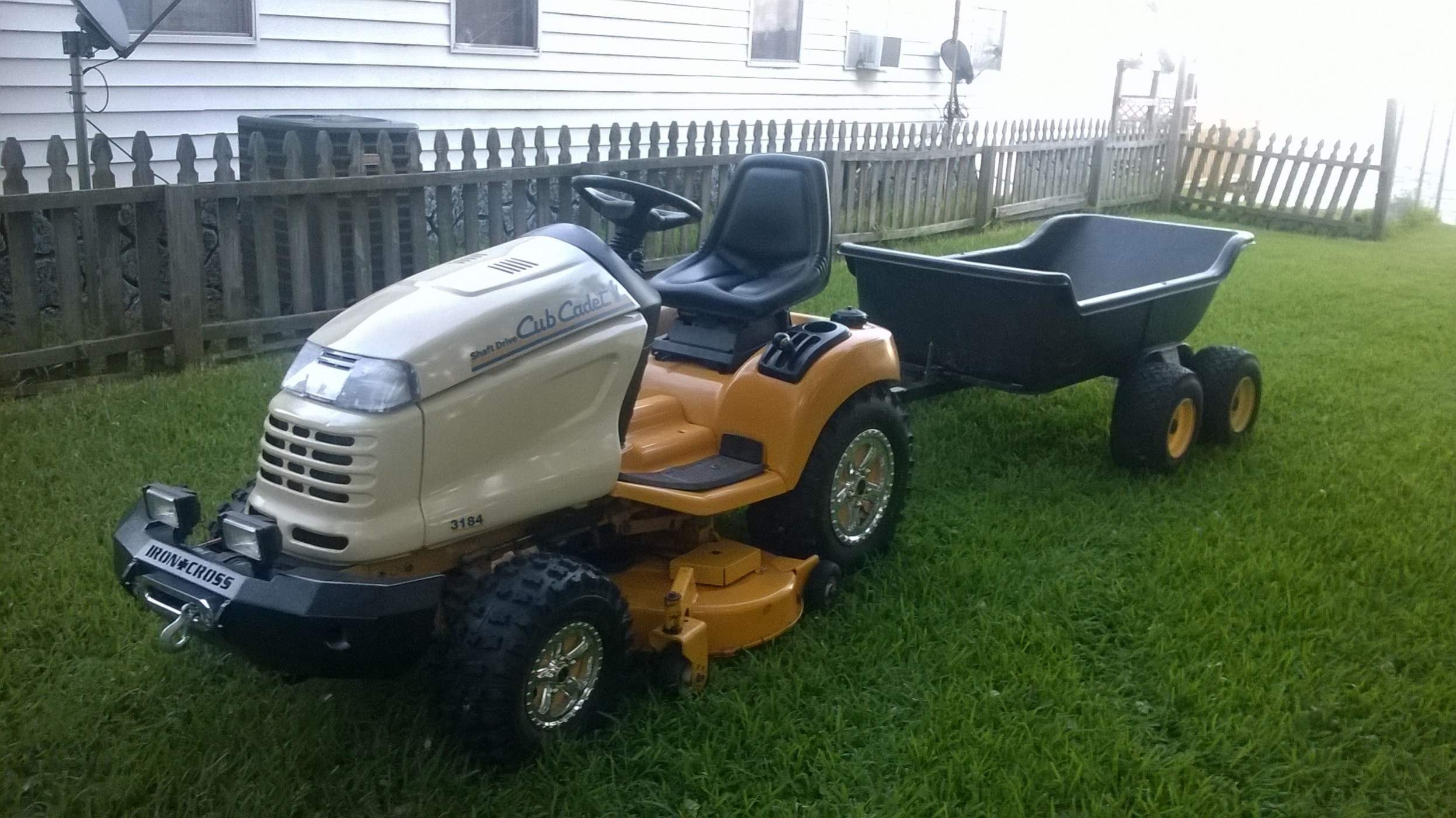

Ok, I got my hands on a rather unique front bumper. It's an iron cross display unit I picked up at a local truck accessory store.very heavy duty made from same steel as the real ones.tell me what you think...image.jpgimage.jpg
   / Cub cadet 3184 #18
Wow, great looking bumper. Love the looks of the tires, and you did an awesome job on the paint.....did you pull all the panels and do a formal spray? I've redone panels, but taped em off, sanded, and rattlecanned in place....obviously didnt look nearly that good.
Nice job!

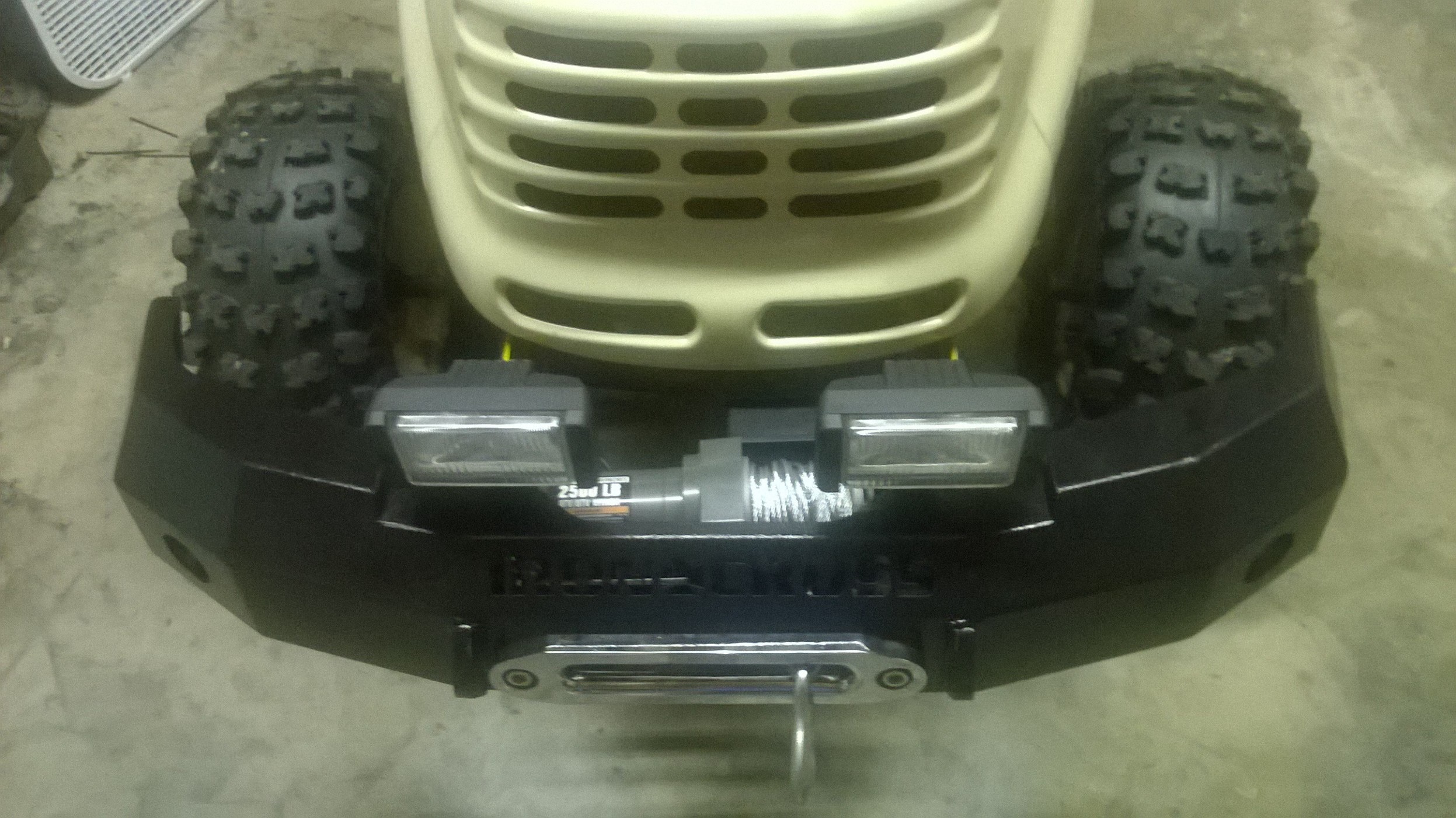

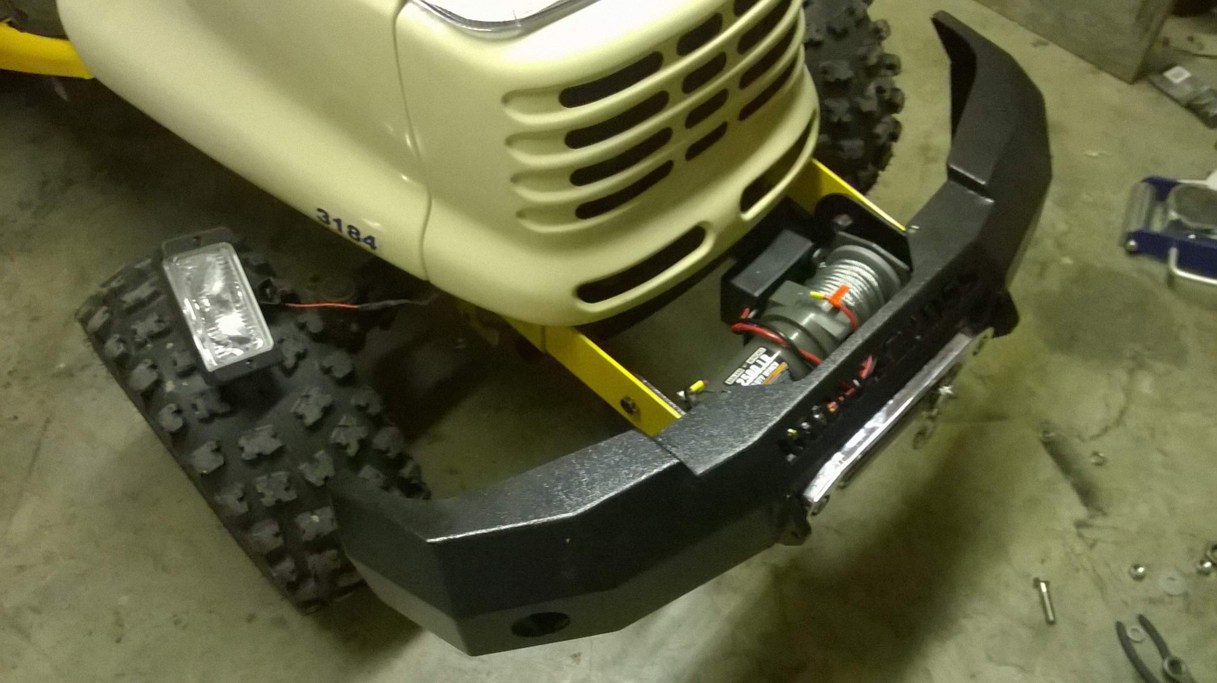

Thanks Scoutcub, all the panels including the deck were blasted and repainted at a local industrial coating shop for $300.he did a great job. Bumper was a lucky find for free. Perfect width and I fabricated a complete mount for it ( in the pic it's just setting on the original bumper.) bumper has a winch mount built in that I am installing an atv 2500 lb winch on in the next couple of days and then the winch will be covered by a diamond plate cover.

Winch mounted and wired up.image.jpgimage.jpgimage.jpgimage.jpg Now my good friends at Johns trim shop and truck accessories brought me a matching Iron cross rear bumper. Time to get the welder going.lol
