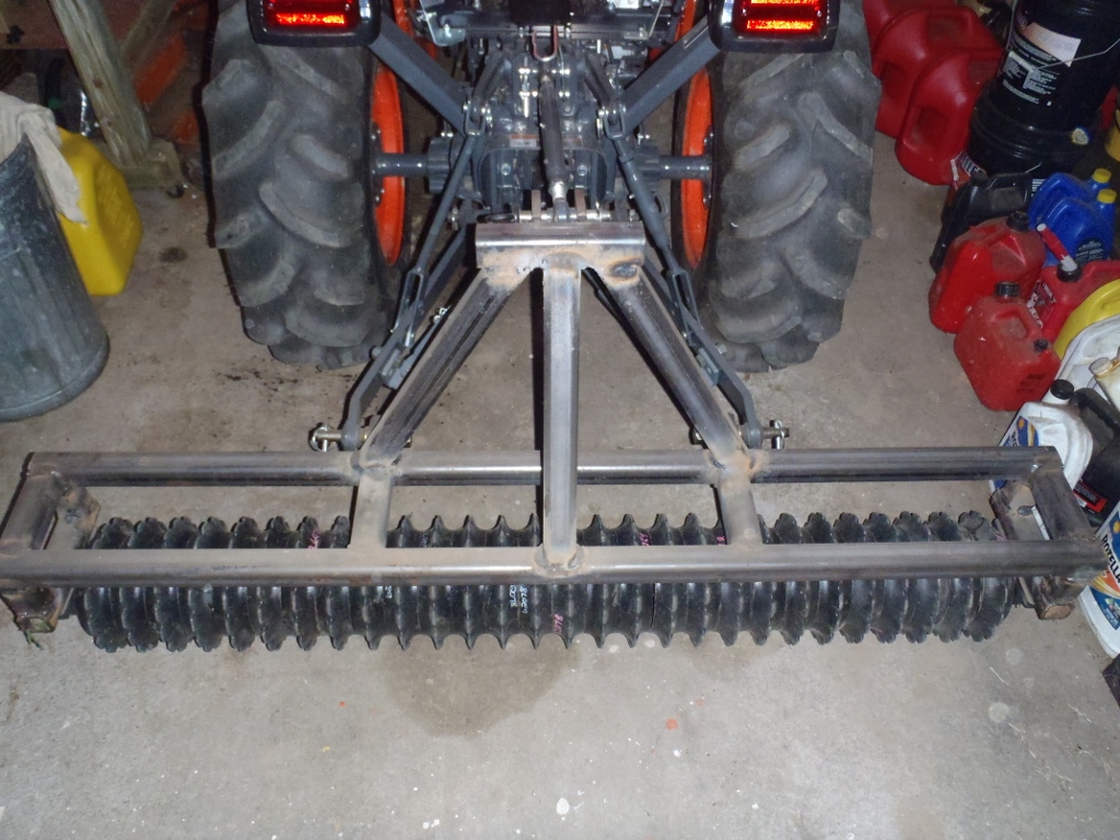

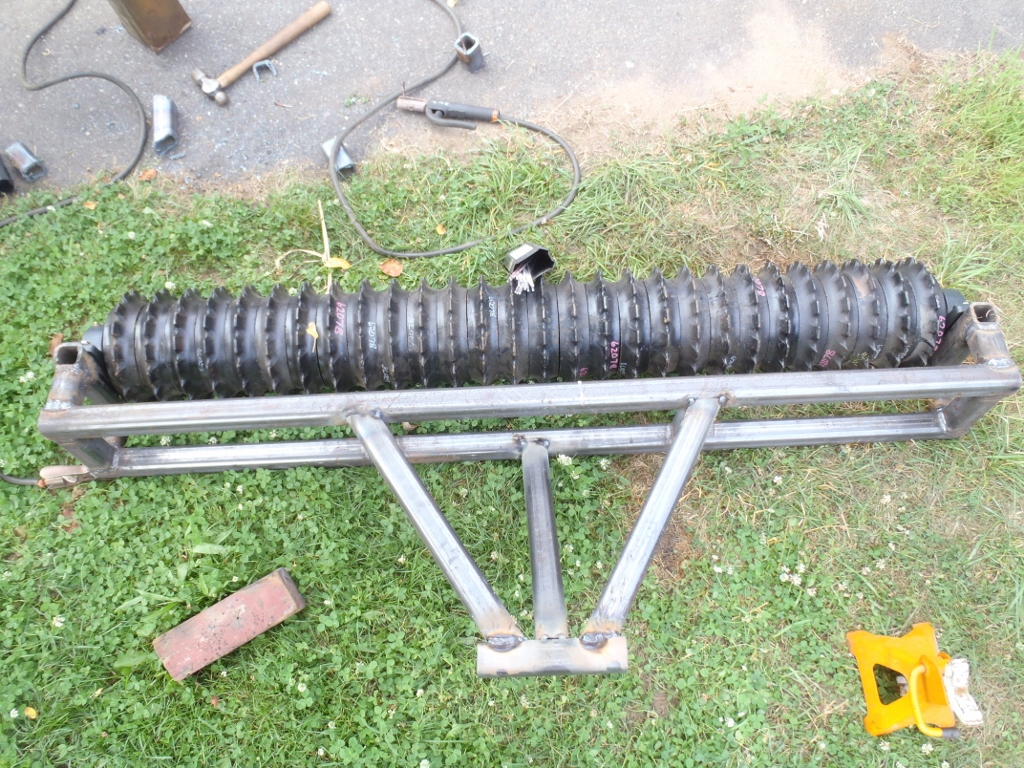

Have been working on this project on and off for several months. The Plant Manager wants to plant buckwheat in our fallow garden plots and supported my effort to get it done and out of the garage, where it's been taking up far too much space.
Welding main frame complete, axle, pillow block and wheel assembly installed.
Fit up of the hitch structure commences:
Welding the hitch structure commences:
Assembled and inspected:
The Plant Manager approves after sea trials:

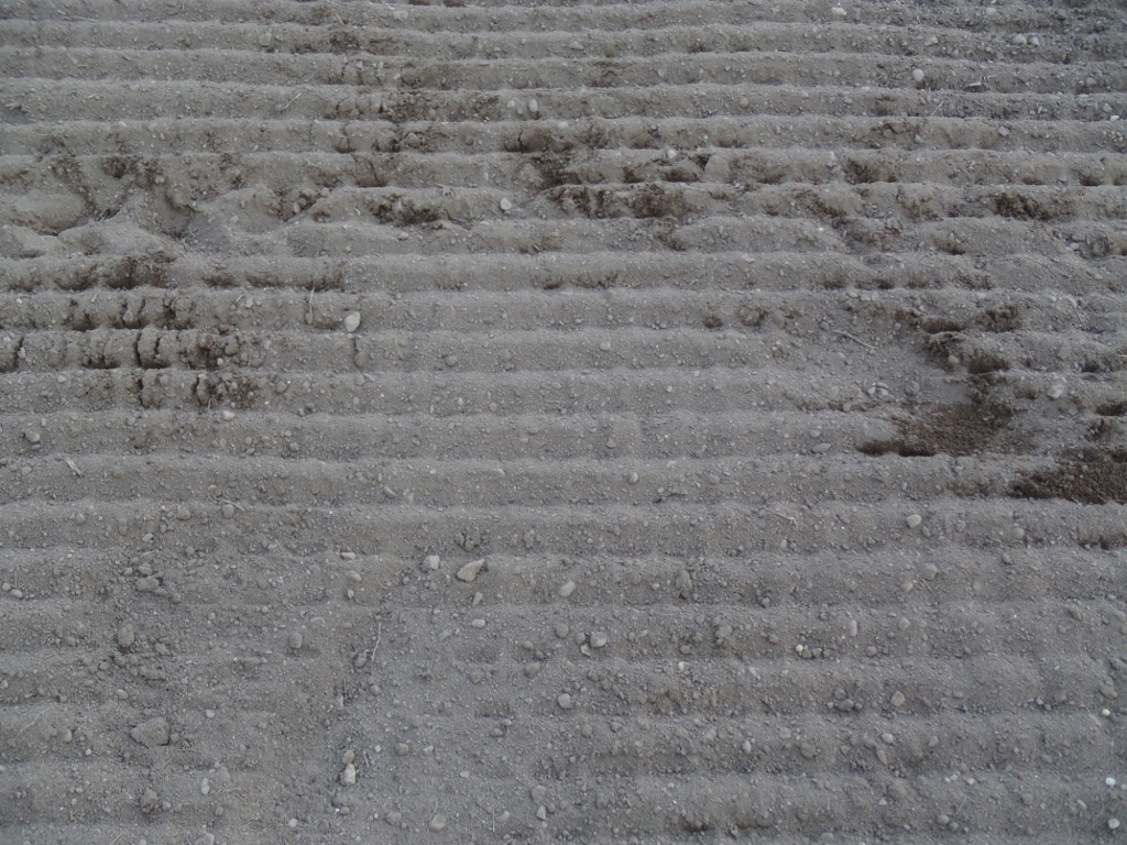

Tilled, sowed buckwheat & packed Sunday.
Got some rain Monday.
Now I wait to see how well it germinates ...

In the UK that implement would be known as a Cambridge Roller. The rollers are usually toothed as your are but sometimes they have a central raised section. The latter leave tiny furrows that seed broadcast after rolling will mostly fall into rather than the "pockets" created by the toothed rollers. No doubt there have been many arguments as to which is best for different crops.

You are right about that. If used AFTER broadcast seeding you will note that germination will occur best in the indentations created by the raised centre sections because of capillarity and better seed to soil contact. Some farmers had their own rollers cast with a cross hatch pattern for the rear press axles of their seed drills to supposedly facilitate better seed germination.
I experimented one year by setting the seeder at half seed rate and making two passes with the second pass slightly diagonal to the first. I achieved a slightly better germination rate but felt it wasn't worth the extra time and fuel. This was for a turf grass crop, and on peat soils tire track depressions are always a problem
On smaller plots one could consider this option.

Thanks! Yes, the wheels are somewhat light, thin castings. If I could have sourced affordable Brillion type wheels I would have gone that route. To make up for the lack of weight, I used 2x2x1/4" wall for the frame and a solid axle instead of pipe. I think I may add some ballast tanks to it so I can add additional weight, if need be.
