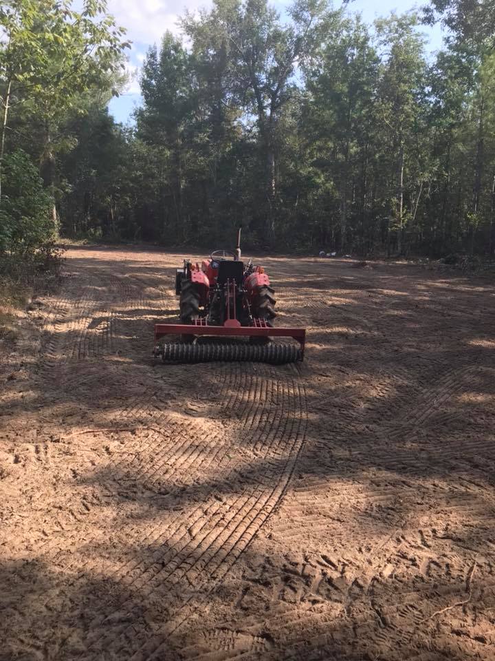

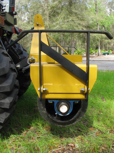

LMC/Lowery Manufacturing makes a pretty good cultipacker.
I have found my food plots do much better if I use a cultipacker compared to a chain drag.
td

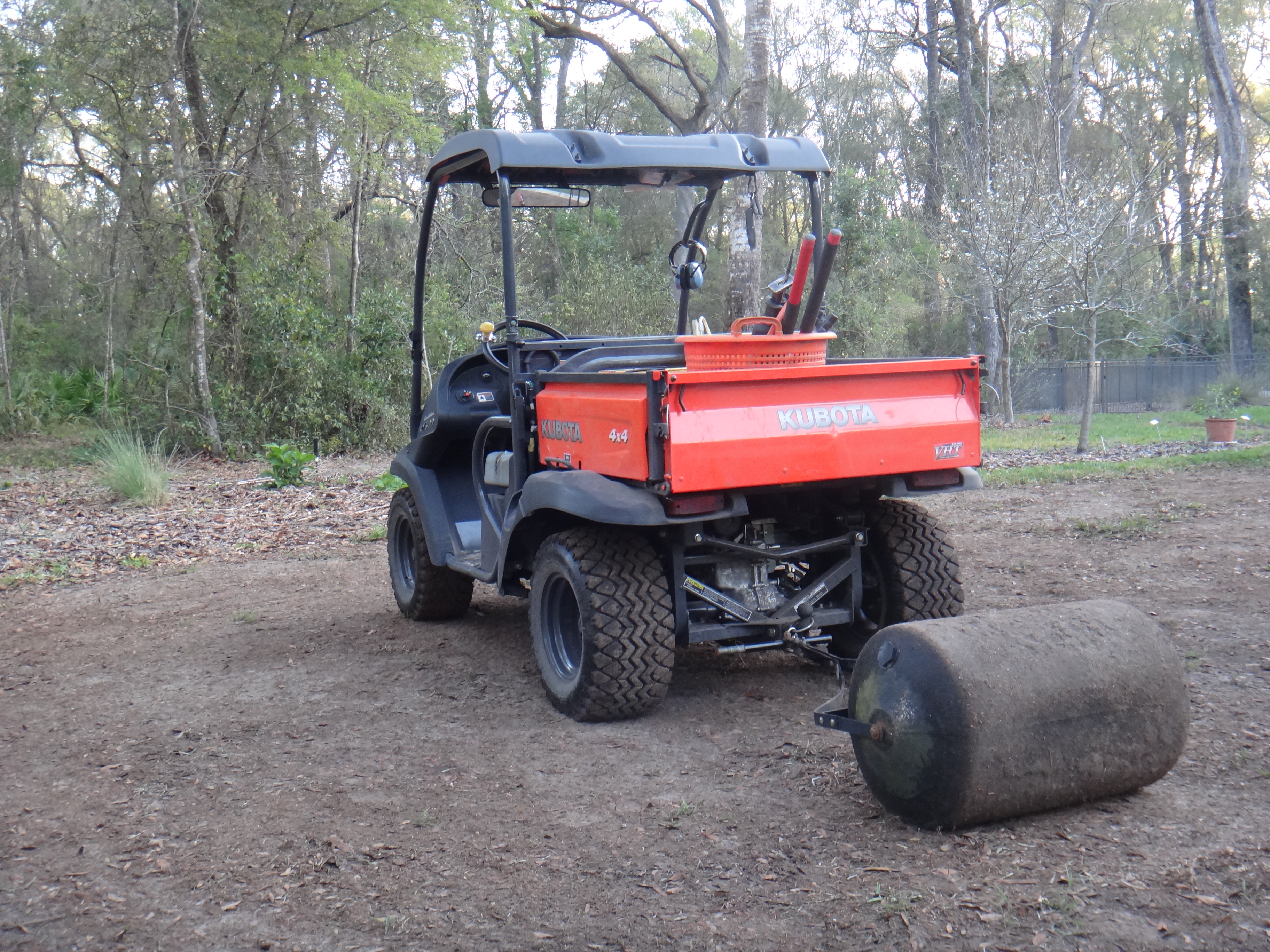

I use a 3' plastic lawn roller filled with water, weighs over 700 lbs, pulled by my Kubota with turf tires makes about a 5' swath. Really makes a difference if you plant small seed blends.
I have both an ETA Cultipacker and a plastic lawn roller. I smooth my ground every cultivation, usually with a TR3 rake. The heavy Cultipacker smooths as it rolls in the seeds and I believe it keeps the young seedlings better supplied with water.
The poly roller is satisfactory and much cheaper.
Really small seeds, like some radishes and clover, require light to germinate. Small seeds should be rolled. If you drag over small seeds so they are covered germination is reduced. Larger seeds are probably OK dragged but I have no personal experience dragging over seeds, only rolling-in experience.
