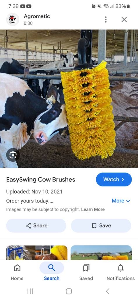

If you have access, broom tractor broom pieces, or a cattle scratcher kinda broom core, the brush parts are flexible enough to get through, but rigid enough to scour the sediment.
   / Culvert cleaning #25
Something like this, and a winch or strap on am ATV? It might take multiple/many passes, but it should eventually leave it pretty good, except hardened clay sediment. That would need to be done when wet
   / Culvert cleaning #26
Something like this, and a winch or strap on am ATV? It might take multiple/many passes, but it should eventually leave it pretty good, except hardened clay sediment. That would need to be done when wetView attachment 2025941
I had been thinking of finding and cutting down an old rotary brush that you usually see used during road construction, but dang Amazon has cattle brushes of multiple diameters for very affordable prices... they just need a solid core of appropriate size to bolt to and attach a eye on. Again thanks what seems like a perfect solution!!
