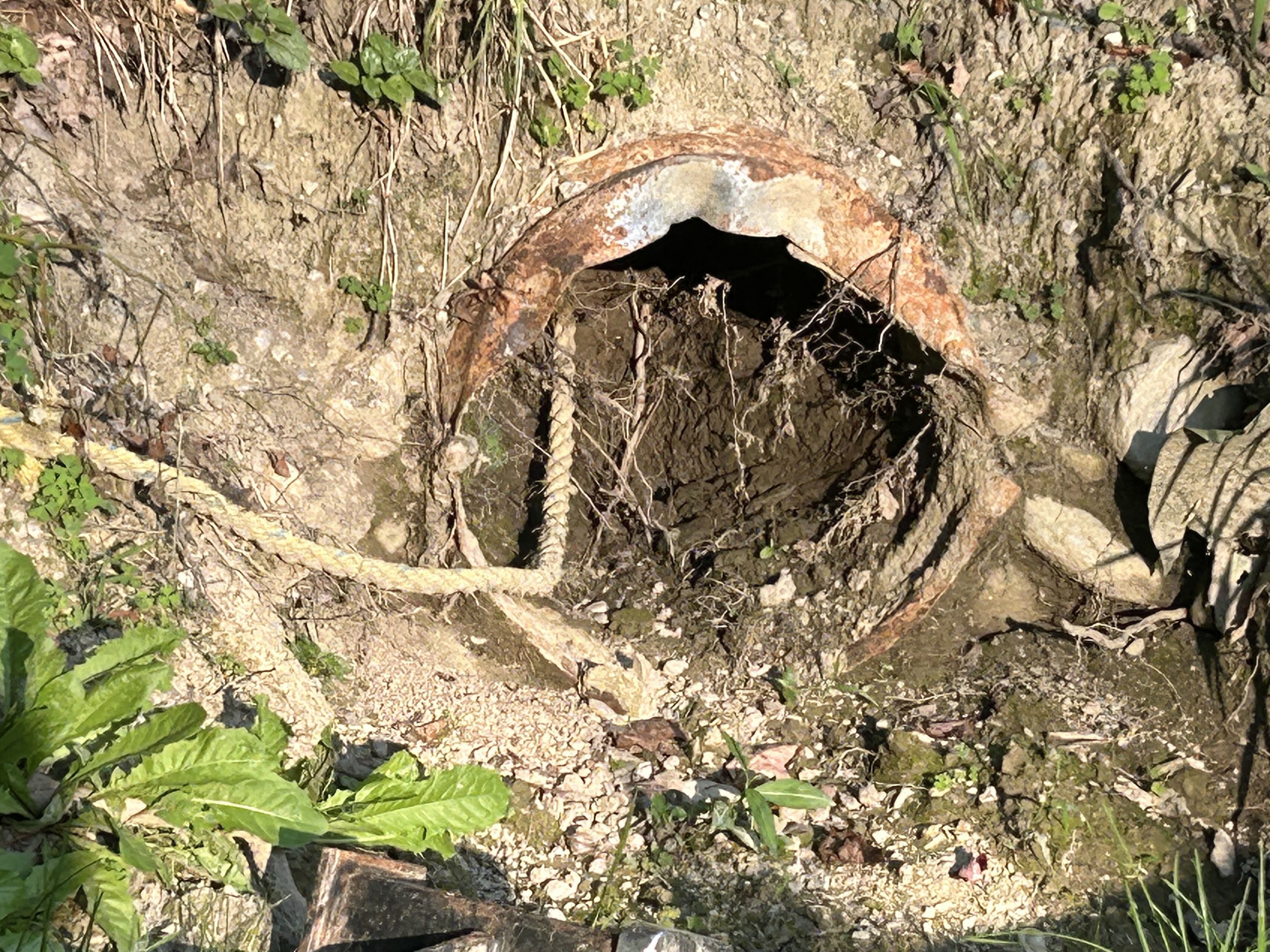

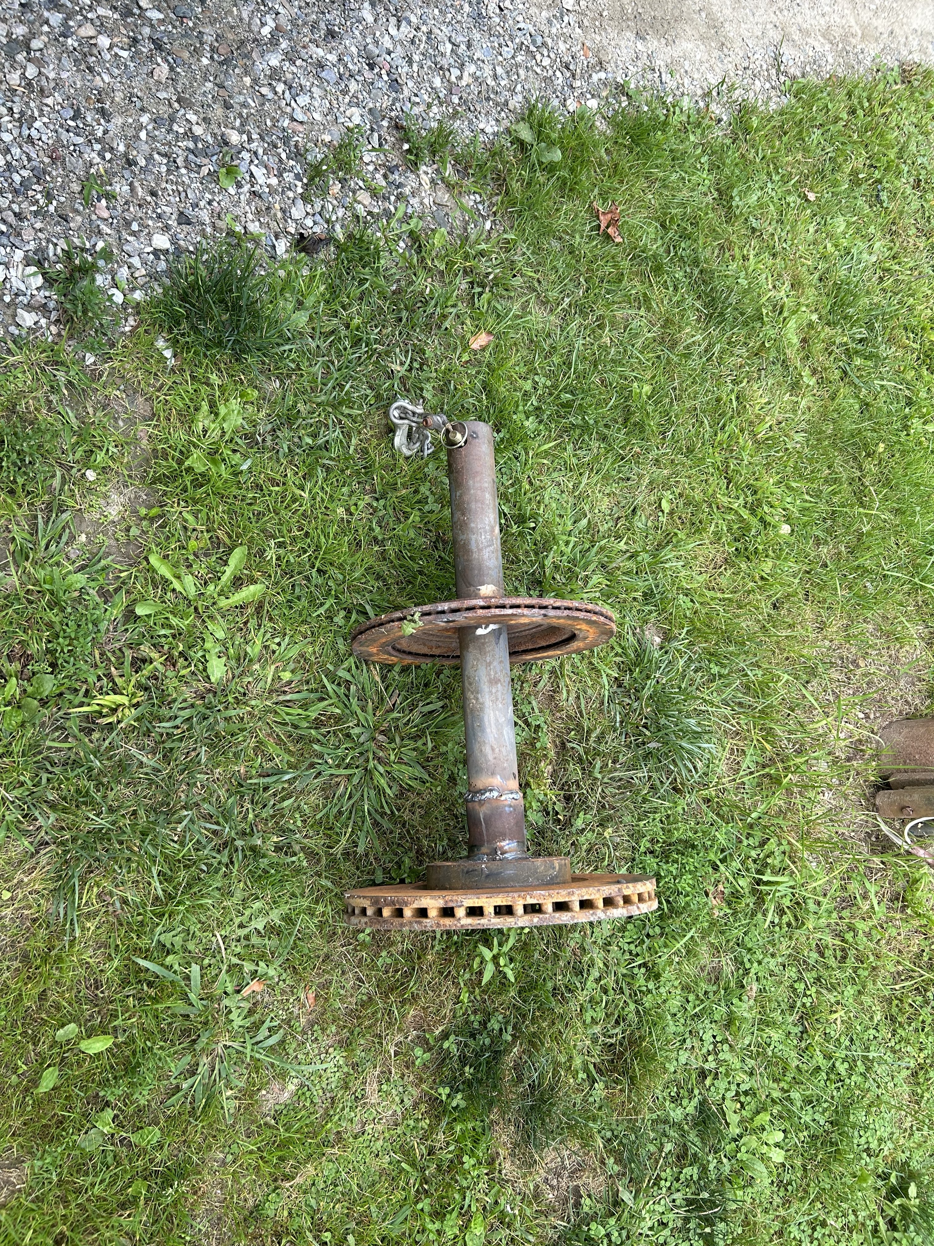

Due to some extreme rain with flooding I have some 16” culverts that need to be cleaned out. They are full of debris and a lot of fine sand a gravel. I tried the trick of pulling a tire through the culvert with limited success. The tire cleared the debris put little of the sand and gravel. From my days of being a electrician I remember using conduit plugs “mice” to fish pulling ropes and cleaning out electrical conduit. So I made a plug out of two 14” dia. disk brake rotors I haven’t tried it yet and was wondering if anybody thinks it’s going to work and maybe some suggestions to make better.

I suspect it will probably work, but maybe work too well. Looking at your 2nd picture I suspect that it could collect enough material that you could not pull it all the way through which would plug it up permanently. Maybe you could get your local fire department to flush some of that debris out with a fire hose??
/ Culvert cleaning #3
I’d be surprised if that clog slides out of the culvert but without much to loose you might as well try. Maybe attach a second chain on the back so you have some chance of pulling it backwards if it gets stuck.

The material in the pipe doesn't look "flowable" (it's dry) and I think that's going to cause trouble.
Like 4570 said, put a chain on the backside to reverse it if necessary but maybe a graduated approach like
pulling a length of 4x4 through, then a 6x6, then maybe your rotor rig or something along this thinking.

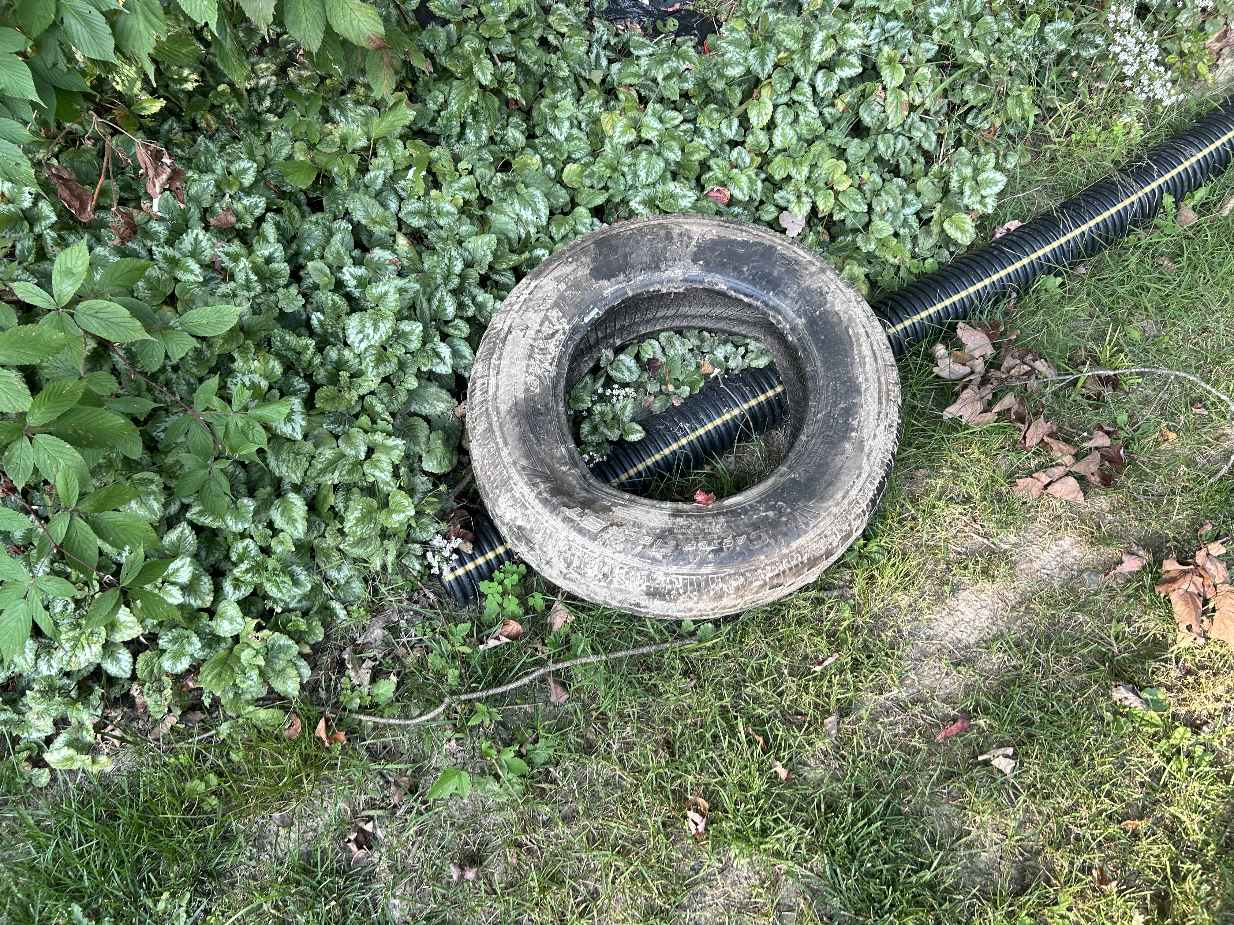

I did get a tire through the culvert without any problem using a chain and a tagline rope. The tire just wouldn’t clear the sand and gravel

The drums will most likely do the trick I would pull the tire with the drums tied on the end and pull both a the same time.

I welded two disk brake rotors on a piece of pipe and then pulled through the culvert a couple times to clean the culvert out

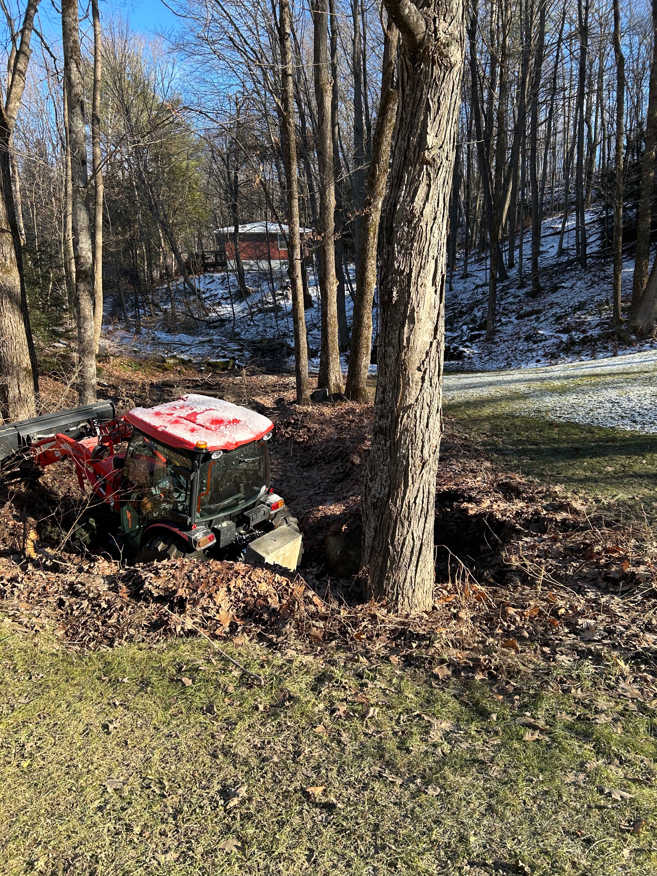

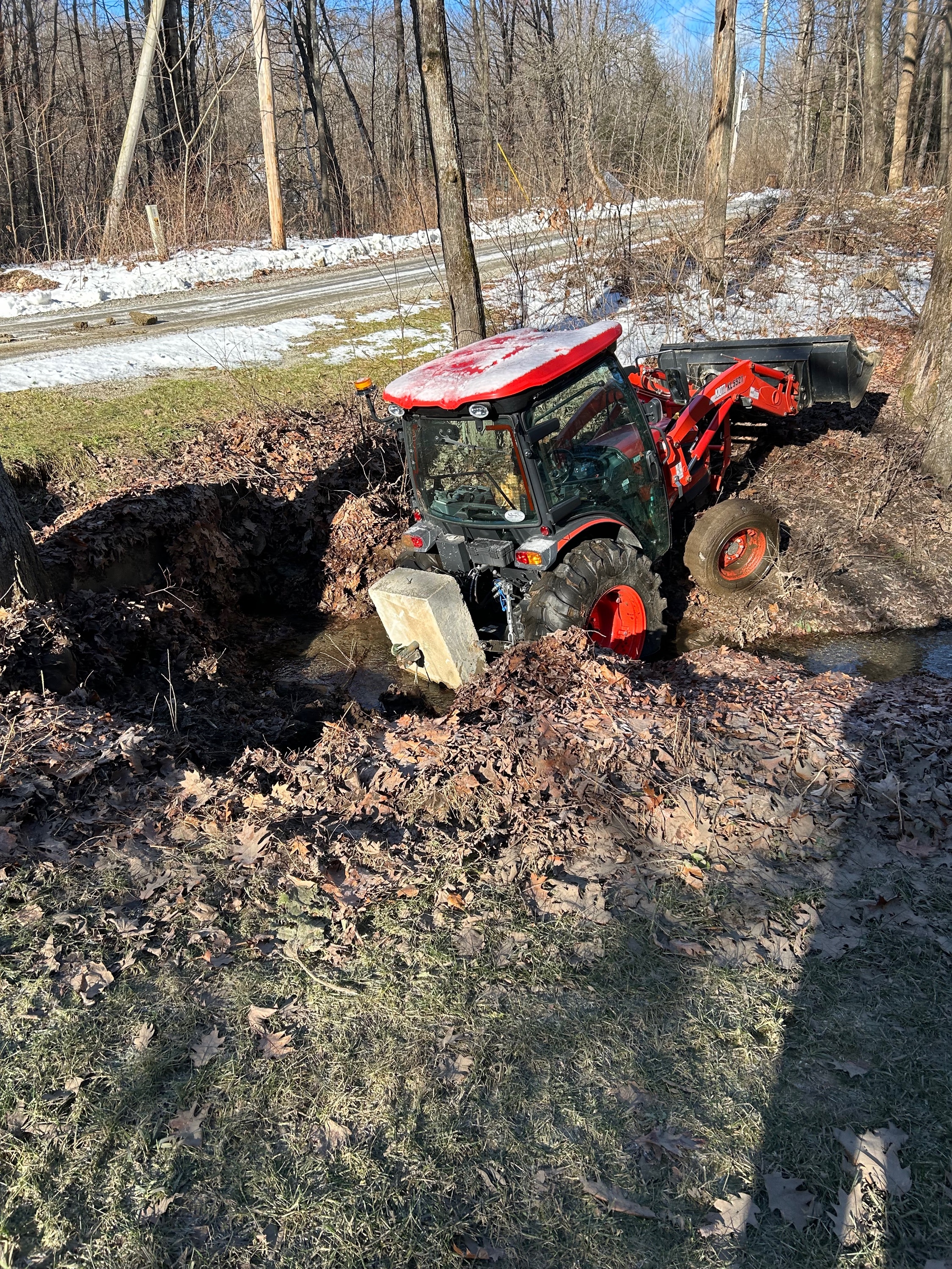

Working on the plugged culvert problem again. Boy did I eat an extra big bowel of stupid “O”s for breakfast today. Got the tractor stuck trying to clear the problem culvert. Just cannot win sometimes.

Ooof! Sorry to hear/see about getting the tractor stuck - have you been able to get unstuck yet?
Your thread perked my interest as I have a similar issue going on with the dry drainage culverts that run under my shop road. - The tire+chain trick pretty easily clears leaves and debris, but does absolutely nothing to clear the sand/clay that settles in the corrugated drainage running under the road.
Were you able to get a sense of whether the rotator plug you made had any impact on the silt in your drains?
I tried something similar after watching videos of how test plugs and various cleaning balls are pulled/blown through piping in various industries. Where you used a metal rotor I bolted together several 1.5" thick plywood discs that were smaller than the diameter of the pipe and then attached two 1/4" angle iron "blades" running perpendicular to each other that were ever so slightly smaller than the pipe diameter. The hope being that the angle iron would dig/scarify/loosen the sediment build-up and that the plywood pucks would catch & pull that loose material through the pipe.
At least in my application there's apparently more finesse to designing a drain cleaning system than I am aware of. I spent about two days after a decent rain event fiddling with this experiment and ended up bending a lot of 1/4" angle and breaking a good number of 1.5" discs. I finally stopped messing with it because I couldn't find the sweet spot in terms of configuration for the heavy clay/sand sediment in my drain pipes:
It felt like either my cleaning plug was too small OR if it was big enough to pull some material out I was running the very high risk of getting the plug permanently wedged in the pipe or damaging the pipe.
On my last attempt the eyebolt on the plug came open and I spent a good 2 hours using a rock bar, hoe and trench shovel to clear the debris that built up in front of the plug so that I could pull the plug out of the pipe. I am aware I could try again using a forged eyebolt, but without better design ideas, it felt like I was working at the very limits of my little bx2360....although that was before I loaded the tires on the tractor.
