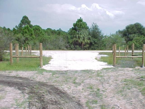

I used about 3 - 18 yard truck loads for the culvert cover and the fist part of the driveway. My gate is about 60' from the road, and the driveway at that point is about 16' wide. I could still use another load or two to grade it properly all the way to the gate. Cost was $130/load.
The attached picture is before I added the dirt over the ends of the culvert and dressed it up.
Since I bought my dump trailer, and because the shell pit is only about 3 miles from my property, I'll be bringing in the rest of the shell rock myself, about 4 yards at a time -- I need about 300 more yards to do the driveway -- it will be a long project. /forums/images/graemlins/shocked.gif
