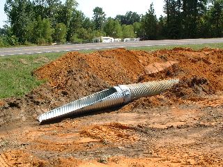

I wanted to add a driveway to my property along a State Highway. I went to the TXDOT office and asked what was required. The next day a guy came to my place, looked over the spot, told me I needed a 24 inch culvert of any material I wanted, that was 40 feet long with tapered ends.
That same week an add in the Thrifty Nickel listed a used 40 foot, 24 inch tinhorn for sale for $350. It looked good and I offerd $300 if he'd deliver it.
I had some concrete ends that the TXDOT guy said were fine just lying around that fit just right.
While installing everything, and about a month after getting the permit, a different TXDOT guy stops by and asks me what am I doing. I show him my permit. He said that guy retired and he's in charge now and my ends are illegal. No more concrete ends, too dangerous. I have to use metal ends.
Thats that, so I dig up the concrete ends that didn't cost a dime and buy metal ones with straps for $290.
The new TXDOT guy is happy and I have my driveway.

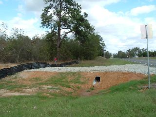

For now I just put some limestone of top until I'm ready to pave. I used red clay for fill.
Good Luck,
Eddie Walker
