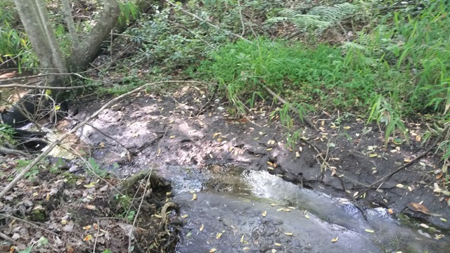

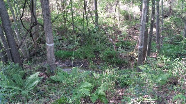

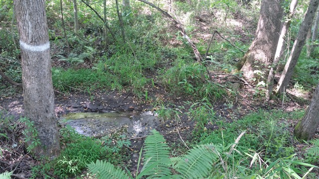

Hello Everyone!
The wife and I are getting ready to have a culvert installed across a creek on our property. We originally were looking at double wall HDPE plastic, but a guy we know out here happens to have two sections of 36" x 8' concrete culverts that he is willing to sell to us for about $140. The culverts look to be in great condition. The two together will give us about a 16' crossing.
The HDPE (plastic) pipe would have been one piece and 20' long, but would be significantly more expensive. We have a guy that can load and transport the concrete culverts to our property for a very reasonable price.
What do y'all think? Go with the concrete, or opt for the HDPE?
Thanks in advance
Justin

Only 16' of concrete culverts isnt gonna leave you a 16' opening. At least not unless you pour concrete around the ends or come up with some other kind of retaining wall. With ~2' or so of dirt on top of the culverts, you are gonna loose about 3' each side from the bottom of the culvert to the flat of the crossing. So your actual crossing will me more like 10' wide. If just for tractors, ATV's or foot traffic that is probably fine. But for full sized vehicles, that wont seem very wide of a crossing.
And are you sure 36" is large enough? Any pics of the area?

I share LD1's concerns about the width. But then, we haven't saw the site nor heard how deep you are burying the culvert??
My next concern would be setting the concrete culvert. What's your plan for that?? I have no idea what 8' of 36" concrete culvert would weigh?? Lastly, you'll have to create a very solid platform to lay it on to keep it joined and filling the hole will be critical.
The plastic is wayyyyyyyyy easier to deal with. And the cost will seem irrelevant next year.
Only down side to the plastic is burning. Again, not sure of the surroundings but if it's grassland that you frequently burn you'll hafta babysit around the ends while burning so you don't get it on fire. Otherwise it's extremely durable and you'll never have to mess with it again.

3' loss os over 5' height, assuming its 2' burried. Thats slightly steeper than about a 60 degree angle. It could easily be more than that with erosion. Depends on what the fill is.
I agree, go plastic. ITs longer to start with. And you can handle it easy. With the cost of moving and setting, plastic will probably be cheaper in the long run.

That helps. But understand LD1's point. You can't get the dirt fill to stand vertically. So with that 1' of fill over the top of a 3' culvert you now have 4' of fill to hold in place. Being a total optimist you are going to lose 3' on each end. Now you have a 10' drive.
