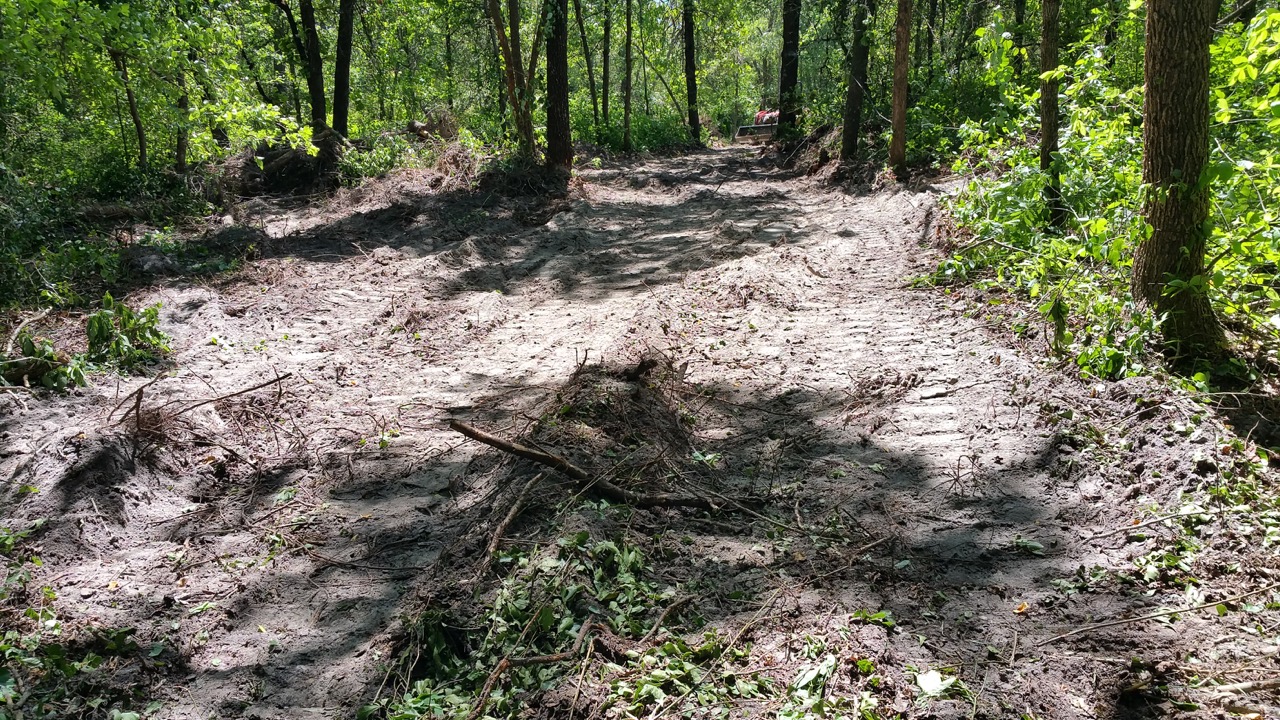

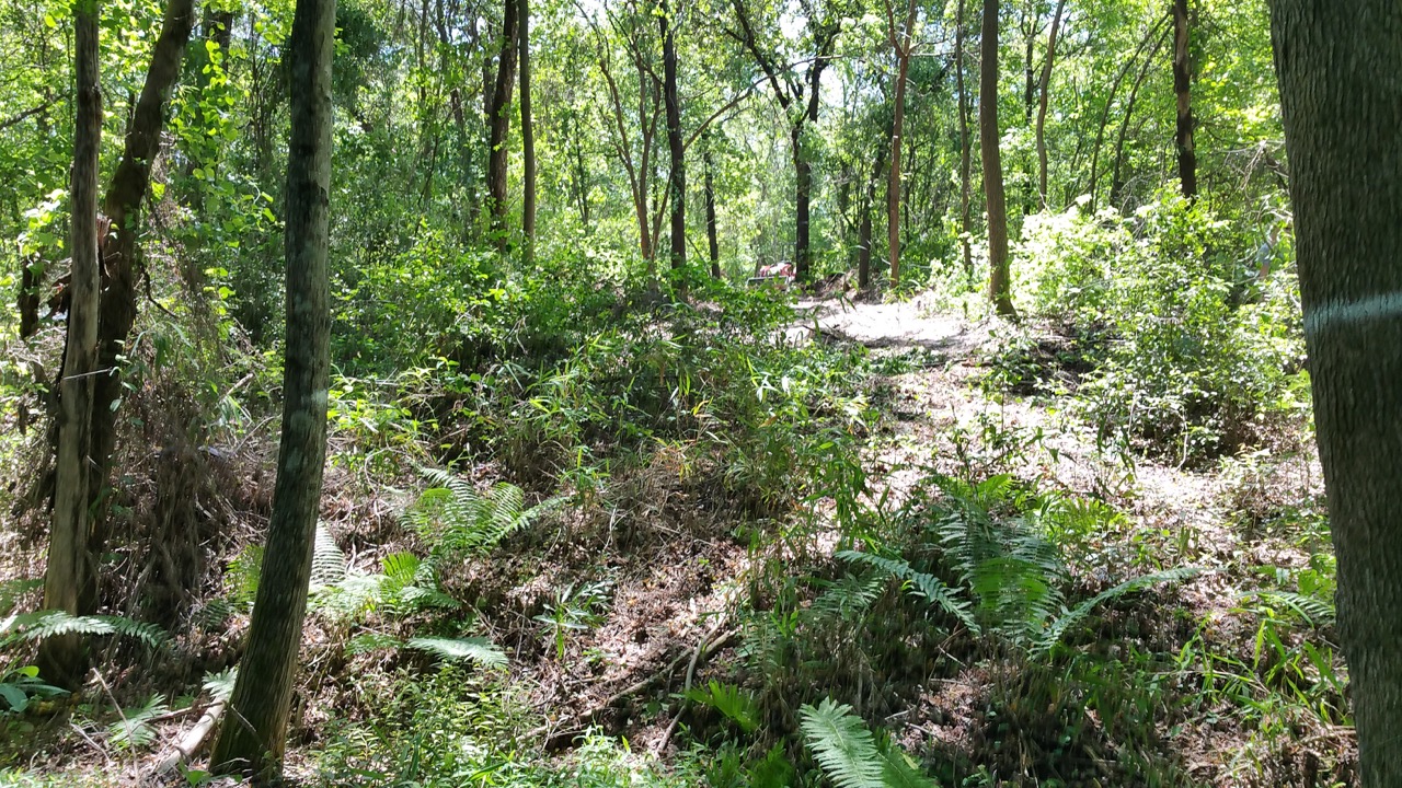

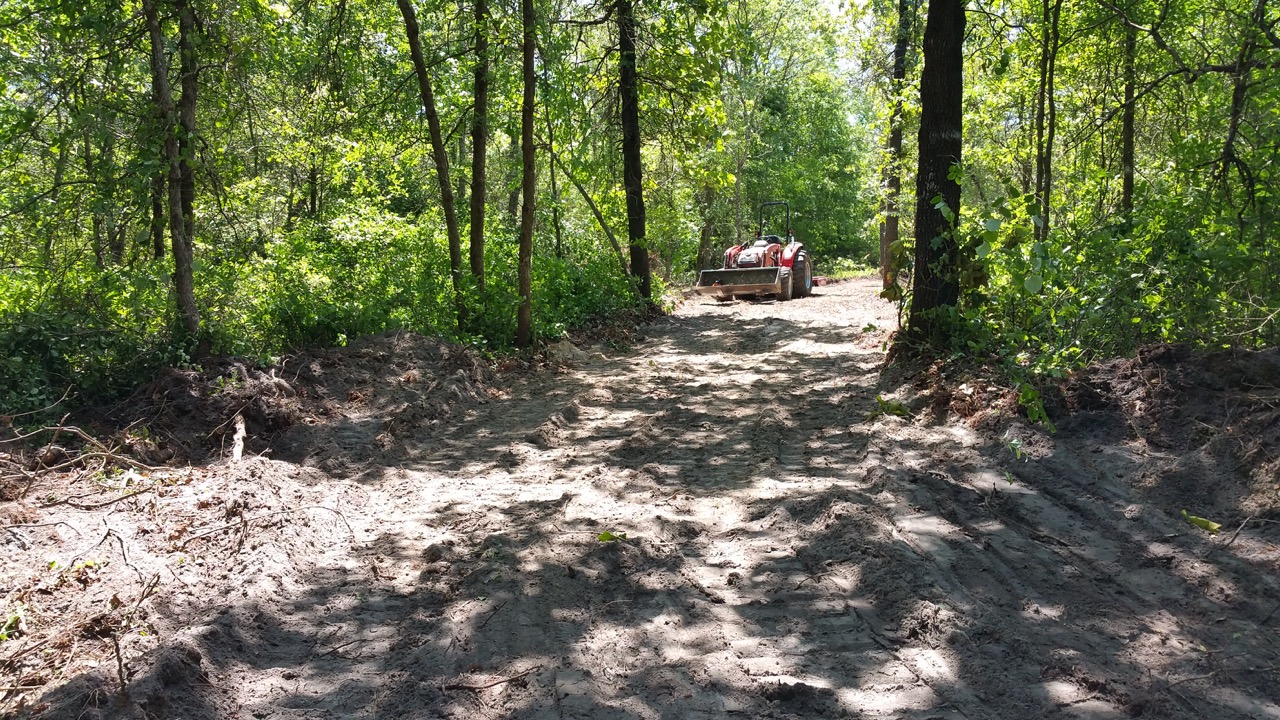

Well - they started to clear the road today. They made it down to the creek crossing. The road clearing is approx 12' wide, which actually seems a little narrow when driving my truck through. It looks like I was able to secure a third concrete culvert - so we will start with 24' width at the creek ]before fill. The angle of the road is a little steeper than I had originally thought it would be. I downloaded an app in my phone that is supposed to tell you the slope of a road. Mine varies from 12 - 20%, but increases to about 30% when you get to the creek crossing. My guess is that this will be slightly decreased once we bring some fill in for the culvert. The soil is pretty loose sand, which makes me think I'm going to get stuck pretty easily in the truck.
Once the area is reasonably level can I just start putting down crusher run? Would you recommend that we start with geo-tex fabric first?
Here are some pictures - please provide any feedback that might help us out....
Justin

Wow, that does look sandy! One section of my property is like that (great for the septic field) and is basically held together with pine straw and a thin layer of topsoil. Have to be very careful disturbing it, otherwise it will wash out easily.
If the area is all sandy like that, you will need something between the crusher run and the sand. If money was not an object, I'd want geotextile fabric, then a layer of #3 gravel, then crusher run. If budget is constrained, I'd have a hard time deciding whether the fabric or the layer of #3 was more important. I am thinking the #3, since it will give a base that bears weight, whereas the fabric will not. Really, if you can do fabric, #3, and then crusher run, that would be the best.
Good luck!

I don't care how much stone/crush run/fabric you pour on that roadway, it's still a trench. You need drainage. That is going to require more width to crown it or material hauled in.
Now you see what I mean?? I'm talking "Missouri" conditions. You aren't in Missouri. So unless you can find a member on here that lives down the road from you, our advice is worthless.
Again, if you don't trust the guy, you hired the wrong person. :)
   / Culvert Question #30
Crusher run, 304's, 411's, 3/4 minus etc is all top coat stuff. (or middle coat). But it dont make a very good base unless you have some real solid and dry clay that stays that way. Around here, we us #2's for base, then the 304's for a top coat to lock it all in. And if you dont like the dust content of the top layer, add to that a thin layer of 8's or 57's, whatever your preference
