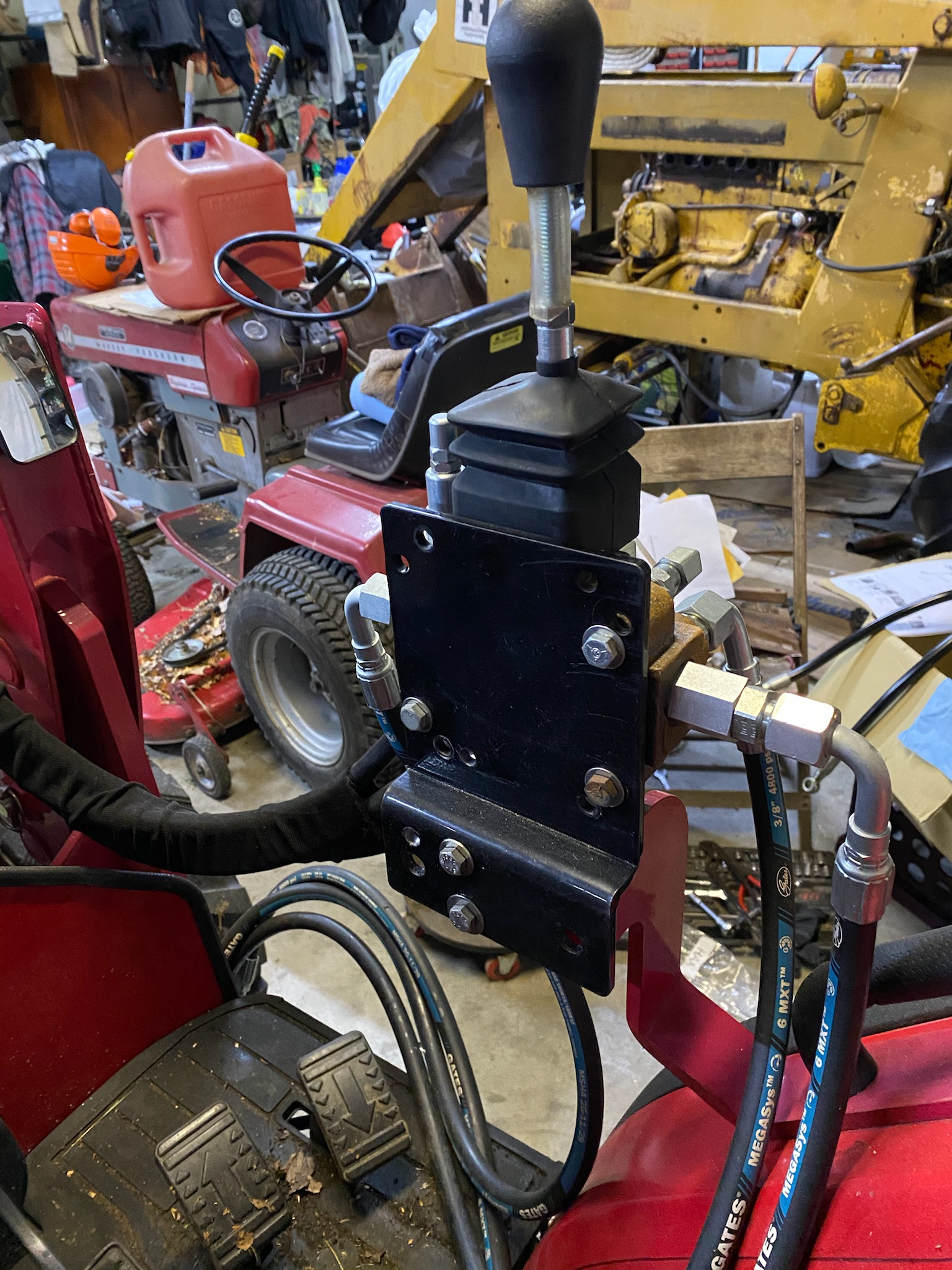

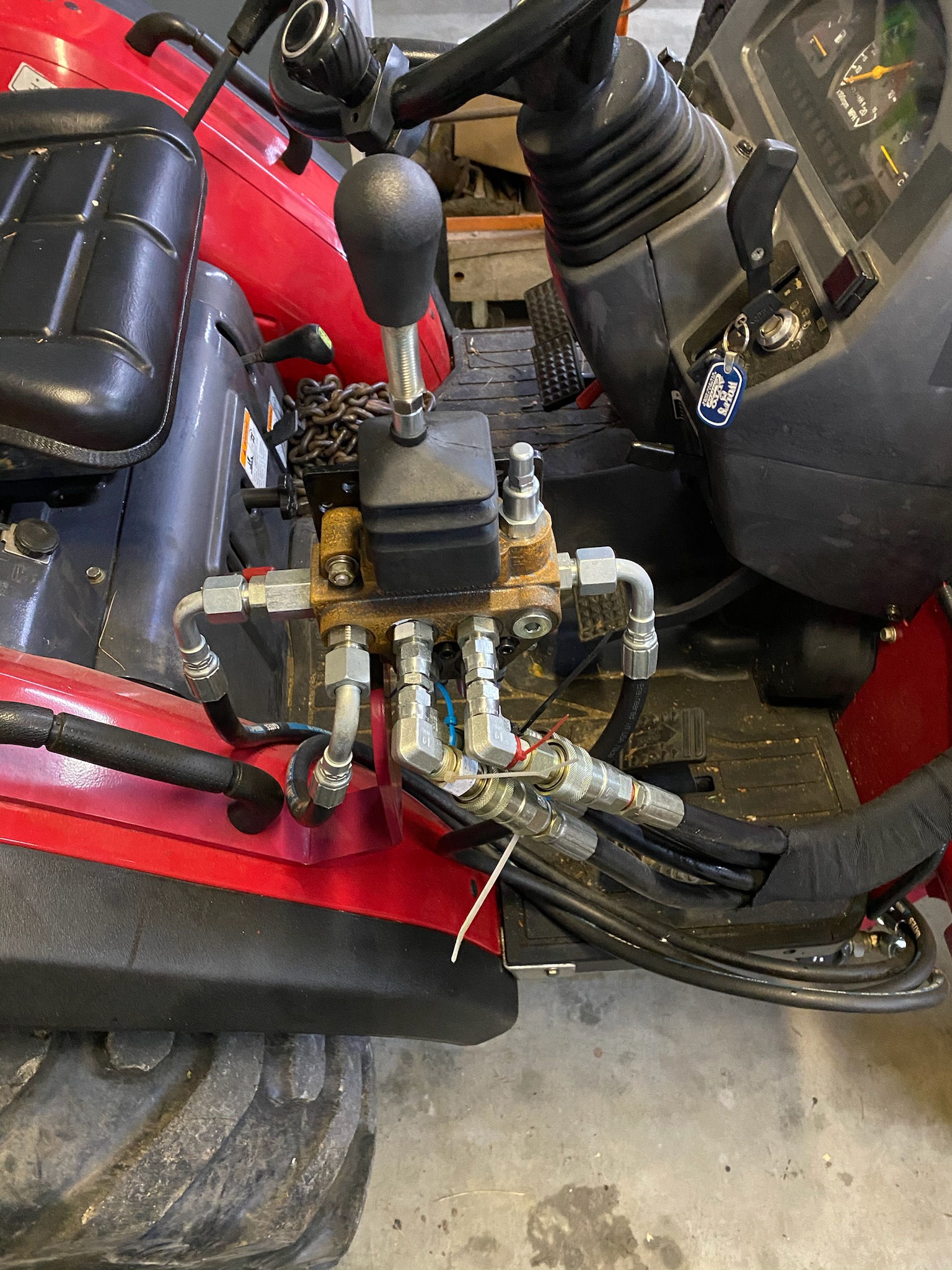

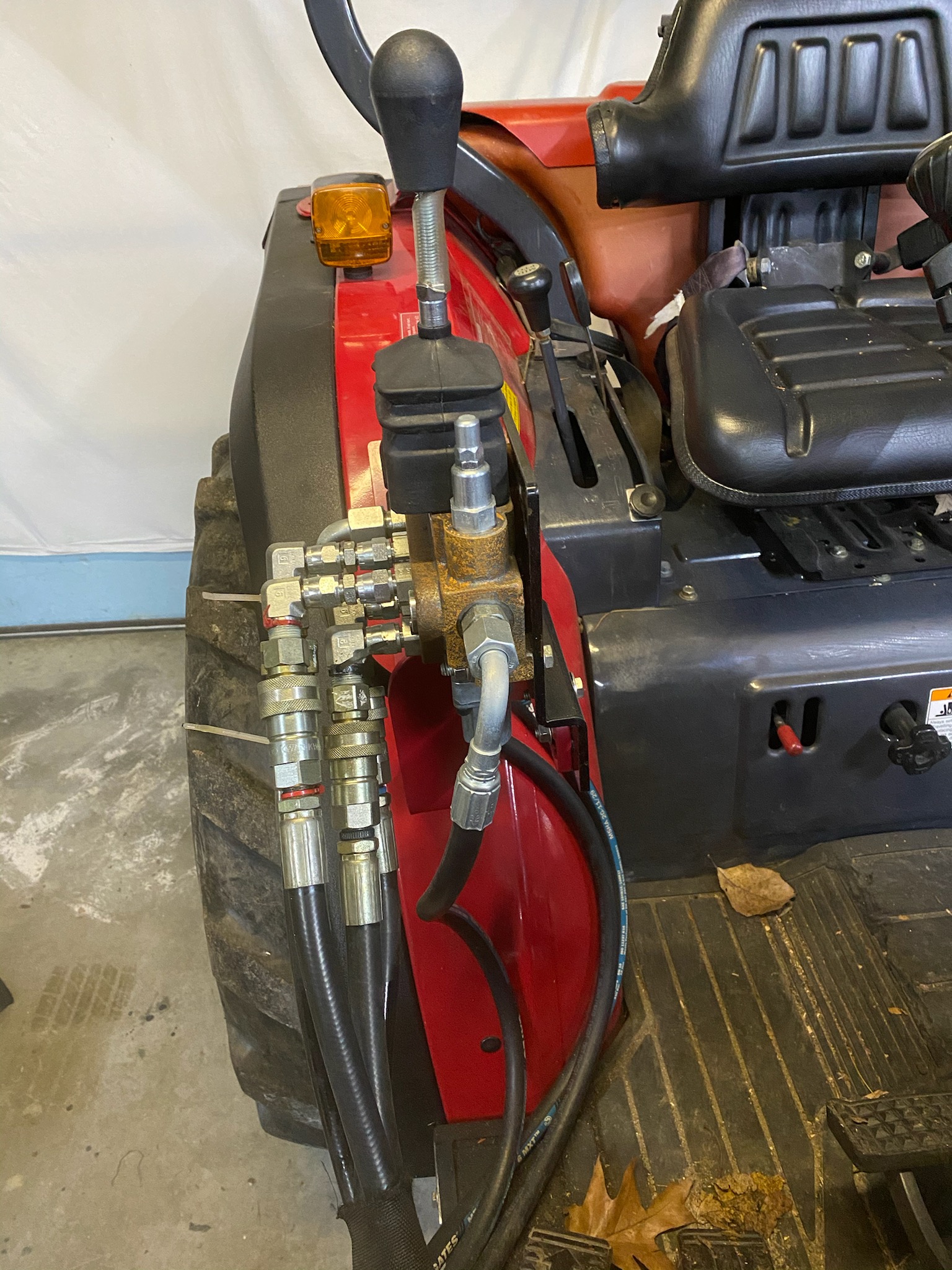

No more jerky/stiff and sometimes limp bucket... Next, I'll extend the loader lines in able to locate the joystick closer and lower to the seat.
