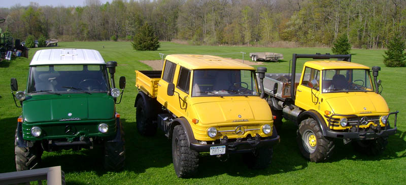

Love those Unimogs. My friend's family has a restored one. After my friend and I had some fun with our new (used) tractor at my house, we were in such a gearhead mode that we had to go back over to his house and drive the Unimog around the pasture and through the pasture tank. Nothing can stop the Unimog!! :laughing:

Yep, they are alot of fun! here is a photo of the ones I have at the house right now!
