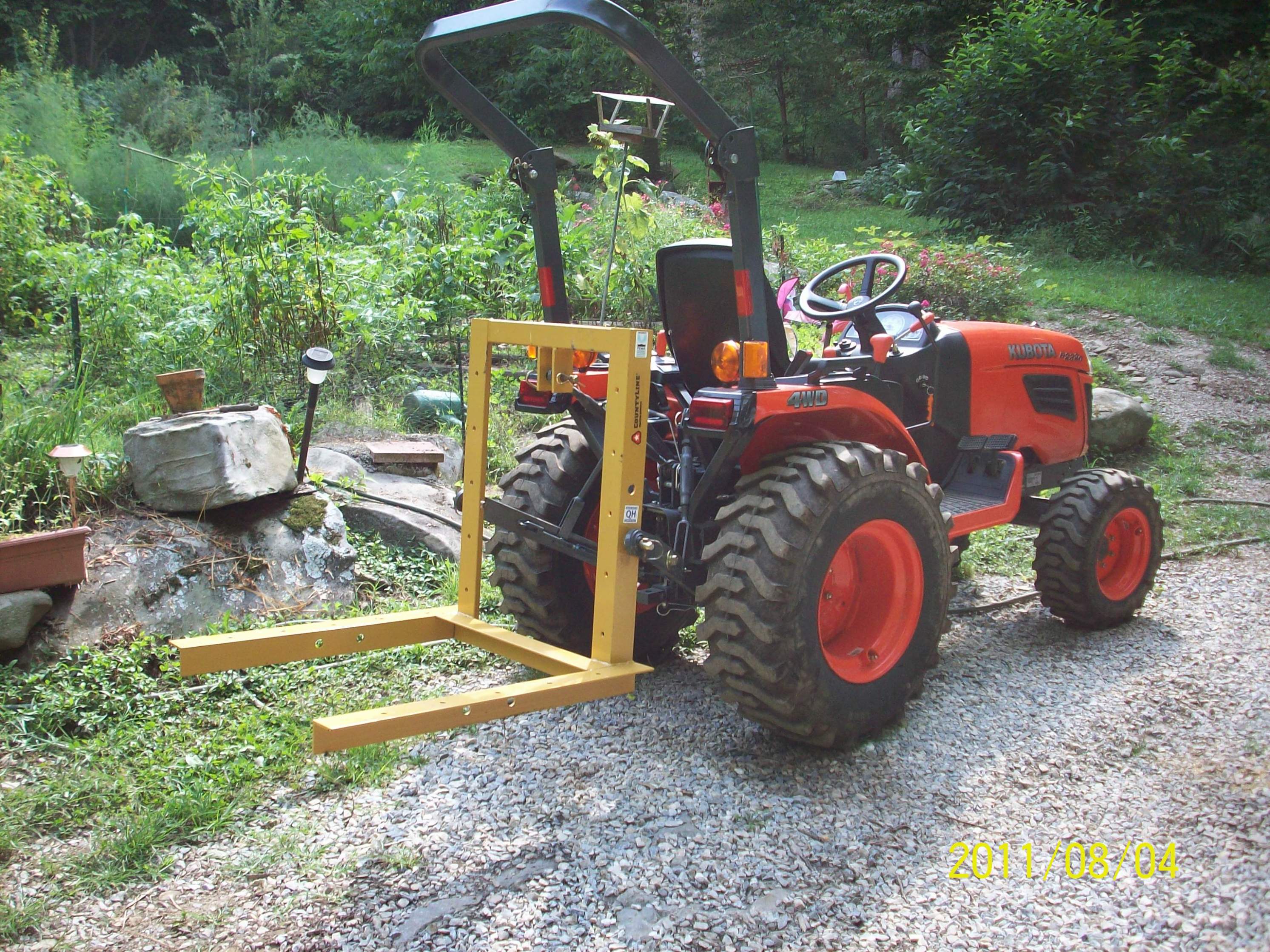

With no extra front weight, about 400-500 lbs will probably pick the front end up (or at least make it very light), assuming the hill is pretty steep. I can say from personal experience that is true on a 21hp JD 750 anyway. One time I tried to drive up a rather steep hill with the 483lb 4ft bushhog raised up. The front end started coming off the ground, learned very quickly to never do that again!

Even with 140 pounds on the front bumper I can easily lift the front wheels off the ground with a half load of rocks or a full load of wet compost. Sometimes I back up the hill when I have a full load.

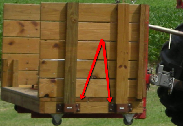

Anyone know where I can buy these--↓---or what they are called--so I know how to ask bout them.
/ custom carry all #13
I saw some at the local Tractor Supply yesterday for $5.00 each. Haven't bought any yet since I'm still designing my Carryall. Trailer builder/supply stores should have them also. I suppose they are called "stake pocket brackets"................. Mike

Well here it is---not really finished yet as I need to test it out first
This will give ya a idea how steep my roads are
So I went down the road----loaded some gravel----little less than 1/2 full---& kept the load close to the 3 point hitch---the front end was very loose and I decieded to take some of before I went up the last hill.
So I need some weights on the front now-----don't know how much 150# is gonna help----guess I will find that out soon as I add some weights.:D

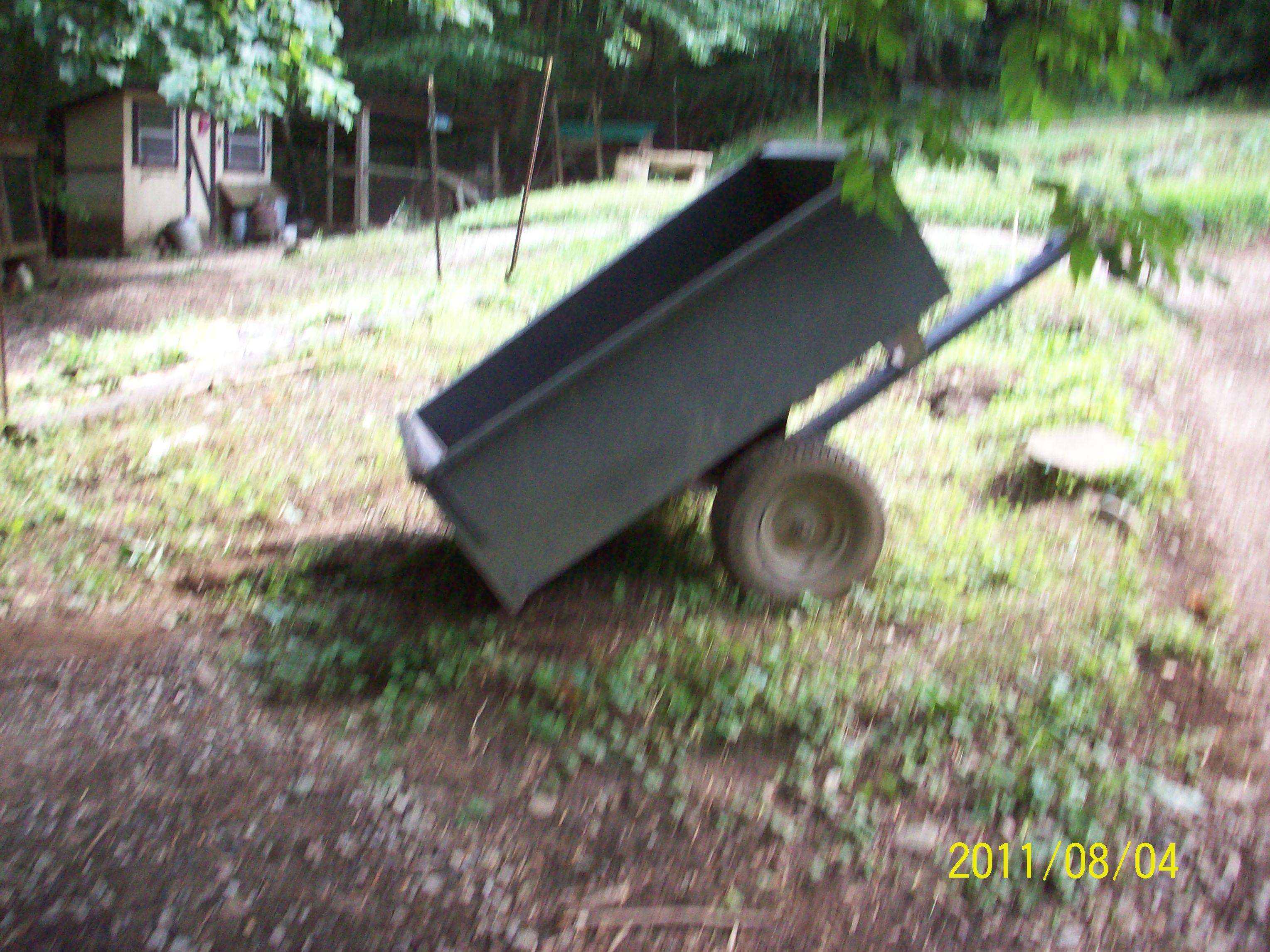

Well I got one-- ($99)--View attachment 223949---Yup Wroorster---just as I thought----I will just have to do some testing.
I do need some front weights Kebo :D
Has anyone made some sort of low sided box for this carry all?????( preferly with wood)
I am thinkin bout mounting this old trailer on to it----but really don't like the idea :(
I've been thinking of the carryall and mounting a trailer like you have on it- without the wheels. I figured two 45 degree 2x4's on the carry all with brackets for the trailer axle. Take the tongue off the trailer and mount some stops for the trailer to sit on on the verticals of the carryall. Use a pin for the release. Tip the carryall and you have a gravity dump body.
I've got a FEL on the tractor. I'm putting a snow blade on the bucket. But I need something to carry and dump the horse manure when I clean the barn during the winter time.
