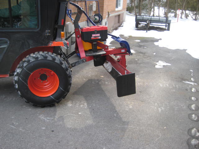

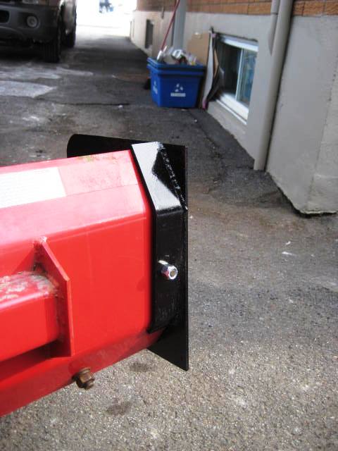

I was getting frustrated by the snow spilling past the blade all the time so I measured and made templates for the rear blade contour. I then transfered this to a sheet of 3/8 steel plate and cut out.

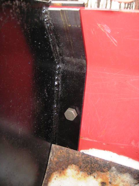

I then took a piece of 2" 3/8 thick flat bar and bent to the countour of the blade (2 per side)
Welded these on with my trusty Lincoln SP175 MIG and painted black.

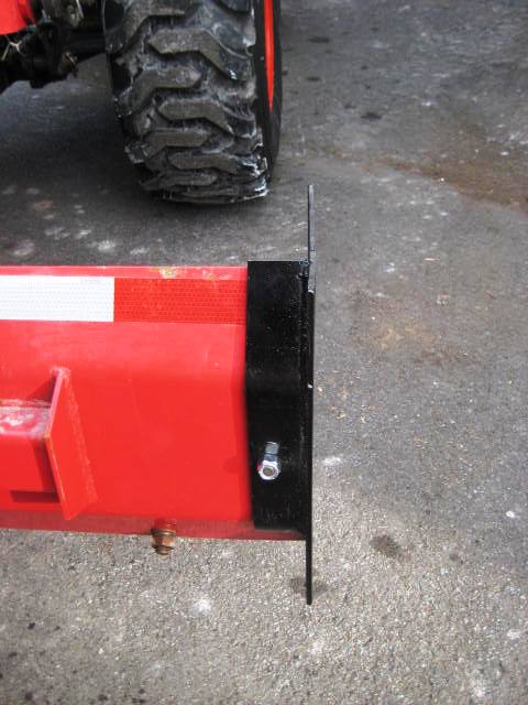

I adjusted the rear blade angle with the top link and banged these on (tight fit)
I then drilled 1 hole with a 1/2 inch bit and installed a bolt and nut.
The following pics and video link are the result.

Thanks to all for the kind words.
The old b2920 with Sims cab gets'er done nicely. T-shirt weather inside the cab!
Just need a real snowfall now to try those new sides out.
I do realize that the snow will still spill over but it should allow me to pull it far enough from garages and cars so that I can back over it and then blow it forward with the blower

The reason I only made them about 12 inches is that the longer they are the more chance of diggin a groove into somebodies nice new ashpalt driveway. Since I do quite a few drives in the winter I wanted to stay on the conservative side.
Also I only need the extra capacity to pull snow away from a building or car so that I can back up over it and blow it forward.
Any longer and the 3/8 steel plate would have needed a brace (again wanted to avoid)
Also with wet sticky snow and the b2920 not being overly heavy I was a little concerned about traction (didn't want to go to chains because of the paved driveways again)
The b series fits my needs nicely and gets in and around objects like cars without being too cumbersome and without giving up too many comforts and hp.
This modification would work fine for top soil/sand/gravel but probably would not use for anything heavier like grading since I would not want to bend or warp the blade itself.

OK after a few minor snowfalls and about 1.5 months since my last post on this subject I have to report a few minor glitches;
1. Side plates do not dig in to asphalt when going forwards but when I turn the blade around and push snow it does dig in and leave a nice groove in the drive.
Fix; 1. Either ease up on the turnbuckle to raise the blade or
2. Make some skid shoes like somebody has suggested?
Just don't know if I will still experience the same problem with the skid shoe that I do now just on a wider scale?
