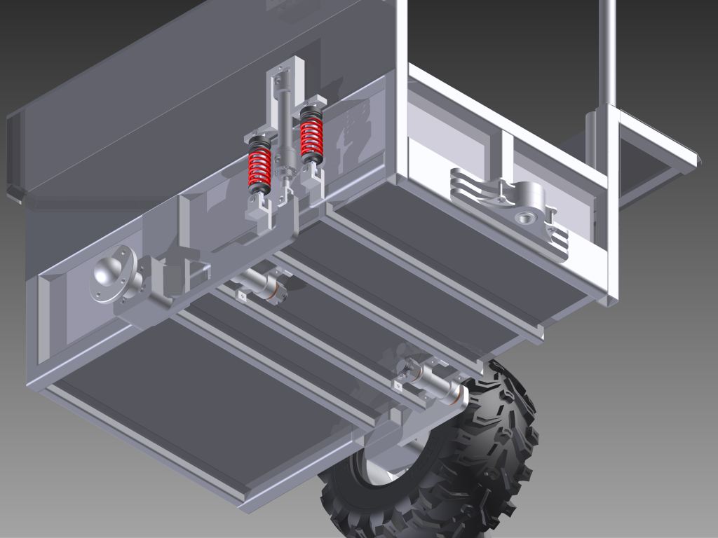

I've come up with an idea for a suspension system, for my machine's front-end. It's a little crude yet, but I'm looking for little bit of feedback before I refine it more. I've attached a few photos, and also did a video animation of how it works. Let me know what you think.
I see 4 possible issues:
1. When you hit a bump, will the arm drop enough to bottom out? How about when you have it "kneeling" will it hit the ground?
2. Will the shock/lift assembly bend when you hit rough terrain?
3. How big are the rods on your lift cylinders? Will they bend at full extension?
4. Could you run the hydraulic lines in a different fashion? If you snag the lower line for the lift cylinder on a branch and break it off, you will be stuck.

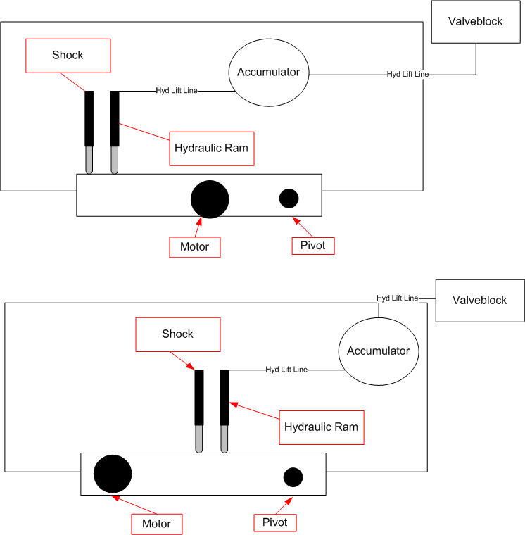

IMO, you would have a simpler design with the ram and the shock(s) on the same side of the pivot as the tire.
Perhaps something like this:

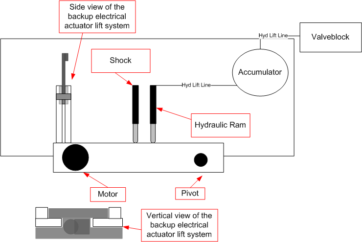

If you are going to be very far off of the pavement by yourself, I might also add a backup electric actuator on each side to lift the front up in case you blow a line somewhere. Below is one way that it could be done. No suspension, but it would get you back without needing to wait for help:

here are a few updated photos of where things are at now. I'm looking at going with an air ride suspension that also will work as a kneeling system. I spoke with Ride Tech and they told me that their system would work perfectly for this. So we are looking at using 7000 series shock absorber with a 6.9 inch stroke. Air ride is a little pricey, but it will kill two birds with one stone. And from everything I've researched it's very reliable and should last me a long time. Let me know what you think of this.

/ Custom UTV #49
Can you post a bottom view? Curious how the swing arms are attached to chassis.
/ Custom UTV
#50
right now, I just have them attached to the back. I'm not sure that's going to be my final design yet.

/ Custom UTV #52
Thanks for the pic. I see you have a pivot at the rear. What support the wheels from moving outward? Is there another link I'm missing somewhere? :confused:
/ Custom UTV
#53
I haven't come up with the design yet they keep the wheels from going in and out. But I am open for suggestions.
/ Custom UTV #54

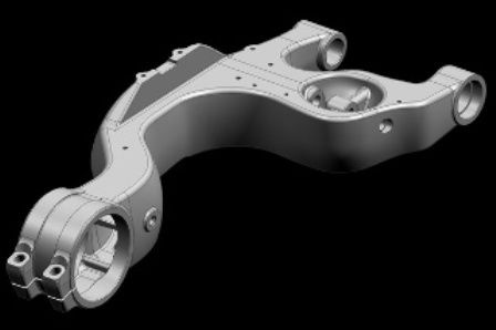

I've attached a sketch I found on Google of what I would use. This a swing arm concept from a motorcycle. The key is how it attaches to securely support the wheels. You would not use the drive shaft system.
With this design you could run a frame member from one side of the vehicle to other to secure the swing arms. This would make a very rugged suspension. Attaching the suspension just to the side will not be strong enough.
Of course just my opinions! :thumbsup:

That is really cool, if I only had their budget. It appears that the Mini Crusher doesn't use any kind of swing arm. It just puts a suspension really tight to the tire. The air suspension that I'm going to use will require close to 5 inches of space. So it doesn't really give me much choice but to put the shock either in front or behind the wheel. The machine is getting wider than what I like already. If I move the wheels out another 4 inches, it will be too wide.
I'm just trying to get my head around that swing arm system. How I could attached to what I've got. I'm not quite sure what you mean when you say that I could go from one side to the other. Where would you suggest I put it.

just use the cylinder, and put next to the cylinder an accumulator,
If you let fluid out of the cylinder circuit you lower, if you add you raise and the accumulator is charged such that it will act as a spring,
And all the accumulator need to be is a Hydraulic type cylinder, with a moving piston to separate the nitrogen charge from the fluid, if one wanted to one could add a spring in the accumulator and not depend on the nitrogen charge entirely,
you would need a flow divider or separate circuits on each wheel or you my have balance issues,
but with the system one could level the unit for the wheel chair rider, if the ground is sloped as well, and if separate circuits it could be leveled side to side some what like a hill side combine is,
the other Idea is just a put a leaf type spring on the arm for the spring and use the cylinder to raise and lower,

would that not affect my ground clearance, I want to keep the middle as open as possible. One thing I have looked at is a single-sided swing arm that are used on motorcycles. I could build something like that.
