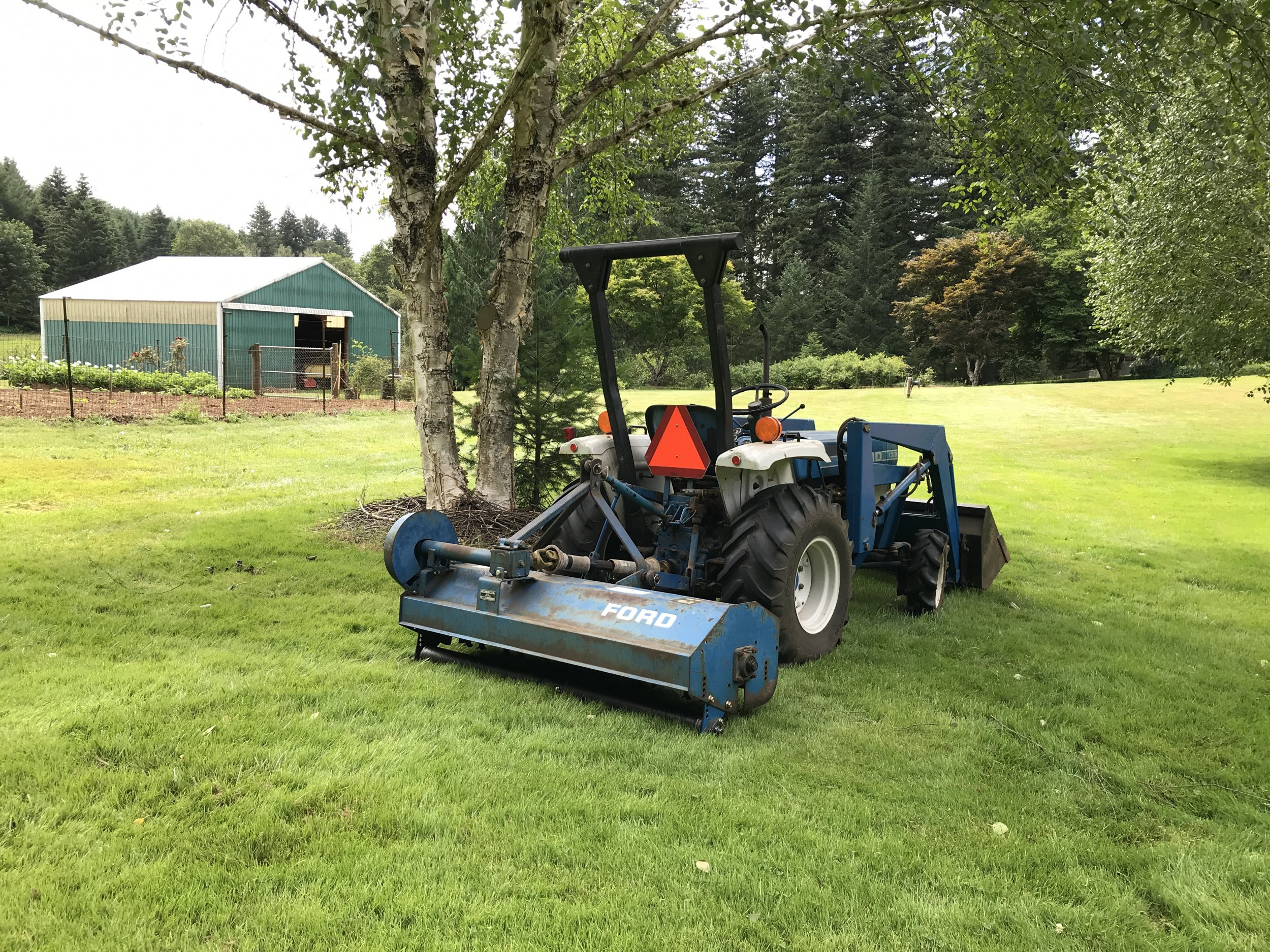

Looks like your NH TC18 has the same engine as my 1986 Ford 1310 (it's a Shibaura 1.0L 3 cylinder Diesel with about 19 HP or so)!
I run a 5' Ford 917L which was meant to use "side slicer" or Y-flails.
It uses little less power than my 48" JD 413 brush hog and leaves a nicer looking field after cutting.
I think most 60" flail mowers with side slicer flails would be a good fit with your TC18.

Looks real nice. You don’t even have turf tires and the grass looks smooth as a football field. Is that the offset cutter?
Yessir. Hydraulic, both ways. I've always run R1 tires and never had an issue. When it's really wet they will leave imprints but they grow over. One thing about R1s is that they don't mash the grass down like turfs and R4s do. This mower is like a vacuum. I absolutely love it. I've always cut this with a 20' Frontier FM but since I got this I've been using it. Takes longer but who cares.
