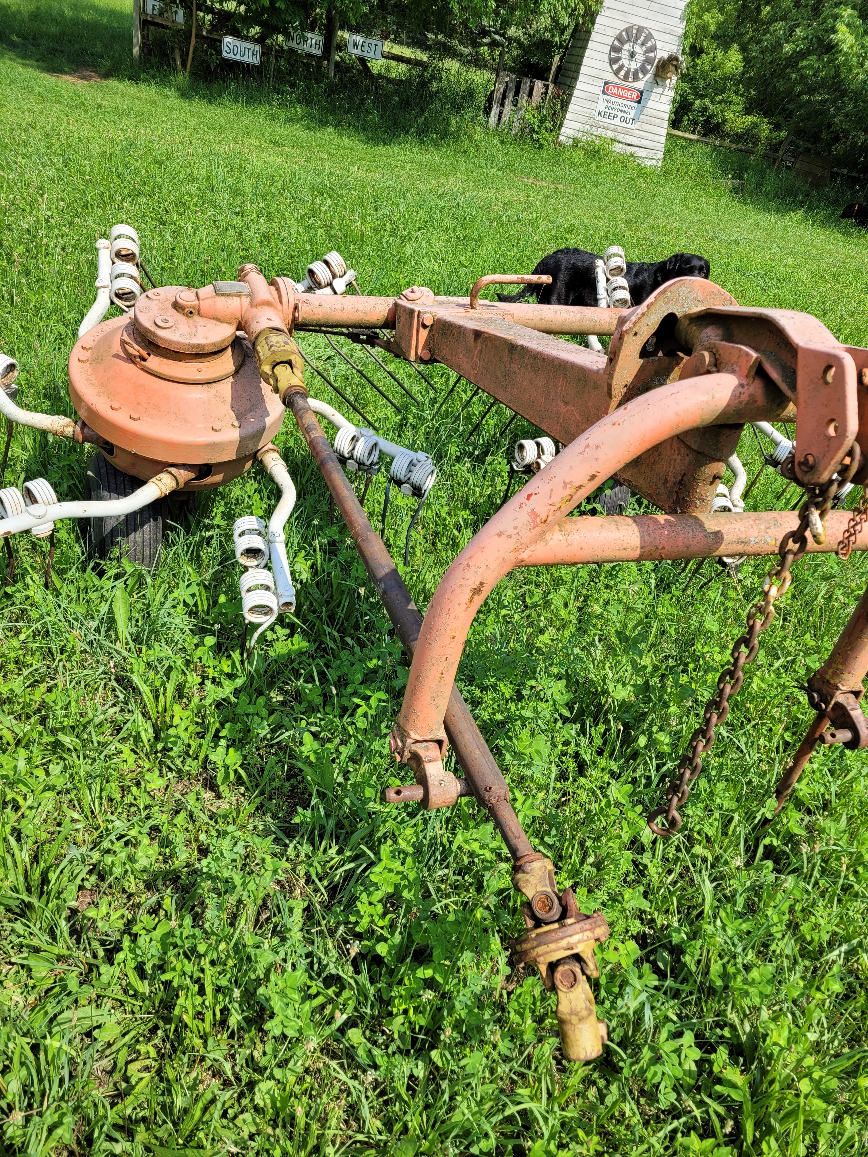

BTW: Here is an example of a non-zero phased drive shaft found in many hay rakes where the axle stub is NOT aligned with the gearbox stub. An angle is installed on the intermediate drive shaft to compensate for the mis-aligned (non-colinear) mechanism. Other examples of non-zero phased shafts are in the steering system of FWD cars. This is needed because the steering column does not line up with the pinion of the steering gear. This condition exists for crashworthiness reasons so a frontal impact does not punch the driver with the steering wheel during a collision.

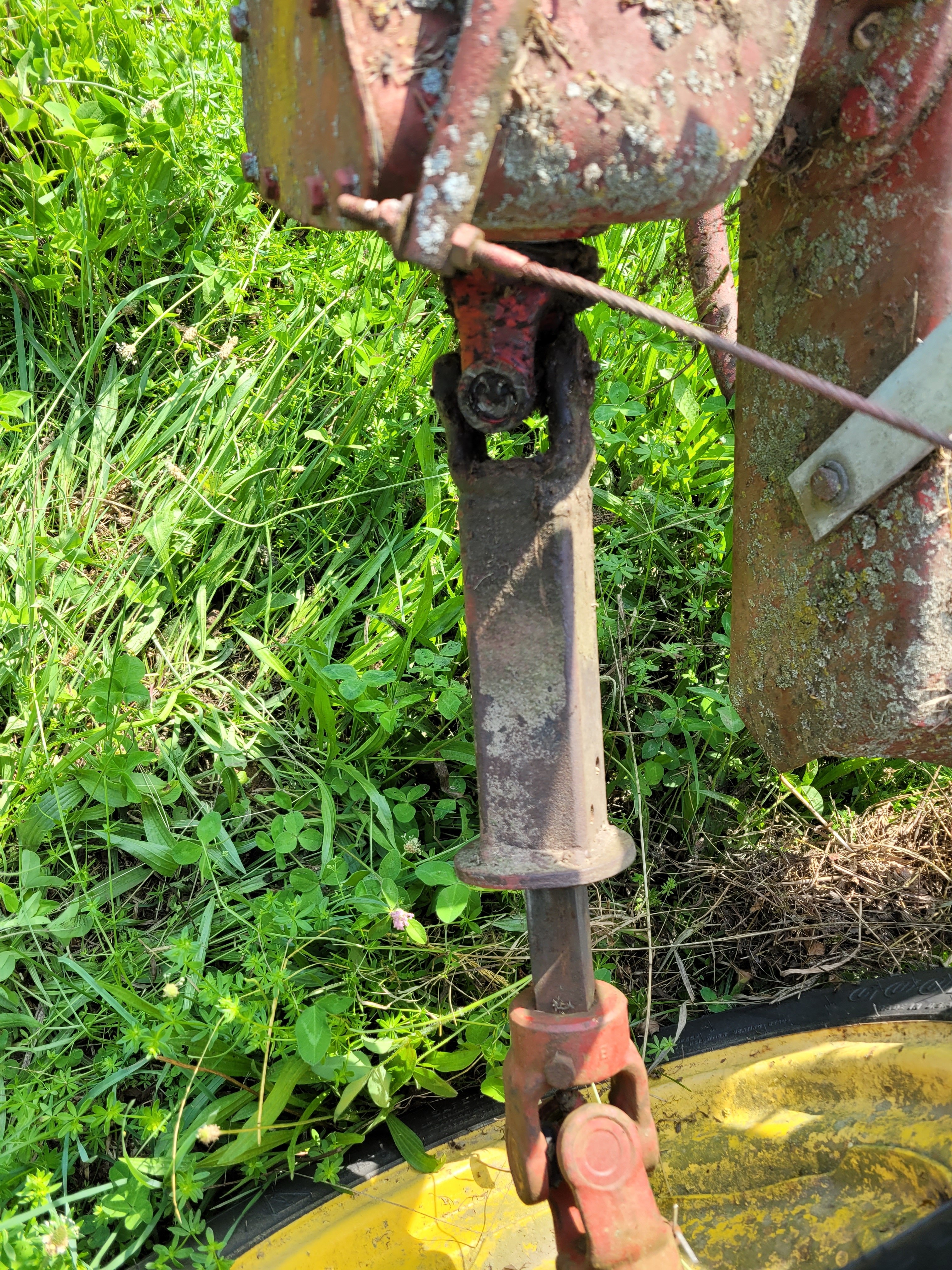

The drawbar length sets the position of the hitch pin relative to the tractor's pto shaft's u-joint coupling on a driven shaft. This should be the same distance as the implement's hitch pin location relative to it's first u-joint coupling distance. Implements I'm familiar with seldom have a movable pto shaft bearing mount, so the drawbar is the only other way to get the correct geometry This is most important for powered/trailered implements which get large tow angles, (like a mower, baler, chopper, etc.) Even a pto generator where you would want good sine wave voltage & current flow. This means top and side view alignment as well. There are also PTO stub shaft extensions which might also help get the correct driveshaft geometry.
All of this configuration stuff also applies to front PTO applications (like a broom or snow blower). In the case of a blower, lifting the blower up and down also manipulates the driveshaft geometry, so that most of these powered front implements come with a c.v. jointed drive shaft.
BTW: In the O.P.'s description, the damage to the mower's u-joint (blown out yoke bearing and end cap) was probably the direct result of the shaft's mis-configuration. That might have worked for a tiller which is fixed, doesn't have a tow angle, and doesn't have a load when raised up, but not his trailered mower.

Here's another example of an incorrect installation on a Kuhn combo tedder / rake. The photo shows the driveshaft's C.V. joint now at the tractor end. The shaft has 6 spline 540 type couplings at both ends, so an unsuspecting user could install it backwards (C.V. joint at the implement gearbox). OK in tedder mode, but vibrates more than a pickle in a women's prison when raking.

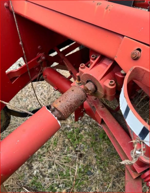

The second photo shows a baler in a local MarketPlace sale with a gearbox shaft that appears to have been broken more than once. Yep, the guy used a standard shaft hooked up to a 4020 which easily won the contest.

A pto shaft with a plain u-joint on each end works best if the angles of each joint is equal. So, with the hitch pin near the center of the pto shaft, as you turn, the u-joints will be at similar angles.

If your mower was setup to run on the 1000 rpm input, it will not get to the proper rpm on the 540 RPM PTO.
On your tractor when you change the output shaft for the 1000 or 540 pto output it engages a different gear internally. At your tractors rated rpm for pto speed the 1000 rpm shaft will do 1000 rpm, with the 540 shaft installed you will only turn 540 rpm.
I do not believe that you can achieve 1000 rpm out on the 540 shaft.
Also looking at your first post and picture it wouldn't hurt to lower that carrier bearing down a hole or two to get a straighter pto drive line.
