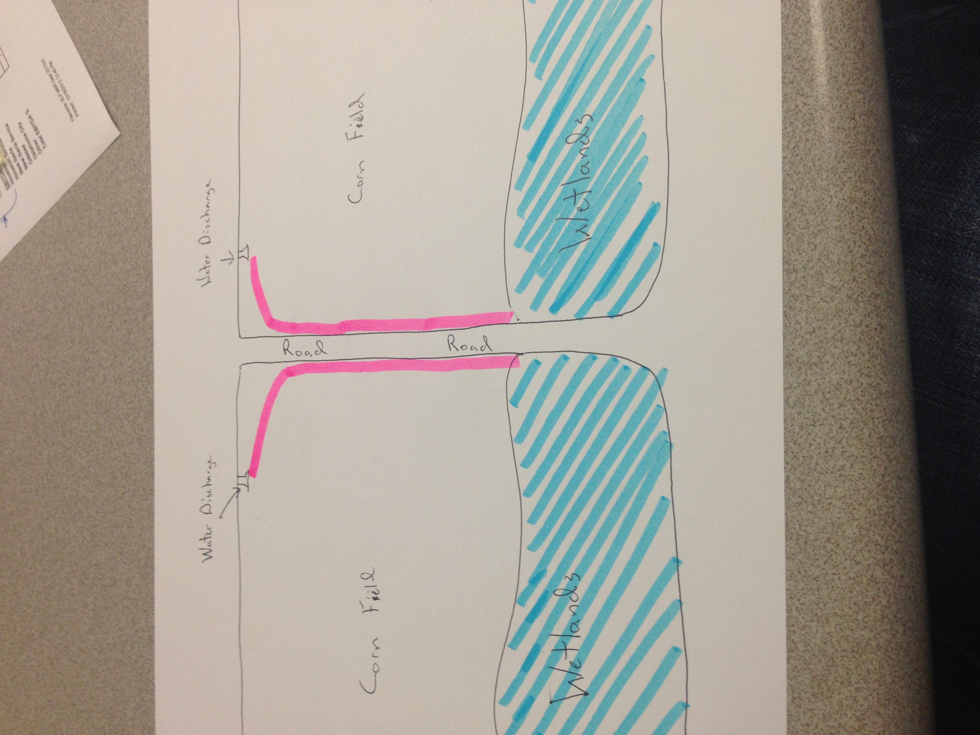

I need to cut a ditch along a road to move water to my wetland units. The wetlands are at the low end of a corn field. The water discharge is at the top end. I want to cut a ditch around the corn field basically so I don't waste water when I try to flood. I have a M7040 with a box blade and a rear blade(non hydraulic). How would you guys suggest I do this? It will need to be about 400-500 yards long. I know it will take a long time but I don't care. Or should I rent a motor grader(maintaner) to do this?

I have a laser. It doesn't need to be that deep. Just enough to keep the water from entering the corn field. There is a road through the middle of the field that is built up about 3 feet. I was planning on using this as one side of the ditch. Then kind of scraping out a ditch along the road to guide the water into the wetlands. Right now when we try to flood the water runs over the entire corn field so we lose a lot to absorption. Plus in the summer I don't want to interfere with the farmer's crop when trying to flood my wetlands. I will try to draw a picture and post it online.
I tried to attach a drawing below. Sorry for the highlighter colors. I am stuck in the office and only had those. The blue is the wetlands I am trying to flood. The pink lines are where I want a ditch. The water discharge pipes are where the water comes out of our underground irrigation pipes.

   / Cutting a ditch #5
The grader with a competent operator would be a good choice!:thumbsup:
If you do it yourself set up a few stakes for grade and use the loader full width for making the trench. Get started on the slope you wish and keep maintaining it.:D

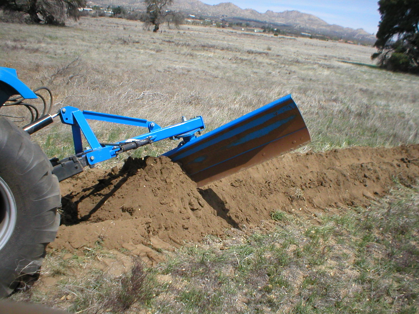

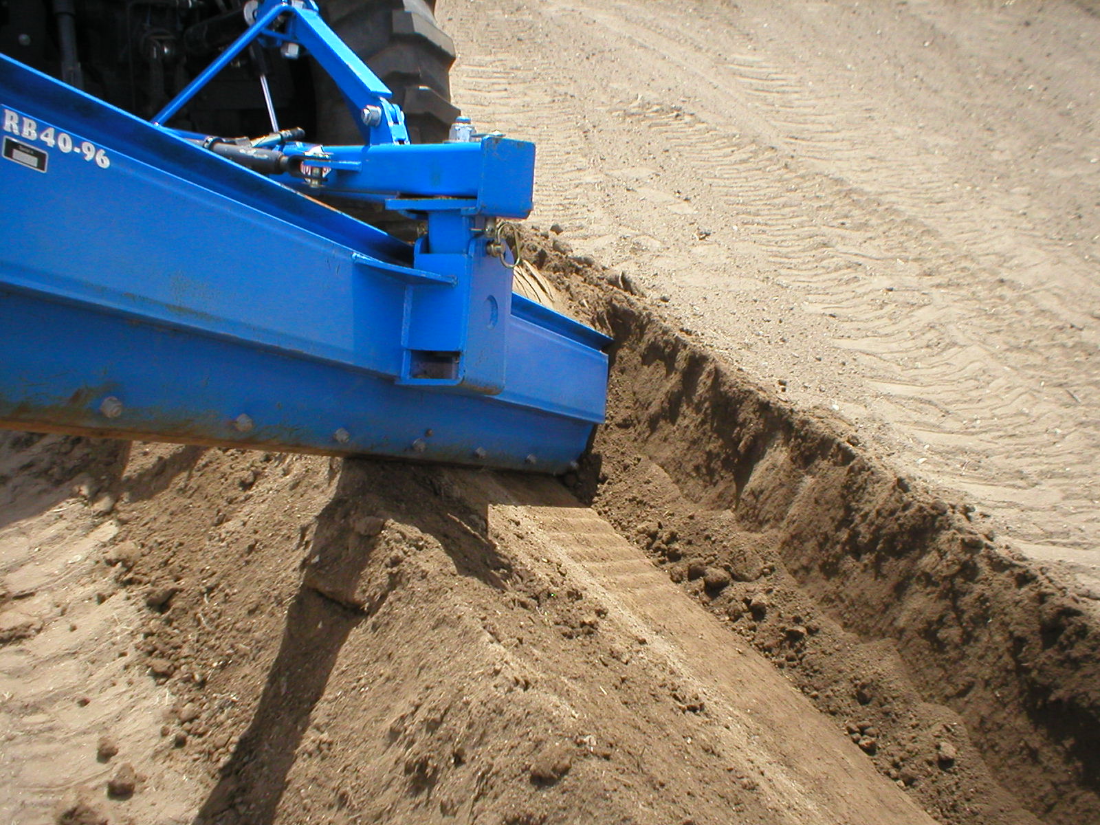

Rear blade in my opinion. Here I dug a trench in a very short amount of time back when all I had to do it with was a manual rear blade. The trench is about 18" deep. ;) :thumbsup:

I created a ditch using the blade like MtnViewRanch, but worked it into a wide swale that was then seeded with grass. The initial ditch part, just like he shows in his pictures, was surprisingly easy. You can continue to make it as deep or as wide as you'd like. Once you get it started you can move quite a bit of soil.
Also, my blade is lighter than his, my soil is heavier, and I don't have Top N Tilt. So, it can be done.

Since you have a back blade, just follow the way Mountainview Ranch did. Since you only want to direct the water so that it doesn't go into the field, you really don't need to V the ditch unless you want to for smooth crossing with equipment. A couple of passes with your 70HP tractor would have the ditch plenty deep. Flatten the blade and smooth the spoils out on the sides. Open your water discharge and check out the flow.
