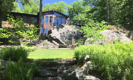

I was able to do about 100 feet of the zigzag path down the slope behind my house with my loader/backhoe. Took a couple of weeks. I decided to rent a mini excavator with blade for a week.
In one day I was able to rough in 10 times as much in steeper sections. This include searching for possible routes around the abundant stone ledge on my property.
Attached photo shows some of the ledge. Photo at least 15 years later. Some parts of trail still only suitable for walking or UTV. Some parts nicer. Much easier to do more work after
easily traveled path was there.

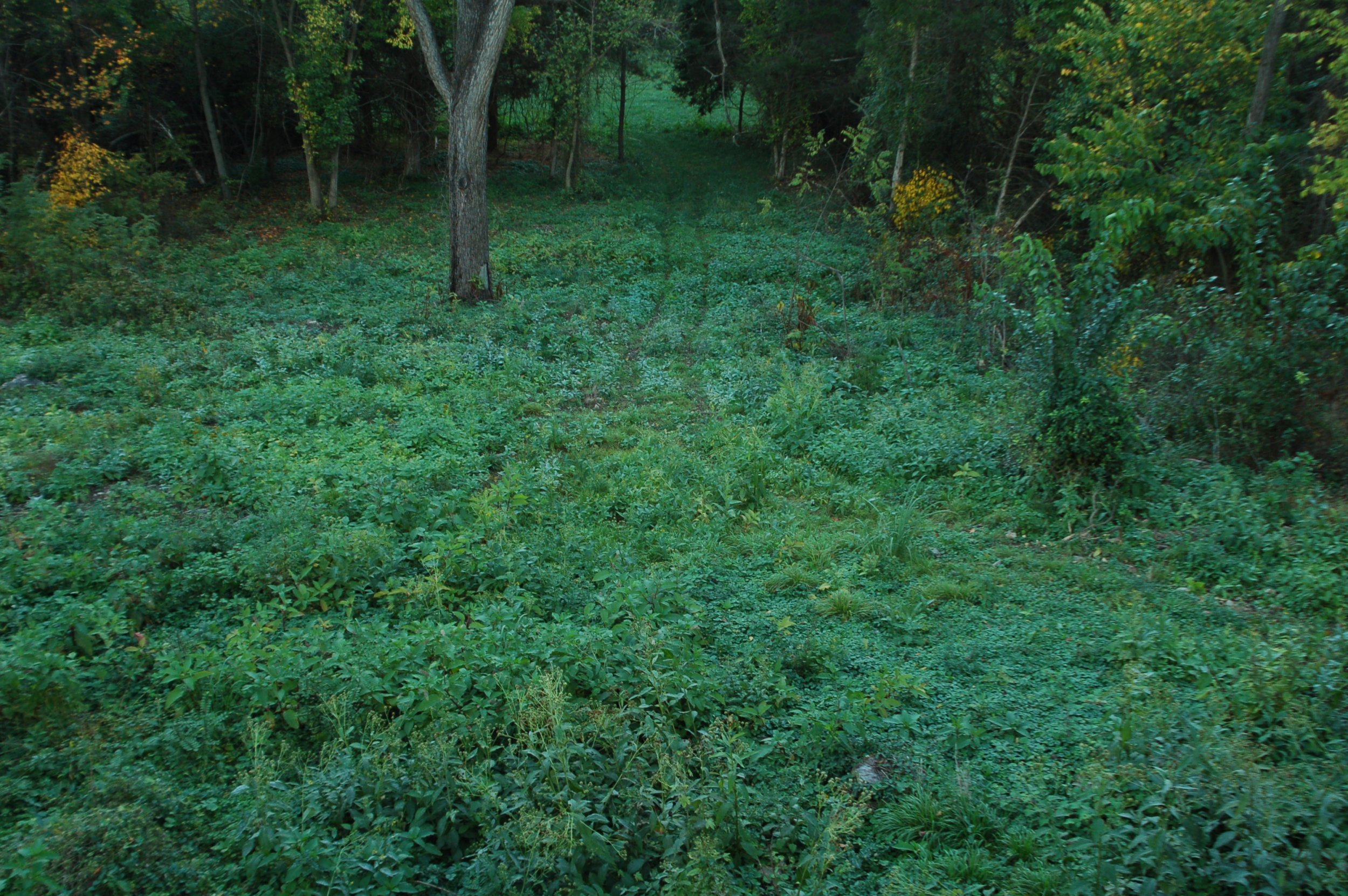

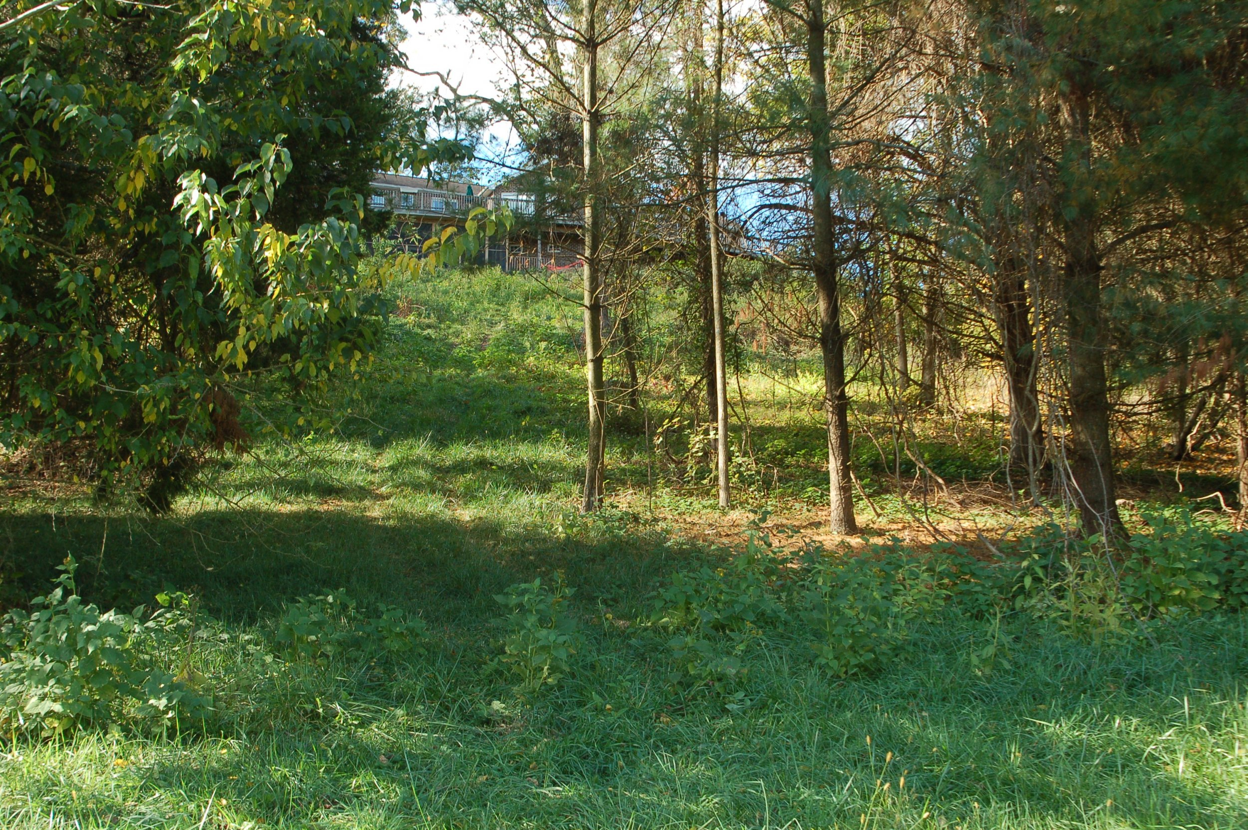

Well, I'm certainly not a pro, and I've used a mini-ex, which is so much faster.
But, if you have time and want to save money, here's what I did with a Kubota B3030, FEL with a tooth bar (the cheapest, best attachment IMO), and a Woods BH80X.
First, the hill. Third picture shows the first trail cut for the first terrace, mostly through shale.
Last one is 40 pallets of 40 block (factory seconds), 90 lbs each, pin together, fill with gravel.

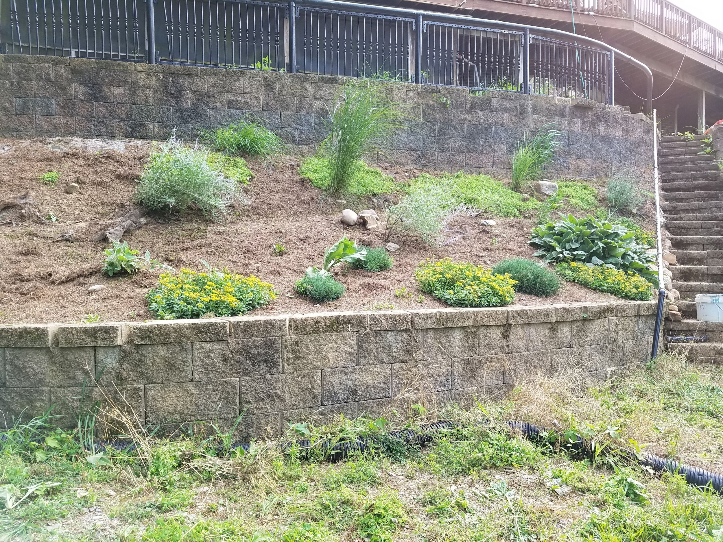

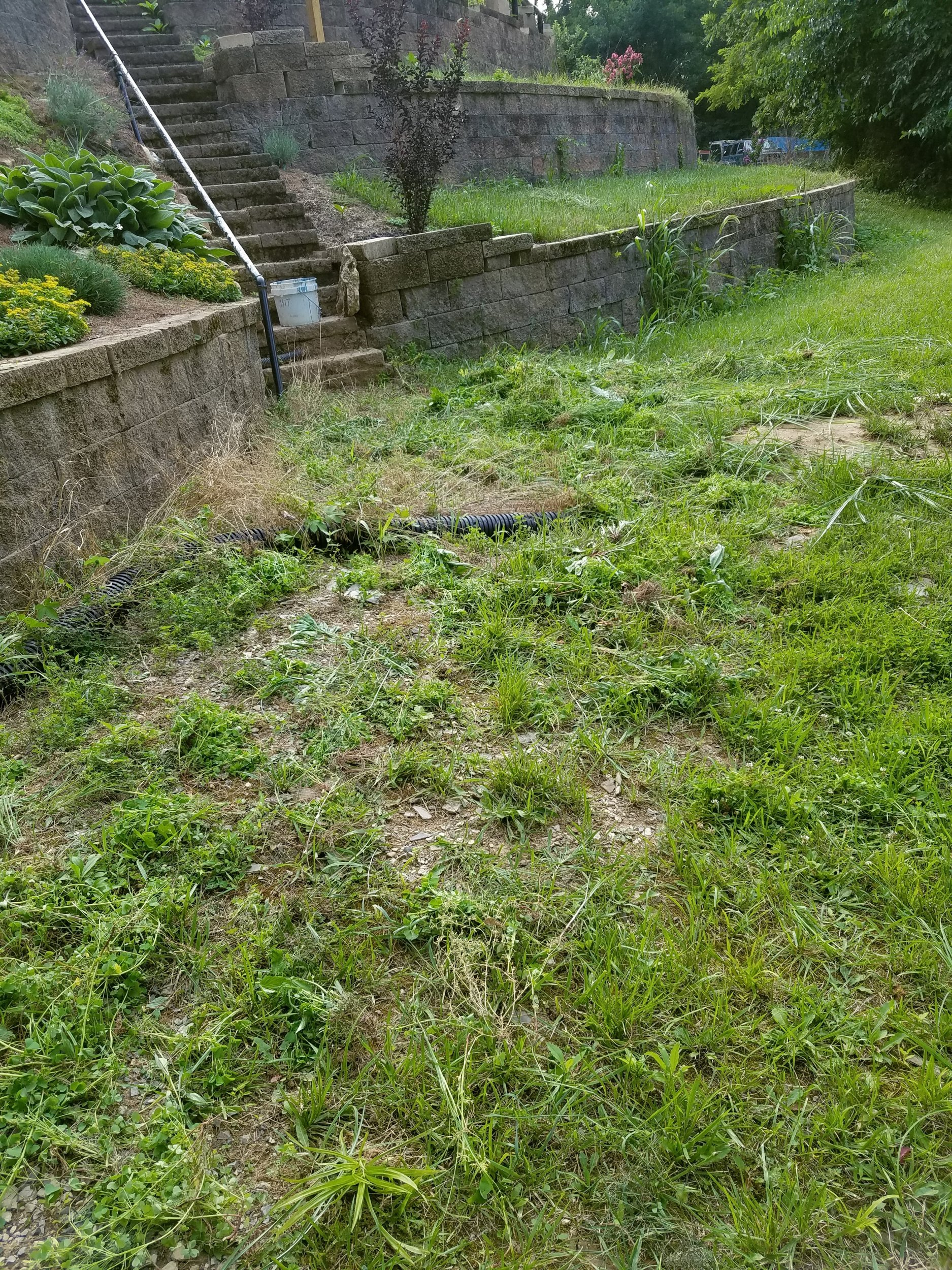

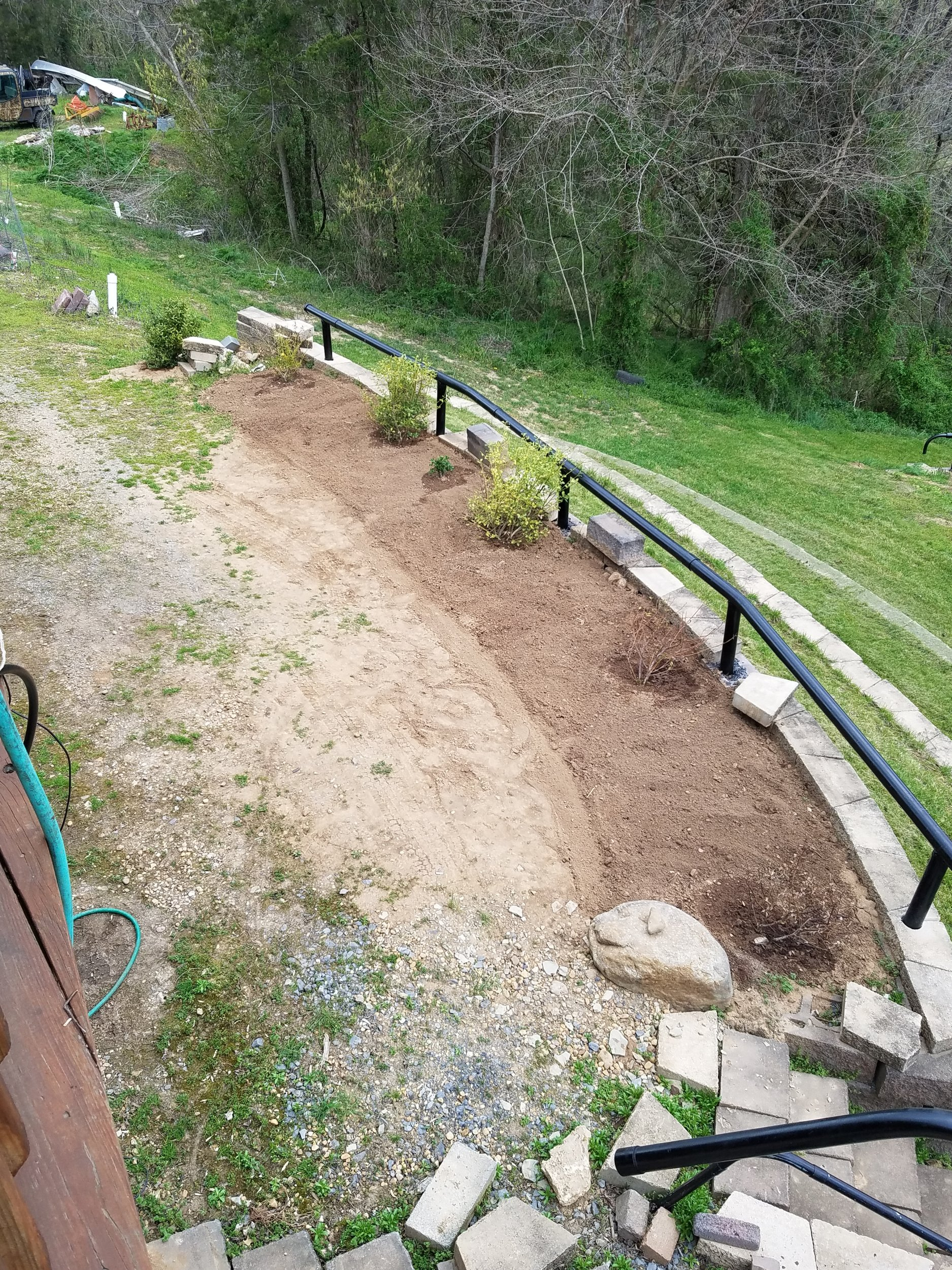

A work in progress, just some of the walls that started as trails.
Not tamed, but better...
